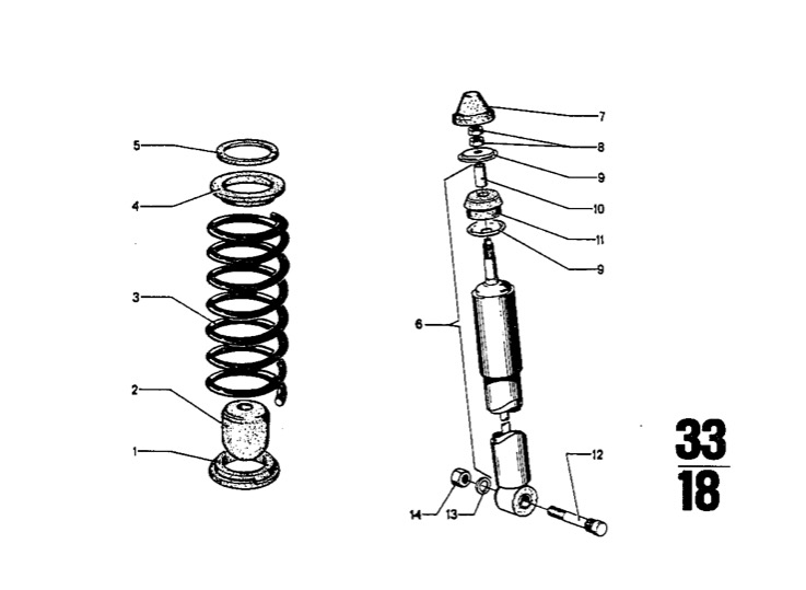

so, what part number are we talking here ?
I think the current part# is: 33523450101
Number 11 in this picture:
I'm also using BMWs original bushing as the Bilsteins rubbers wont fit correctly.

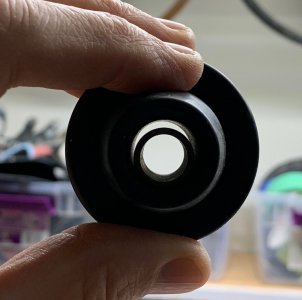

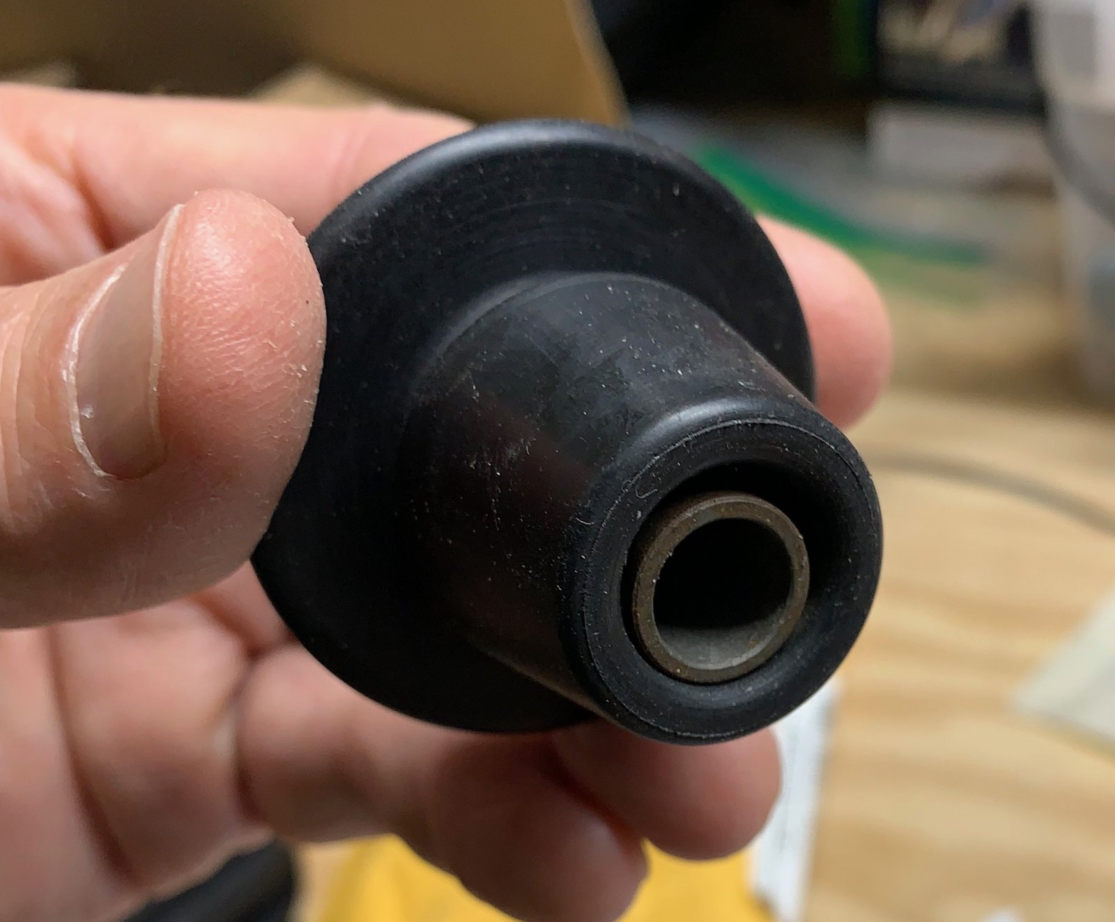

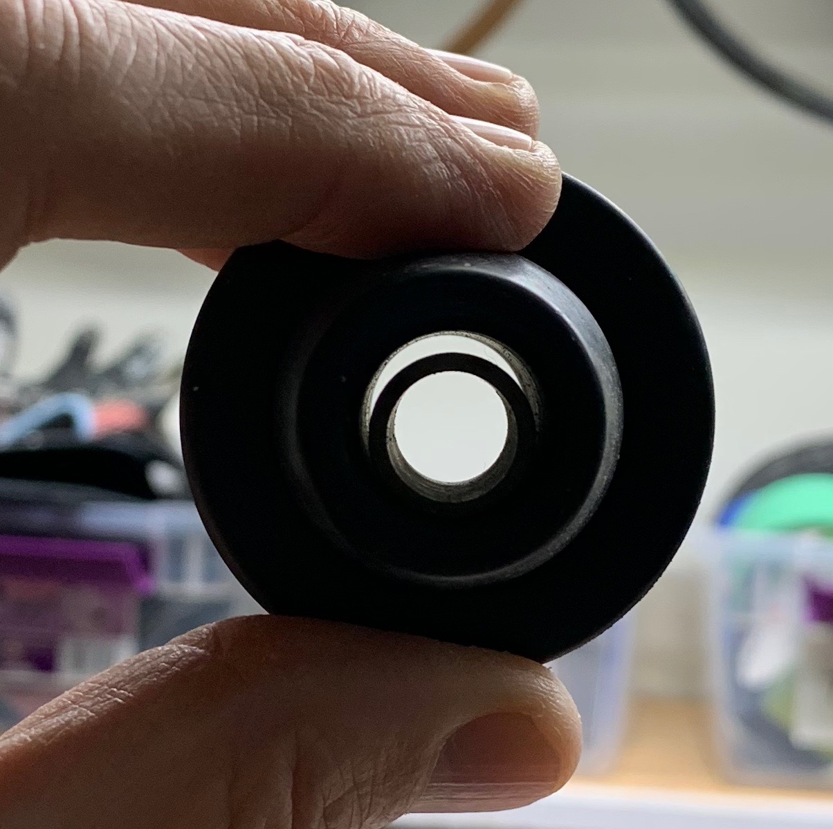

My hatred for these is strong. Many parts sites say 335211118 does not fit E9, is NLA, and/or has been replaced with 33523450101, which some also say doesn’t fit E9, only 2002.
After reviewing the threads & dismissing any difference, I ordered from FCP Euro. Car’s on stands in garage blocking wife, so I pay for quick shipping before she gets back in town. Today, 2 weeks later & FCP failure to respond for days then unable to figure it out when they do, the little rubber devils appear - one 118 & one 101. Look identical in shape & dimension, but 101 has BMW markings & 118 has no markings at all and feels noticeably softer. So, 2 weeks later & half a palm full of $100 rubber, I’m now questioning what I’ve got.
FCP was apologetic & refunded shipping. Problem seemed to be on direct-ship from BMW source in PA. But a hair-pulling experience. I’ll order these before shocks if I have to do this again.

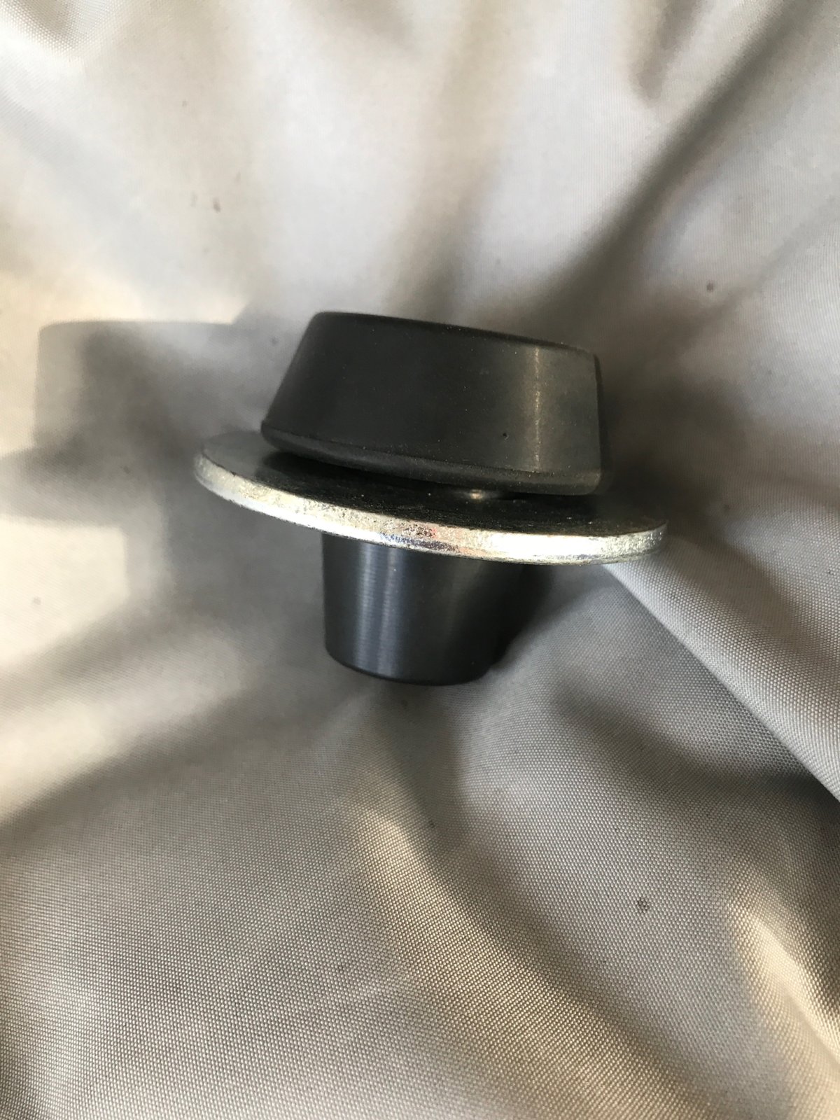

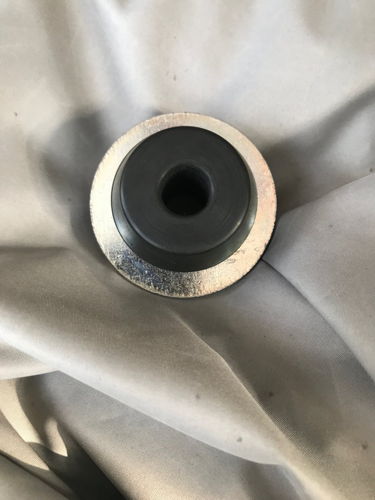

I put tapered end facing up from inside the shock tower, washer against the bottom of the metal, shock top fits perfectly against the wide rubber end, the taper gets flattened with a top washer and nut snugged down on it after install.

You can find similar metal bushings at Ace. Large side of rubber bushing is underneath with the washer sitting on it pushed upwards and insert metal bushing.
Bmachine
3,534
1,792
Northern California coast
So does yours look like the above pictures with the stock metal bushing? Does that mean that the e12 had a larger metal bushing?
