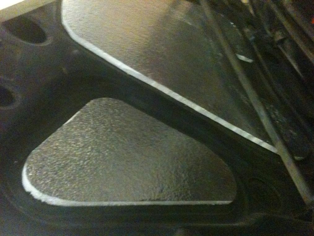

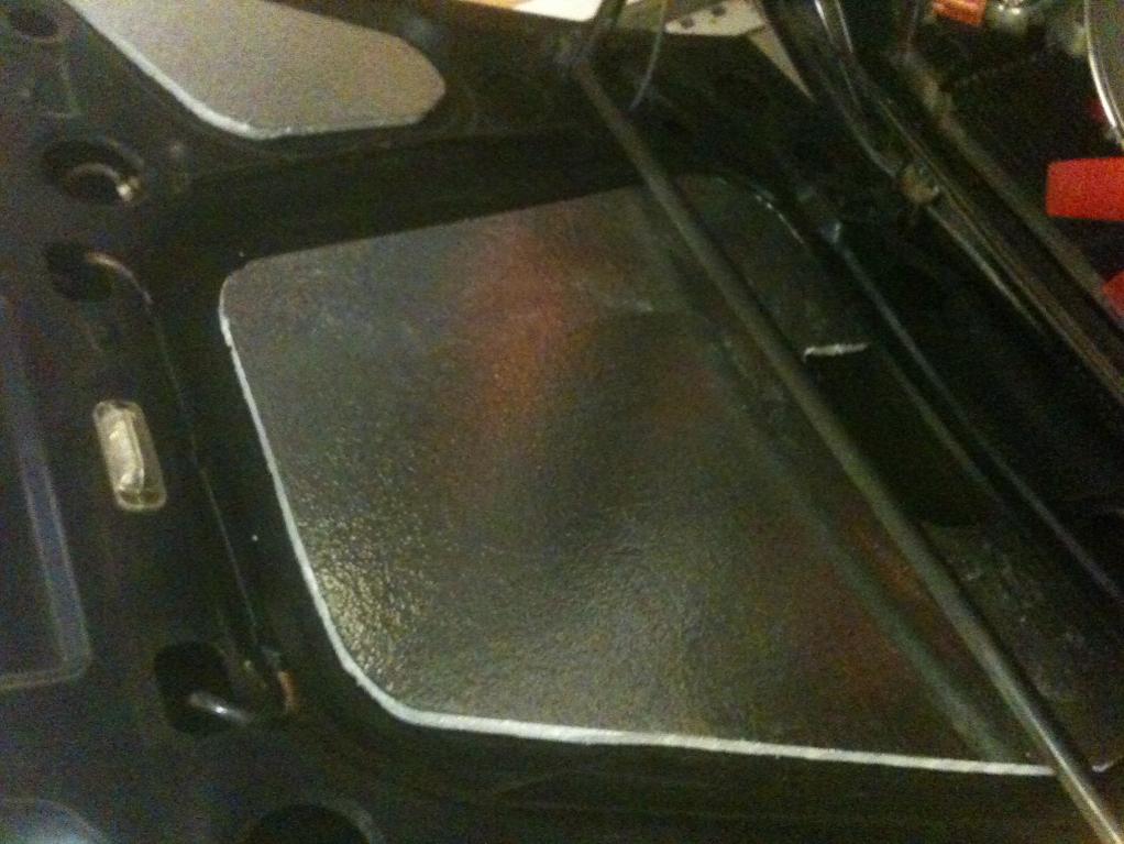

I install $3.00 foam and $3.00 glue tonight. I let you know how it holds.
