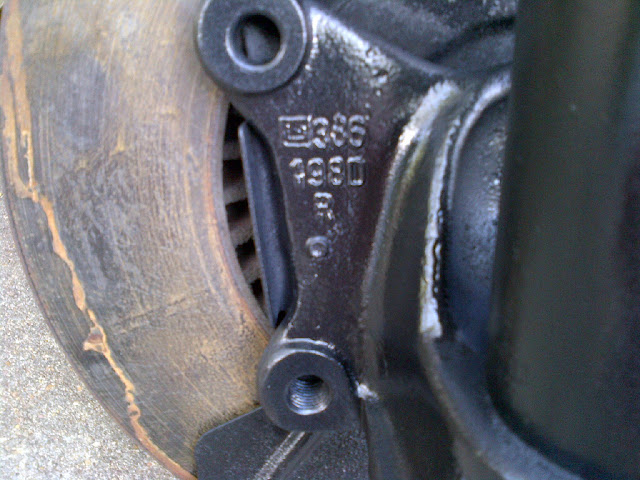

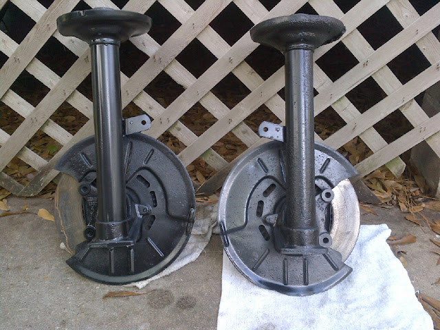

Apparantly somewhere along the line the passenger front strut has been replaced, the problem is that the collar for the new Bilstein doesnt fit - this strut has a smaller diameter collar and threads, although the tube diameter is the same and both original Boges were in place. The correct strut reads "385 01" and the other one reads"386 198D R"
Does anyone know what car this would have come from, other than this the collar diameter it appears identical to the correct strut. It appears my options are to:
1. Get a new passenger strut
2. Get the correct Bilstein and collar for this strut
UPDATE: Since posting this I read a previous post from SFDon that there were 3 different struts and 2 different ring nuts (48mm and 50mm) so it appears I have one of each, is it possible to get a 48mm Bilstein ring nut for my P36-0024 insert
Option 2 sounds less expensive - any advice is appreciated, at present my spring/shock project is dead in the water. Thanks.
Incorrect one:
Correct one:
Both:
Incorrect collar on left, correct one on right:

I went through this same mess with Waynes car..
There are different struts and different collar nuts. Mostly due to year and whether someone stuck a Bav strut in there.
Call Ben at La Jolla and he can explain all the messy facts

Both collars are available still. Bav as Dons says. One is M50, the other is M48. Penske shows them both. $11-12.

The stock collars wont allow the Bilstein arm to come through - they are too small in diameter - I talked to Bilstein and they can get me a 48mm collar that is similar to the one that came with the insert so hopefully that will solve the problem.

Ok Bilstein is sending me a 48mm x 1.5 thread size collar nut or "gland nut" as they call it. This should fit in the smaller nut diameter strut. For the record, it is part # B4-B36-U242-C1 if anyone else should encounter the Frankenstrut scenario. Wes in Bilstein customer service 800-537-1085 was very helpful. Hopefully this will solve my problem, if it doesn't you all will know about it :mrgreen:

I received the new nut from Bilstein and of course a new problem confronts me. The nut will thread in the tube ok but not with the shock in because a) it doesnt slip an inch down over the top of the shock like the original nut and b) there is not enough room for it to go between the shock and tube wall if it could slip on the shock anyway. I've now wasted time staring at my car on stands and $$ and it now looks like I need to source a correct size passenger side strut tube unless anyone else here has a suggestion? Thinner Bilstein from a Bavaria or whatever tube I have on my car (but they have the same Bilstein part number?)? If this is the case does anyone have a strut to offer up? Thanks.

Is it possible that the nut can be machined down in diameter to accept the bilstein?

Upon closer inspection, the orignal nut is a different design so when it slips over the shock it rests on the top of it, securing it in the tube when screwed in. The replacement has no such feature, so if it did slip over the shock it would not lock the shock in the tube. Double 02 has a strut tower available and I am leaning towards getting that so these new bilsteins fit properly and I don't have to compromise safety/performance by trying to make this strut work.
