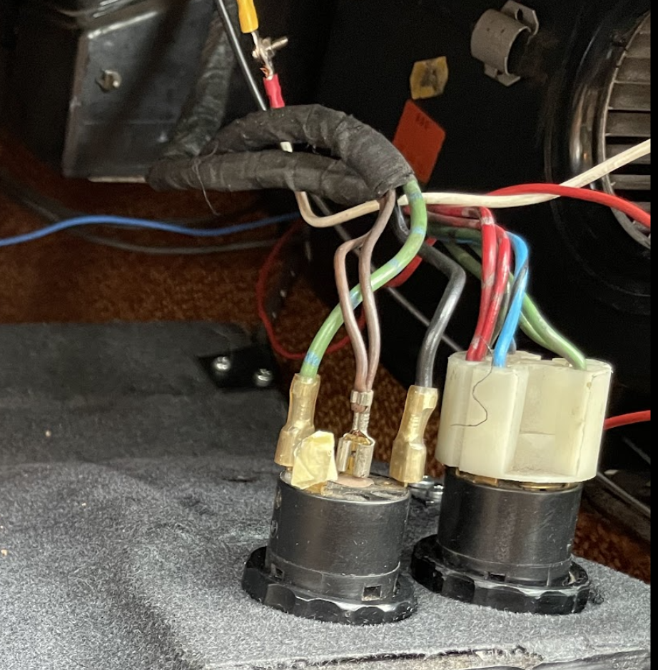

hi Sean,
I check a picture from last year: the wires are as you described - they appear to originate from the same bundle as the hazard light/flasher switch. This is on a LHD.

Do you have a switch on the left hand side of the centre console for heated rear screen ?

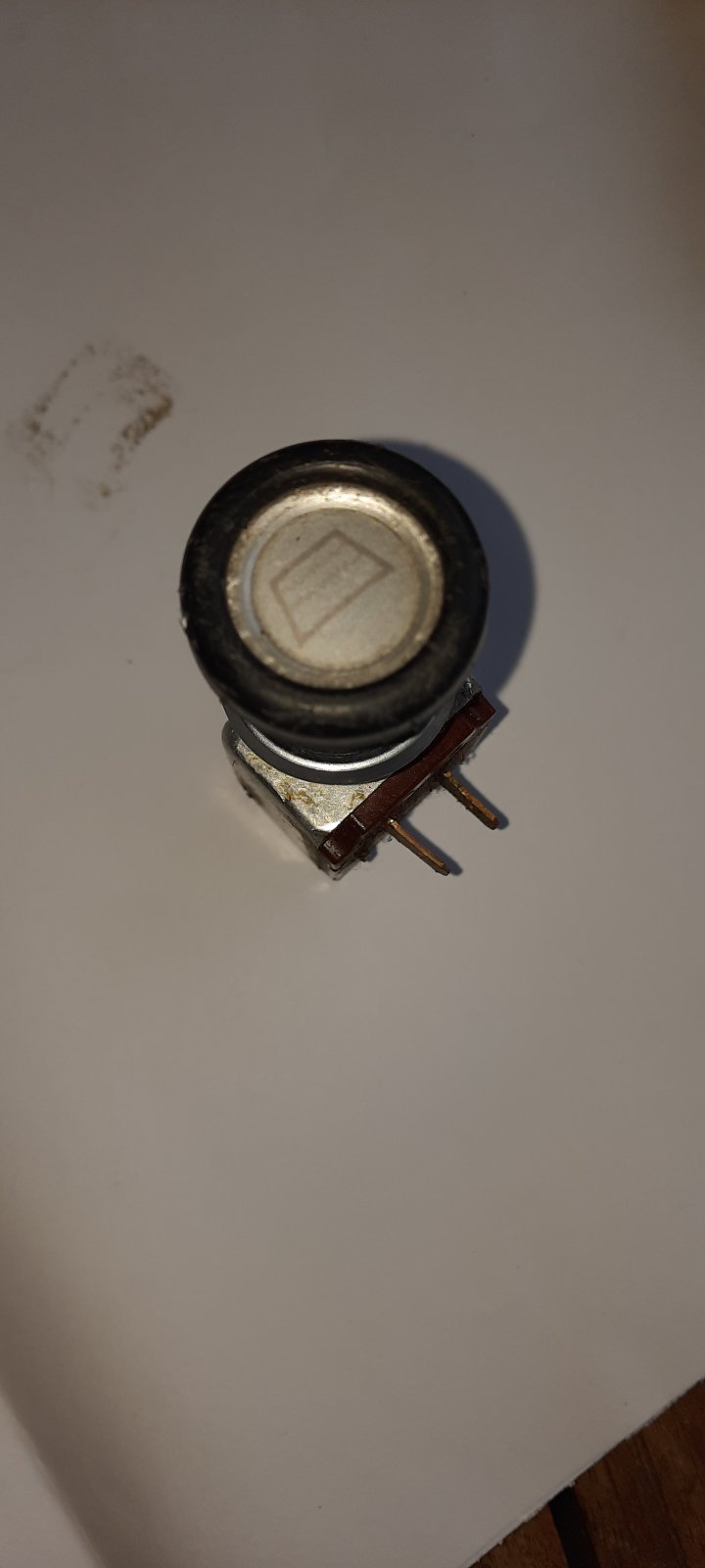

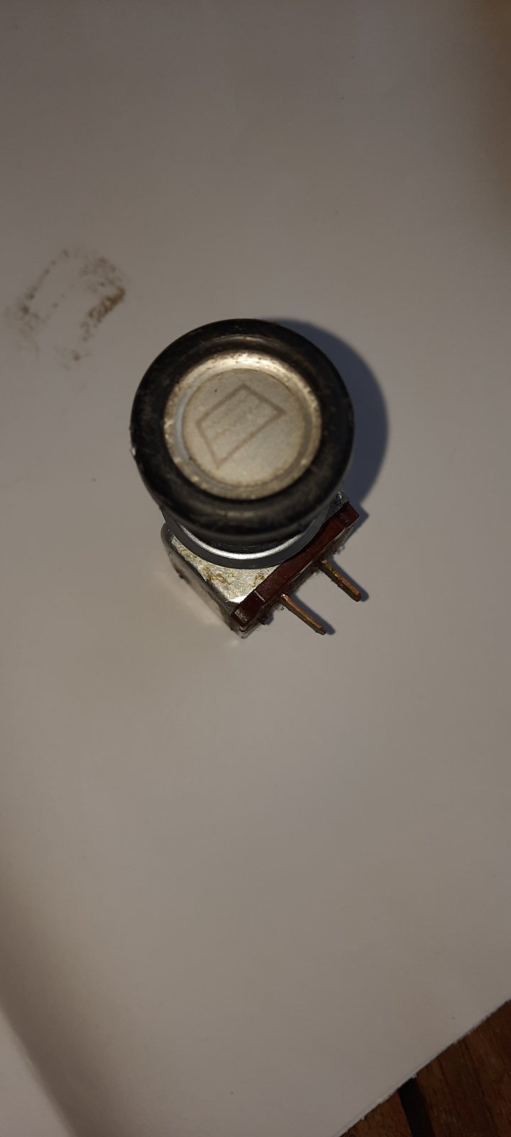

This one
From '73 onwards located left hand side of centre console

Thank you both for the feedback, I had completely forgotten that the center console existed, even though I had connected it and it is working properly. A 'senior moment'.

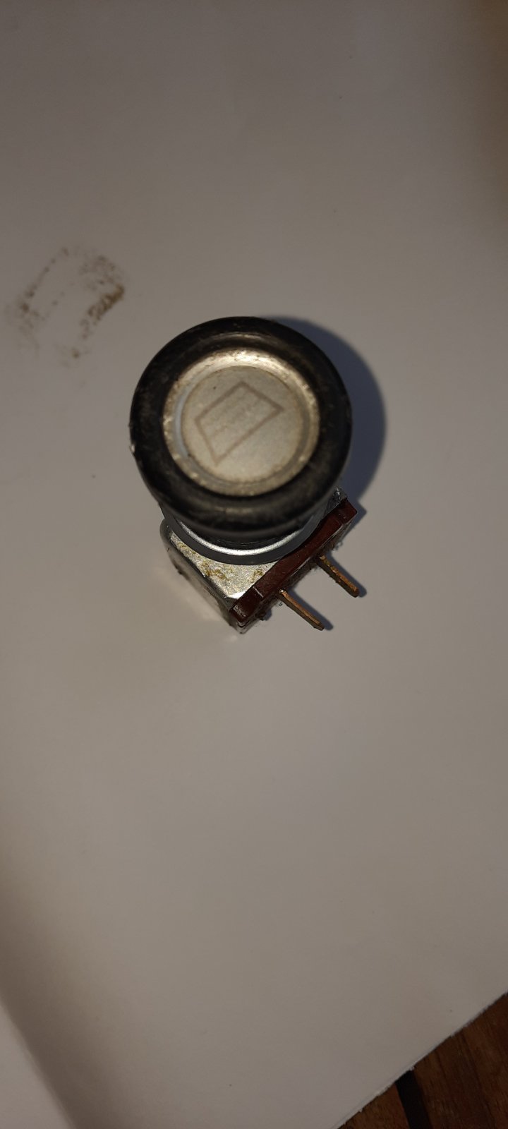

This one
Thomas
I have this switch with element picture on it who need this? and you can use green, and yellow push on switch, I think I have them, but which one is the right one, I don't know the export should answer this.
