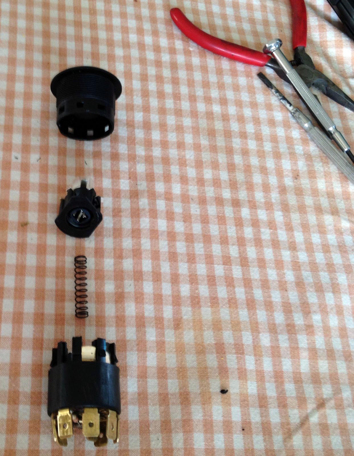

Fiddly but doable. I had to do this fix twice before my switch behaved reliably.

Carefully unscrew the clear plastic lense partway, then screw it back in but not very tight. then roll a bit of a matchbook cover around the lense and push it back in

Easy peasy…
