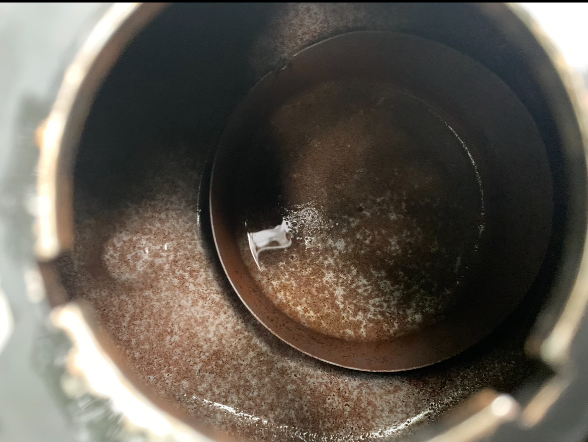

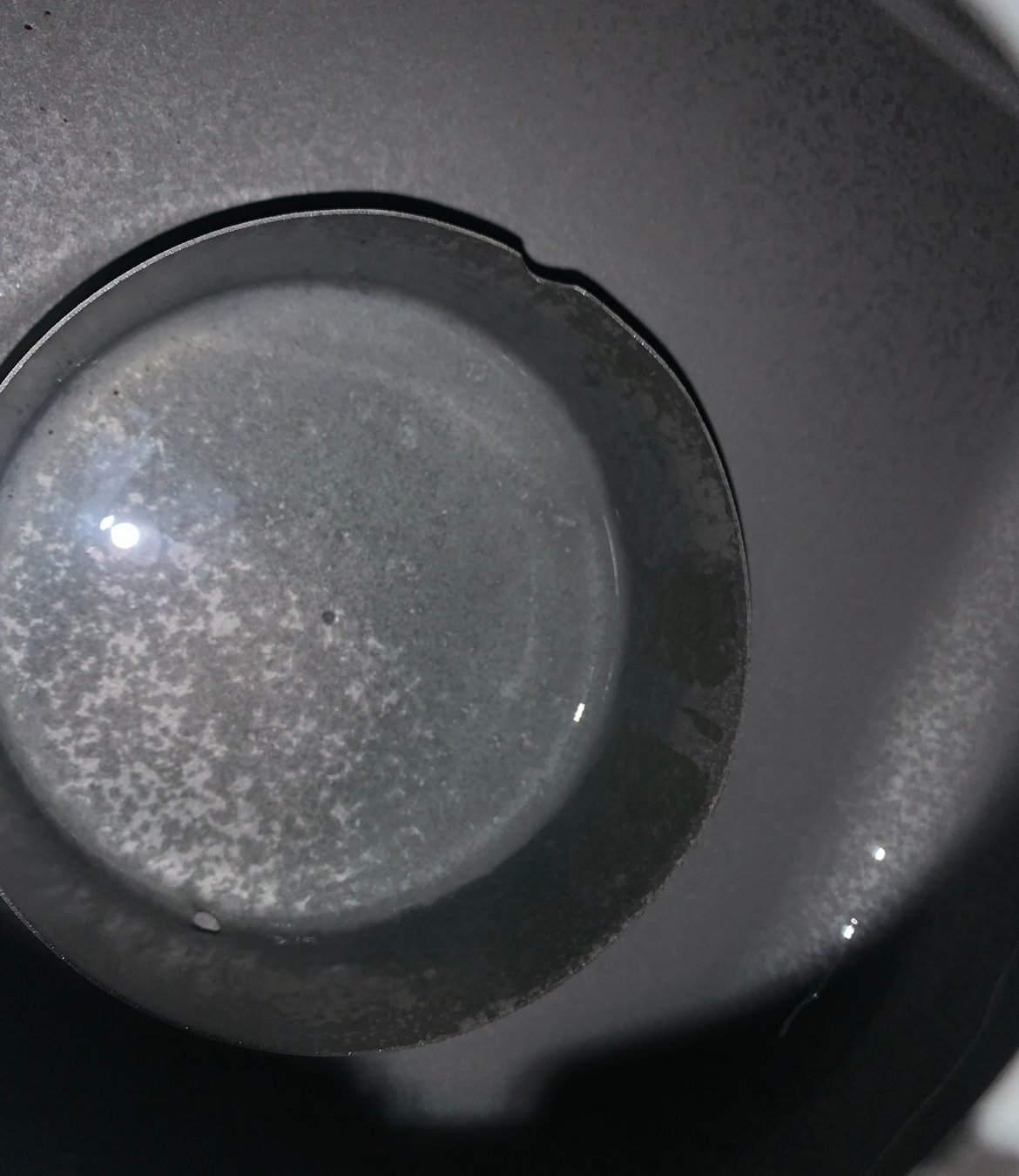

Ive heard of places charging $400 for this service so price seems fair. For future reference, a couple gallons of muriatic acid, diluted with lots of water to fill the tank, 30 minutes to an hour, and youll go from this to this.
Just did this on my E30 tank yesterday, had good results with E12 tanks in past too.
Neutralize it with baking soda after, then swish around gas or alcohol, compressed air and it’s done. ~$40-$70 in materials.
But $285 to avoid messing around with nasty chemicals sounds pretty fair.
