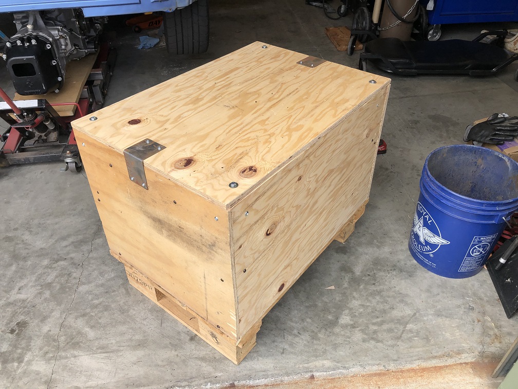

I shipped my Boxster trans from Petaluma, CA to AZ, boxed in a box (!) and it was $261.00 each way, on the transmission shop's FedEx account. So don't forget to ask the shop if they might offer you a shipping deal. BTW, I think this thing weighs in about 175 lbs. And I'm a metal fab guy so I'll tolerate no snarky comments about my carpentry skills (or lack thereof) !

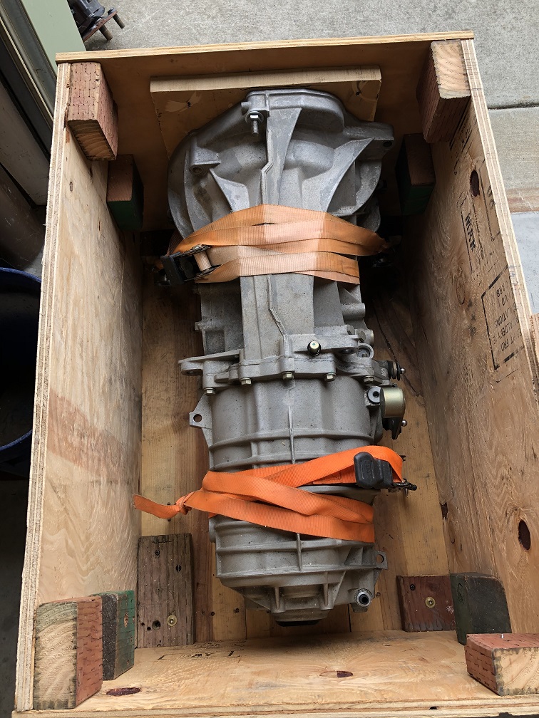

I shipped a transmission like this a few years ago (in a larger bin), except I added a piece of plywood the size of the bottom of the box and strapped the tranny down so it could not move fore and/or aft.
When we moved from Austin to Jacksonville we needed to put all our stuff in storage first so I got a larger bin from Costco and made a base that fit inside. The 265/6 transmission, sans bell housing, was bolted down to the base and 4 vertical 2x4 were installed at the corners to support a thick plywood lid that was flush under the plastic one. Then wooden handles were screwed on the ends into the vertical 2x4 so it could be handled with confidence.
So, basically a wooden shipping crate with open sides, inside the plastic tub. It was so solid it supported a 10' stack of full bins on top with no issues during storage and shipping company moves.

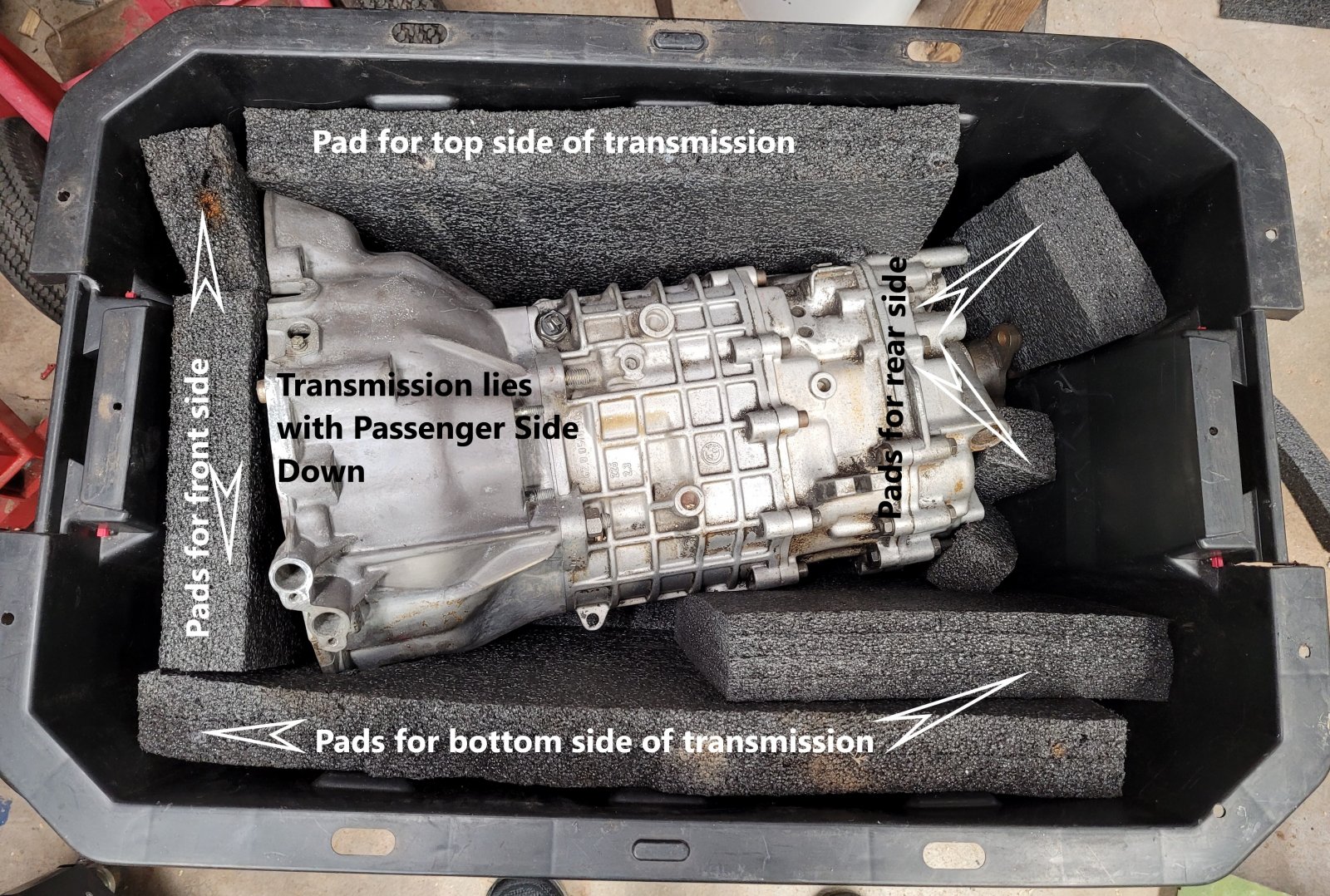

Use lots of high density foam so that the trans cannot move.

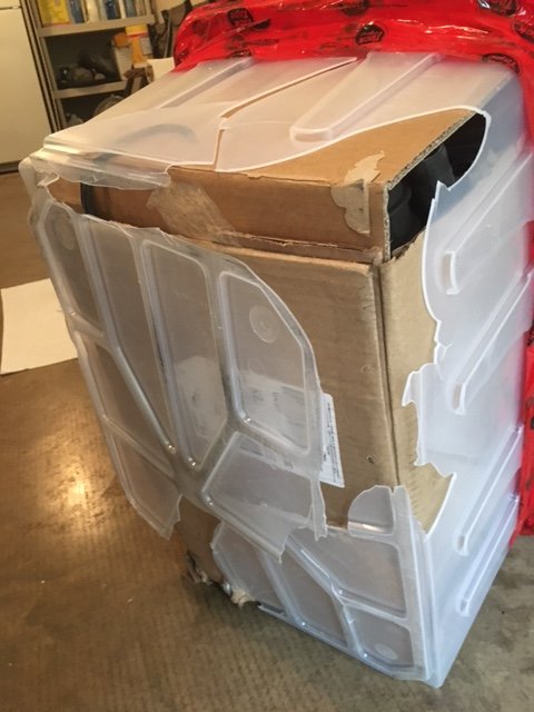

UPS isn't alot better...this new plastic bin shows that the box inside had better have some integrity as well....(this was only an intake and associated parts, so not really that heavy)
I could maybe understand if it was 26 degrees outside, but it was about a month ago...
I’ve shipped heavy car parts in a plastic bin. I used one that was kinda soft and therefore doesn’t crack when dropped ( maybe Rubbermaid ) the problem with most plastic bins is they’re too brittle.
A foam in place box is best, IMHO.
