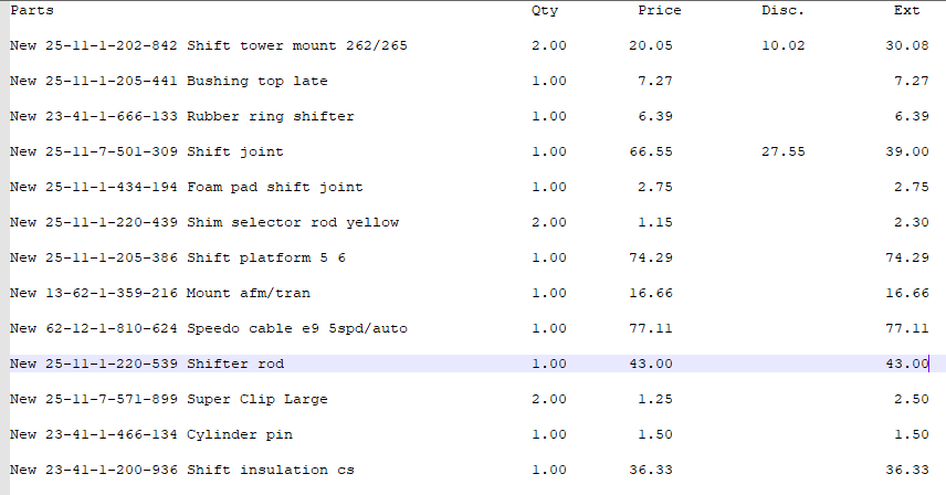

sfdon
8,316
4,684
sfbay area
Rob?
Rob?
Did you forget some things?
pilot bearing
shift platform
shift blocks
knuckle
clips
teflon washers
fork lever
pivot
tank support
rubber bush
resurfaced flywheel
bell inspection cover
reservoir
hose to master
Steel hose to slave
powdercoating
master cylinder
tranny mount (rubber)
insulation
platform support
clip
new hardware
zinc hose standoff
zinc hose standoff
And more...
I will note that anyone who puts a 300 dollar 30/40/50 year old drive shaft in a $100.000.00 car......... deserves it.

Some parts may or may not be needed here listed:

sfbay area
I will gladly pay for 10 of those shift platforms at that price but I can’t…
unobtainium……
none to be had.
I will also gladly pay 2.95 for a steak and lobster dinner but……
you get the idea.
