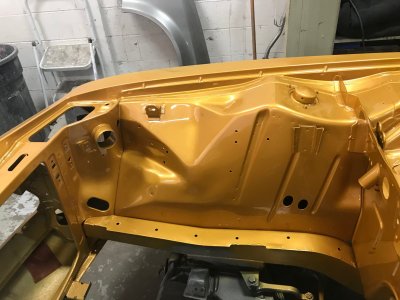

This looks very nice...with what is shown. Missing good pictures of the important areas. Something looks odd about the top of the inner fender on the passenger side (seen only from an odd angle).

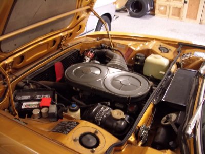

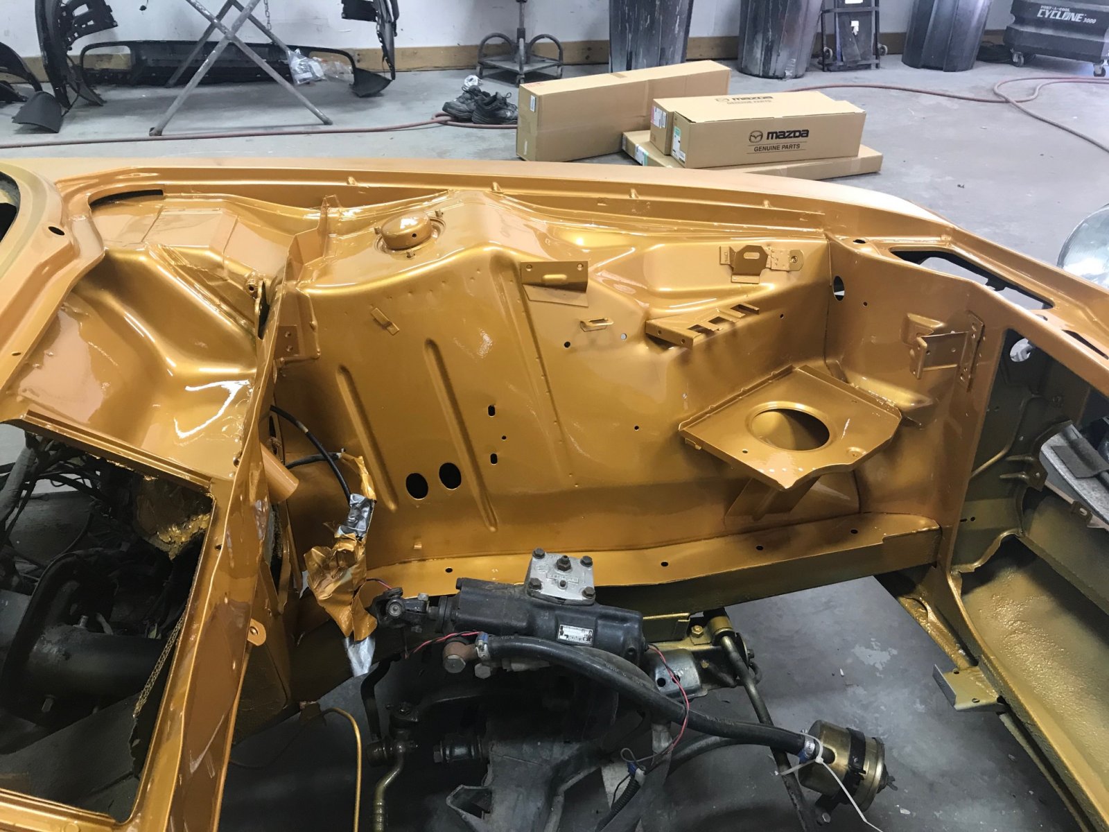

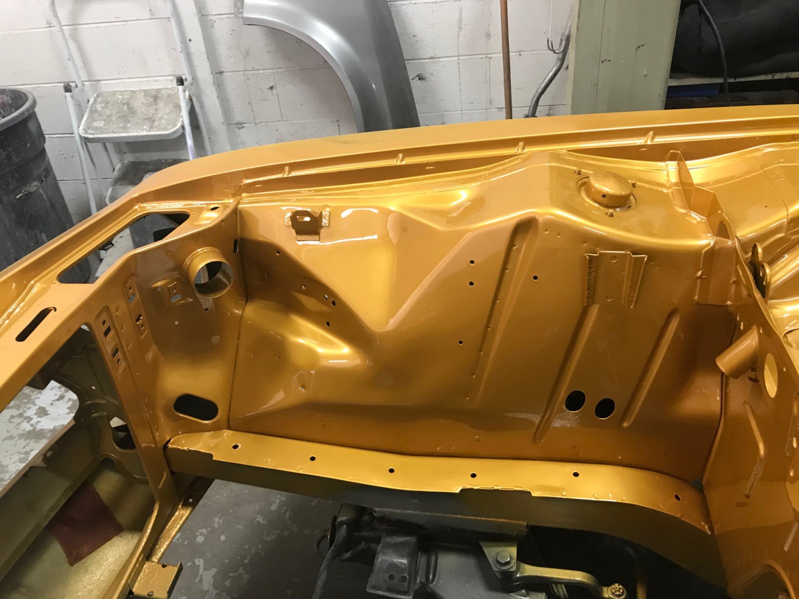

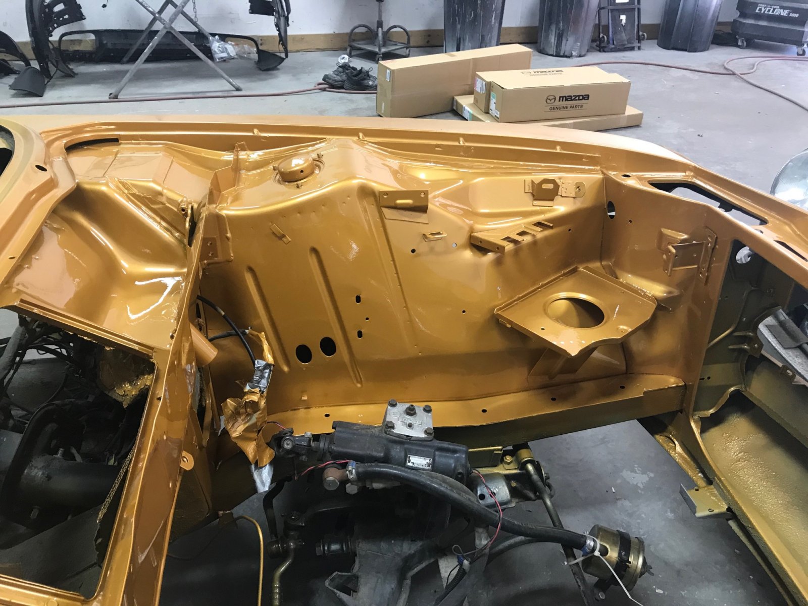

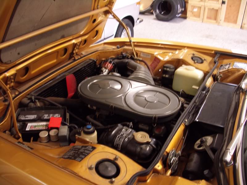

love the exterior / interior color combo. i have to agree that the fender tops look more than a little questionable. they sit up a bit high, and there is some crustiness there that looks foreign. i have attached some pics of mine after paint and also of an engine compartment of a very original coupe
