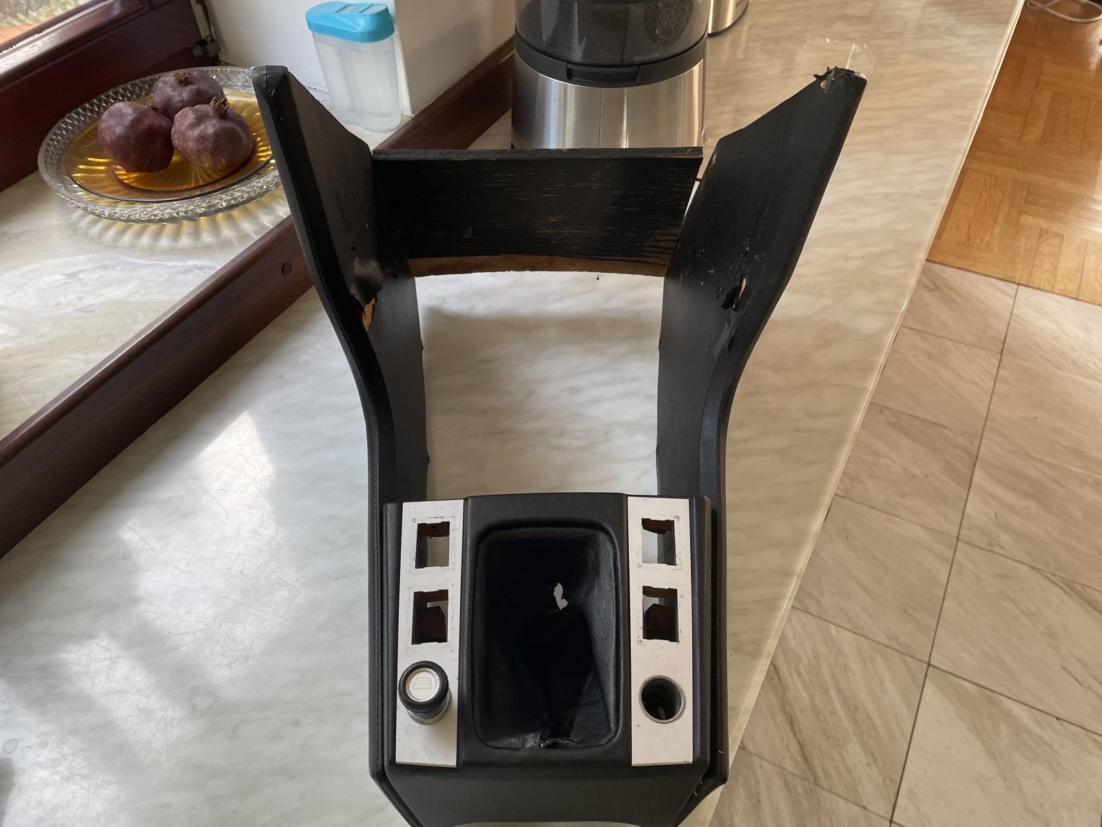

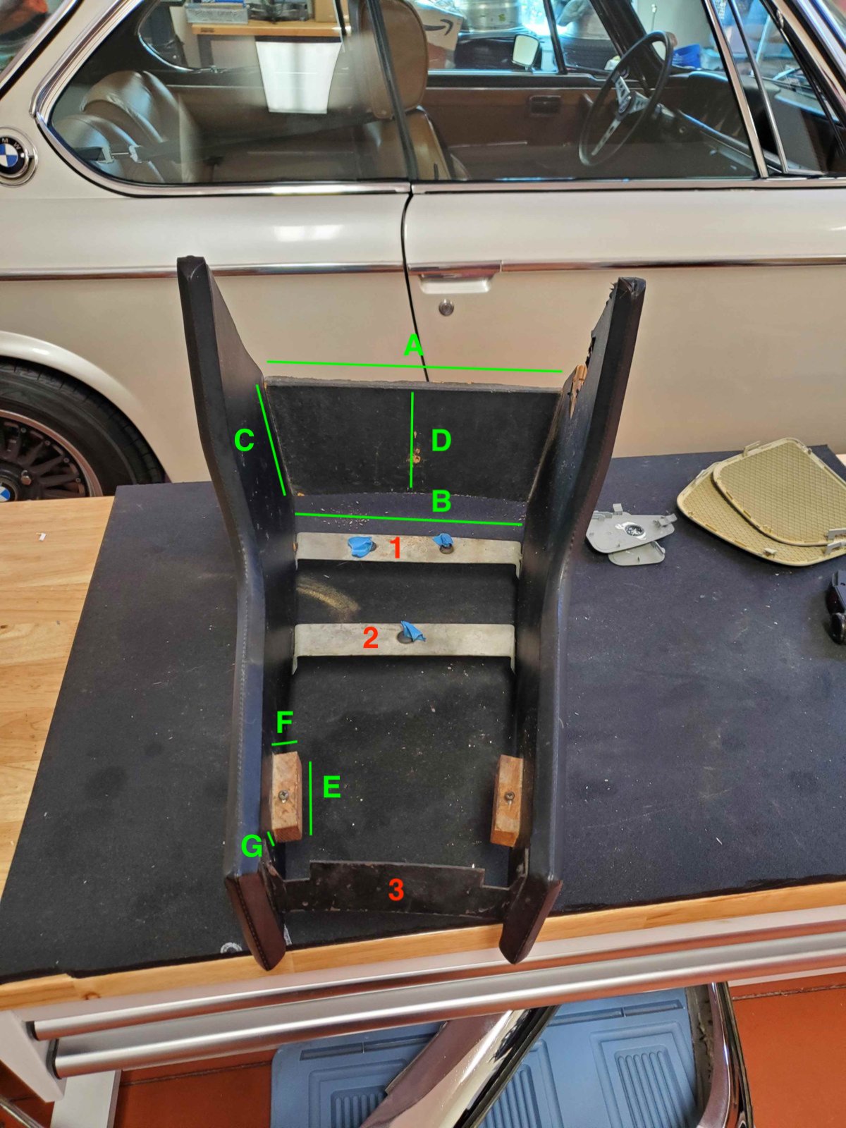

I need the console brackets (1-2-3) and wood dimensions.
Do you have any of this for sale?

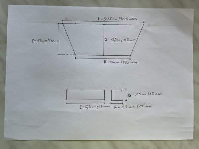

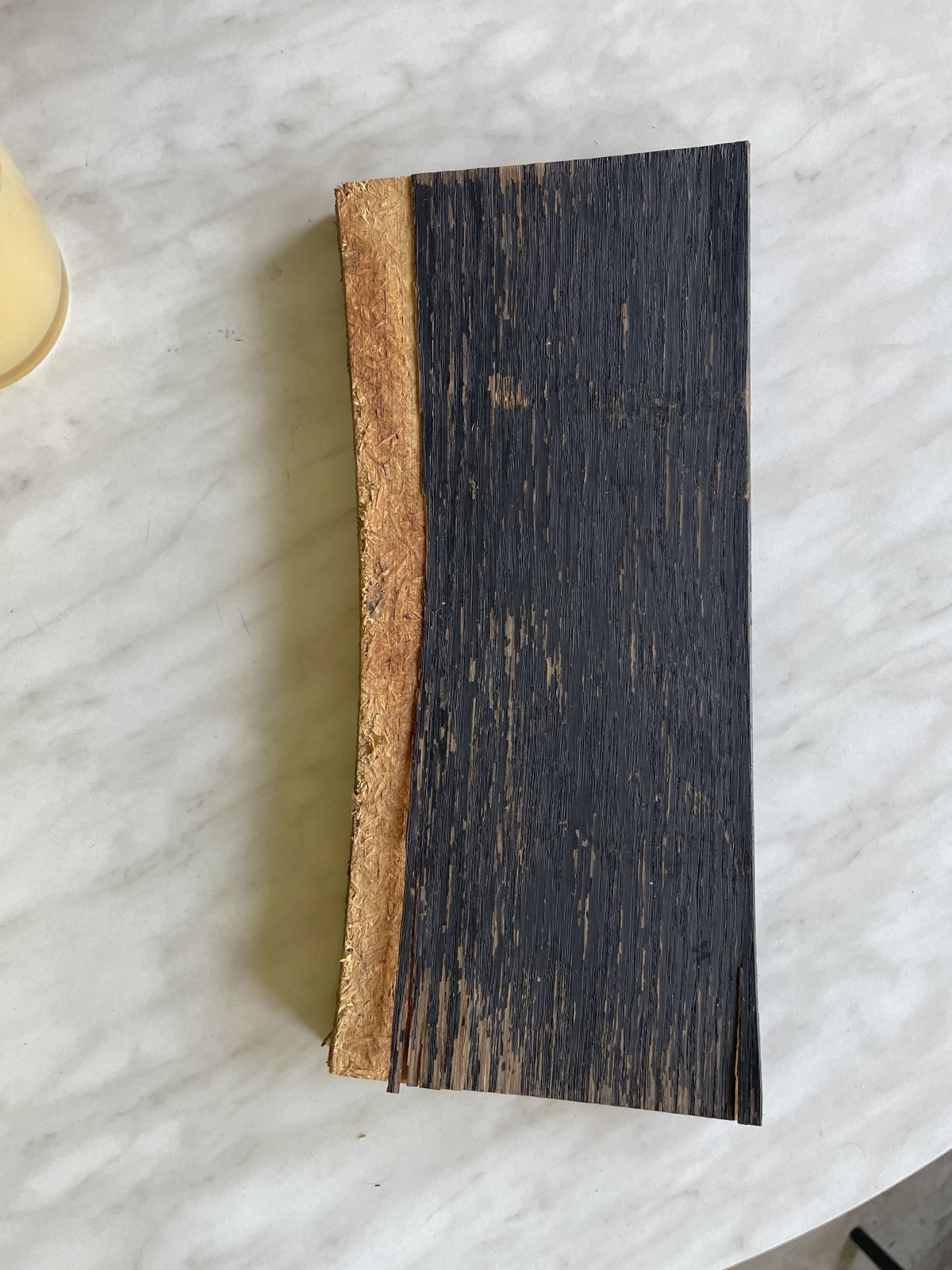

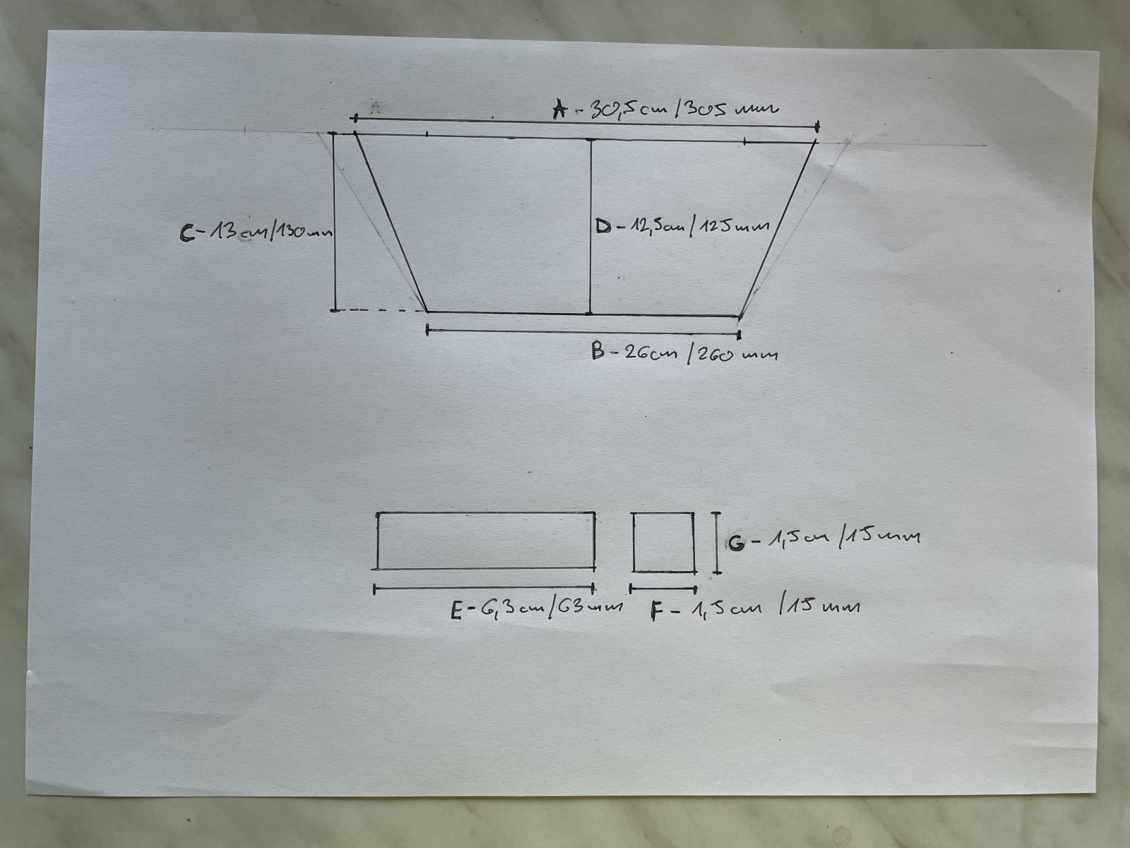

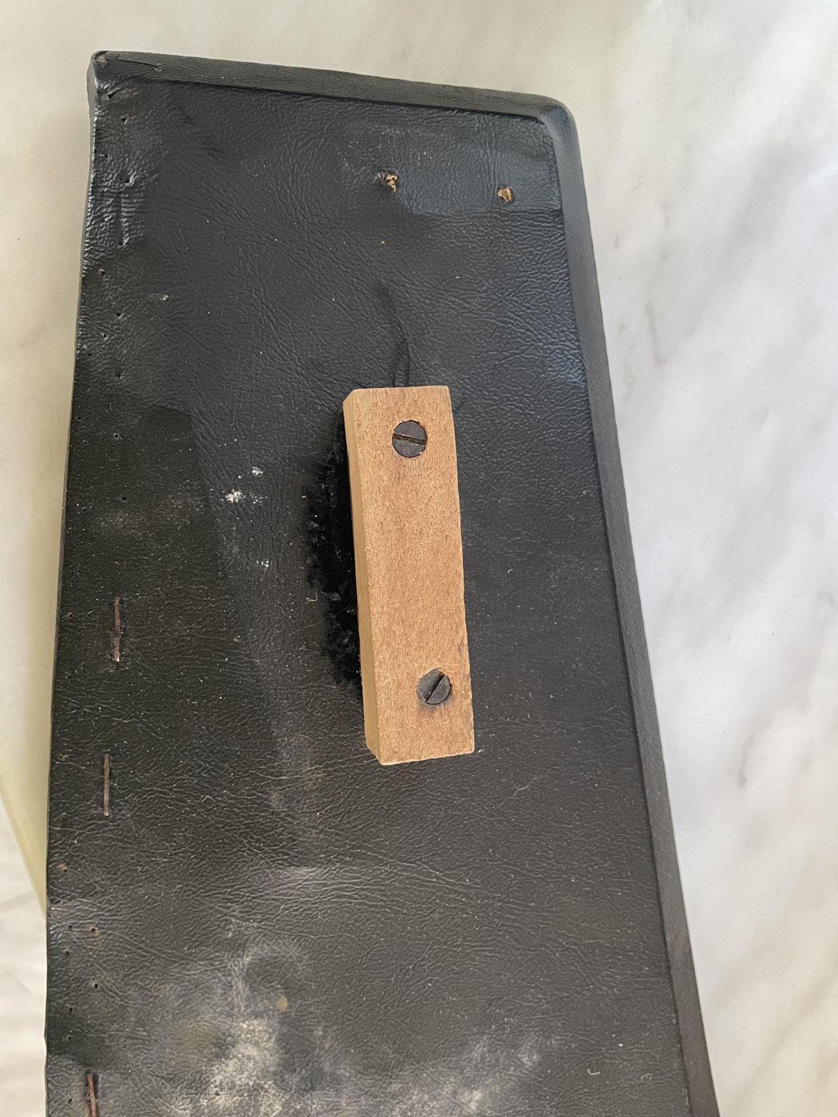

Hello.
I hope it helps.
I will send the dimensions of the metal connectors tomorrow.
Regards.

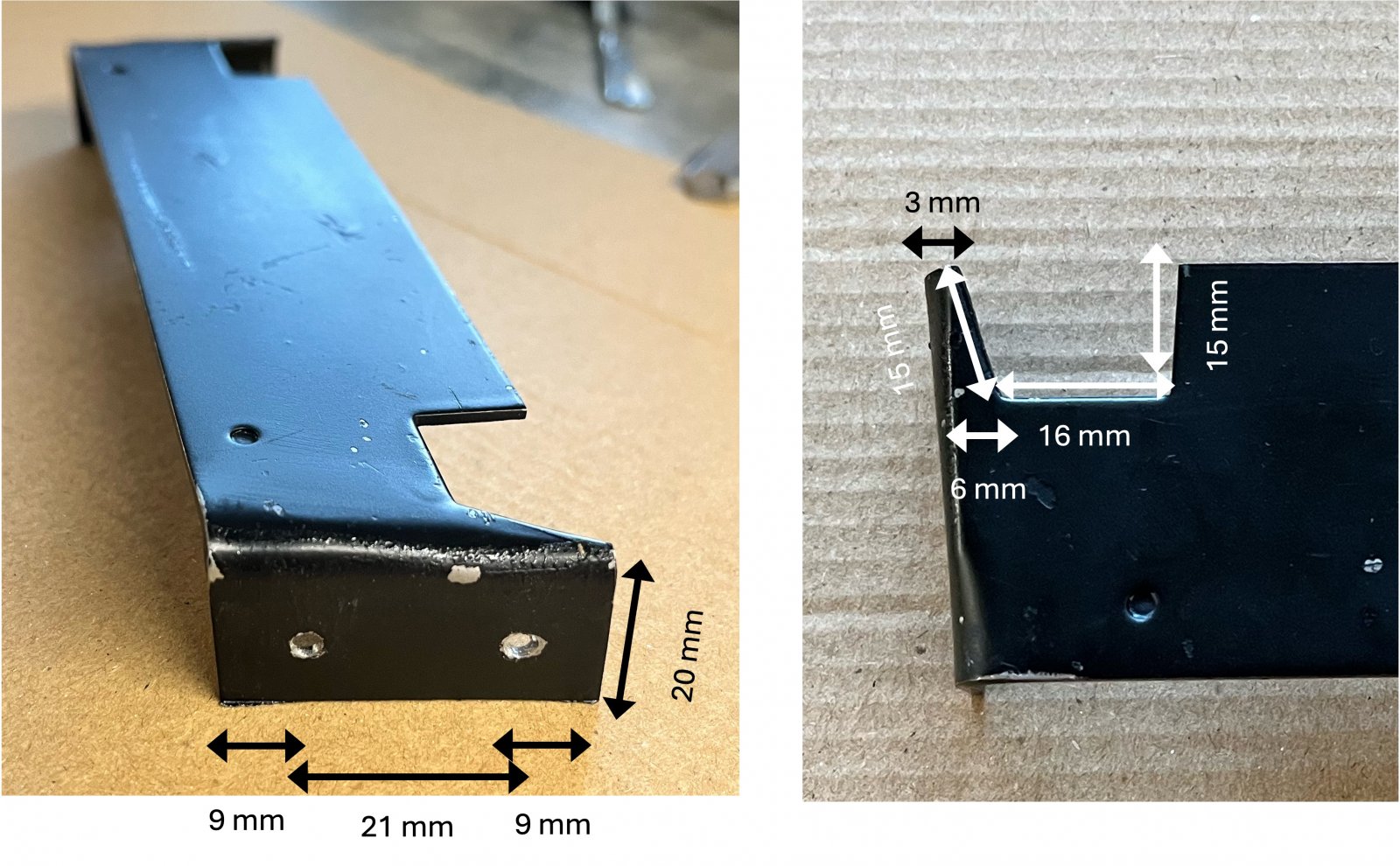

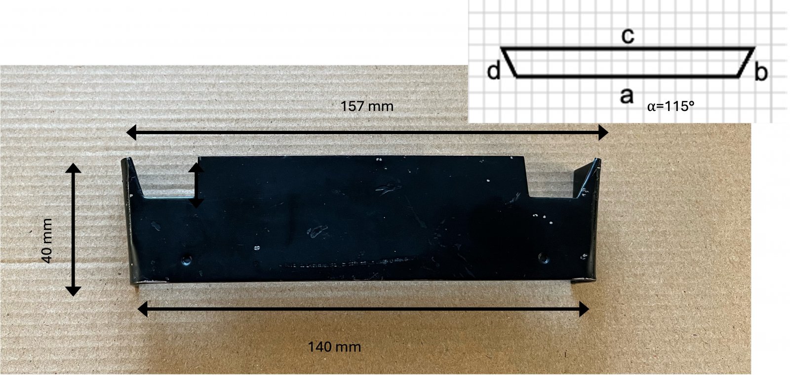

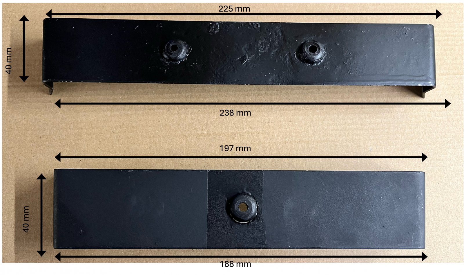

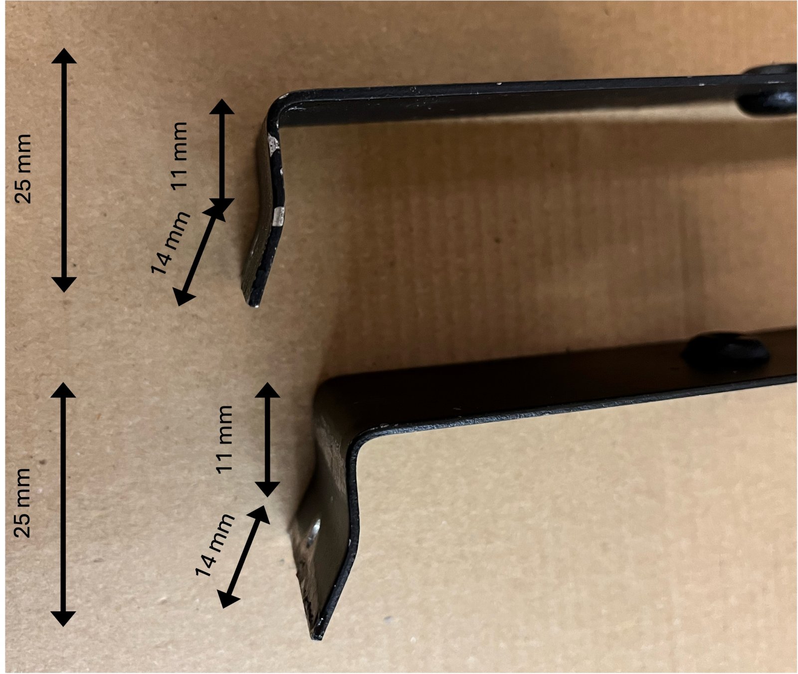

Hi Alberto
see measures below, hope this helps.
The angles are tricky to replicate as they sit on the tunnel.
regards
Dominik

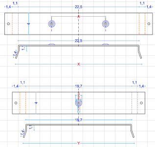

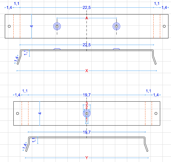

@Dic Can you send me this measurements:
