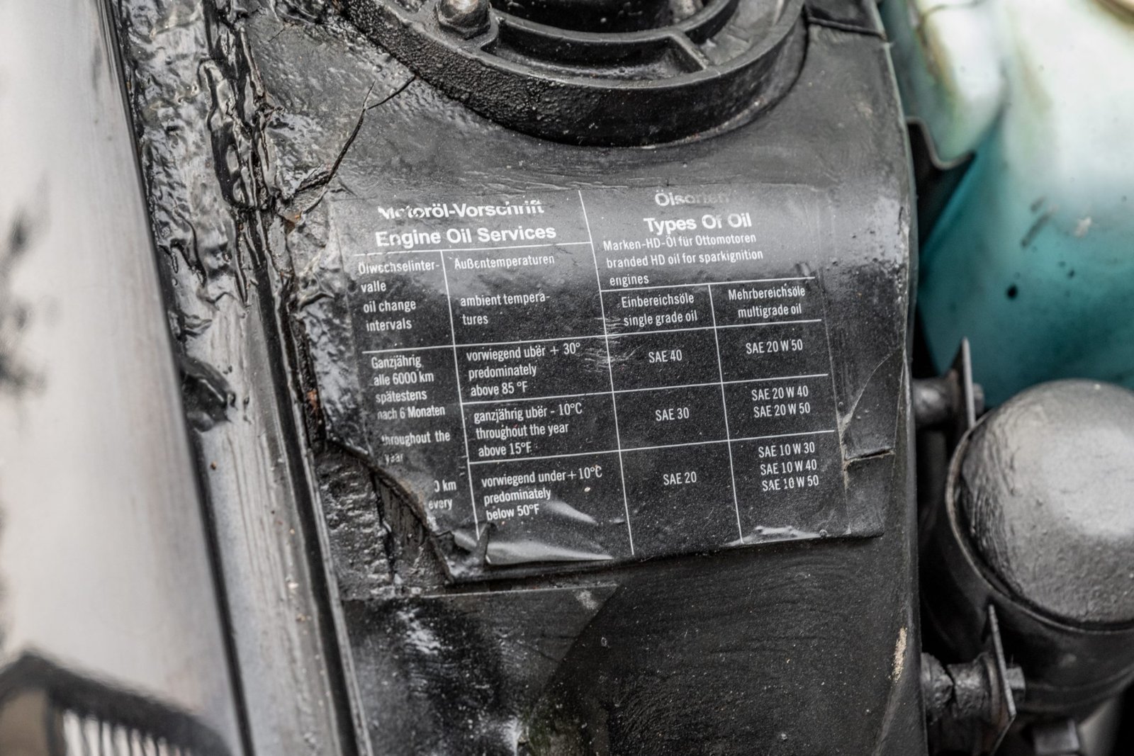

The pics make everything look wet. And it was restored in 2014, but fenders needed work in 2019 and hood in 2021? Those fender channels don’t look good but we only get to see a small view of them. And two different fuse stickers under the hood?

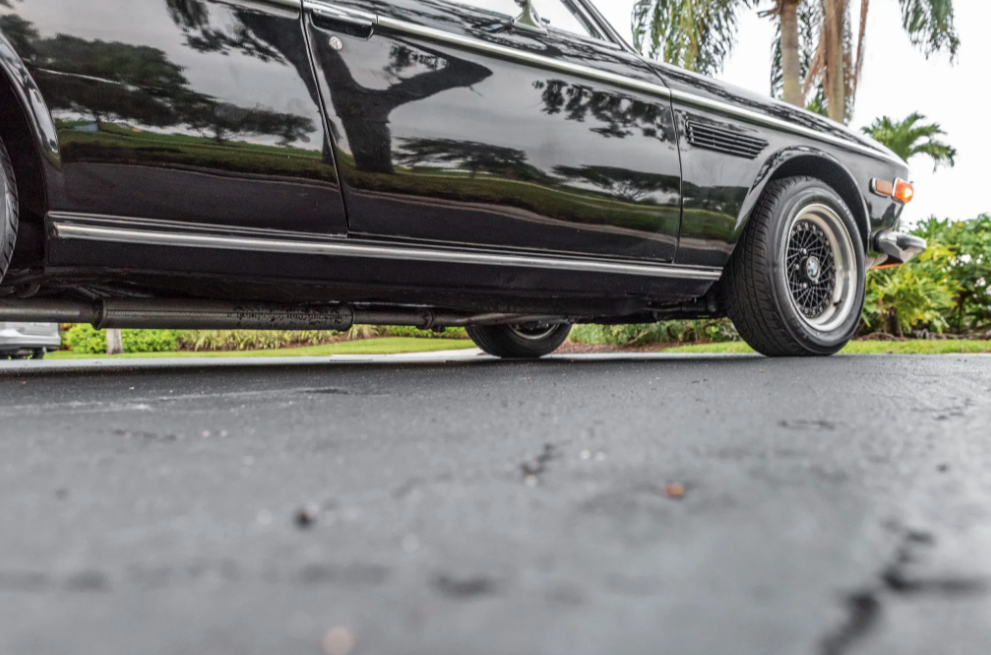

Here are a couple of photos from the listing...
The reflections in the paint are not very sharp. They should be almost like a mirror if cut and buffed properly. With black you need to get ALL the orange peel out. On black, I make my final cut with 3000 grit. Black is the only color I need to go this fine with. If you rub your hand over 3000 grit sandpaper it feels like a baby's bottom (slight exaggeration;)).
Even with the not shiny surface, you can see how the reflections are distorted due to the poor body work. The distortions will show more with shiny paint.

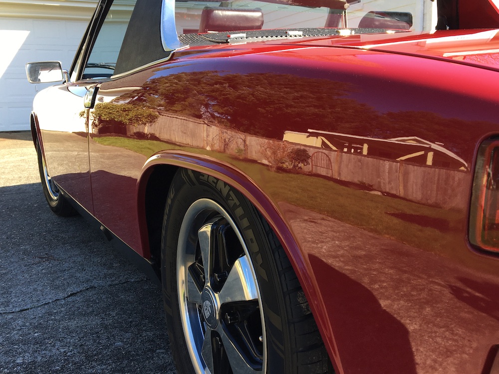

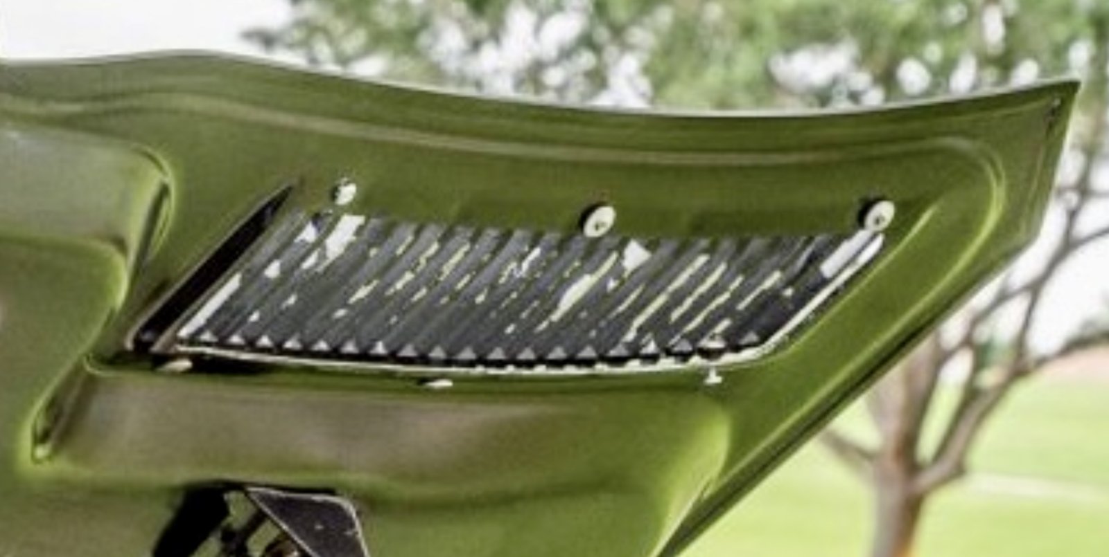

Here are two cars I have done but no longer own. I am not a pro body man. Rank amature. I'm slow and if I had to pay someone as slow and as inexperienced as I am to get these results, I'd go broke. Also, I did not apply the final paint on these two cars. I did the body work and primers and the cut and buff.

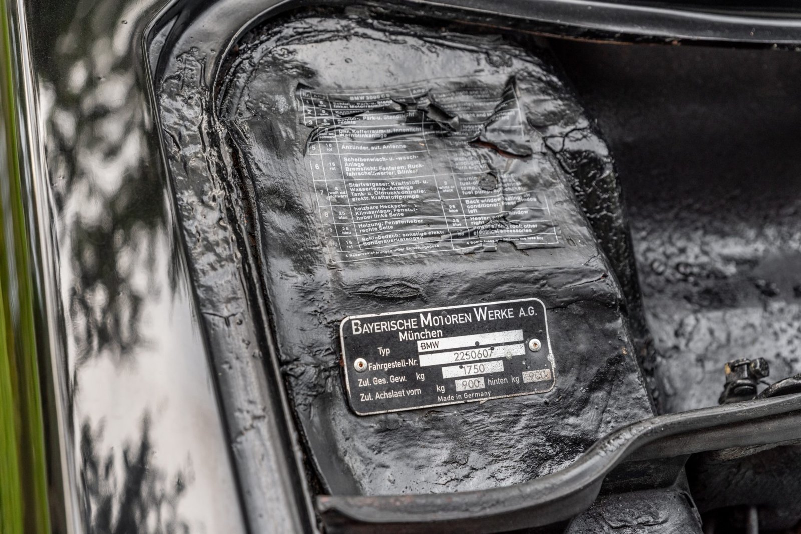

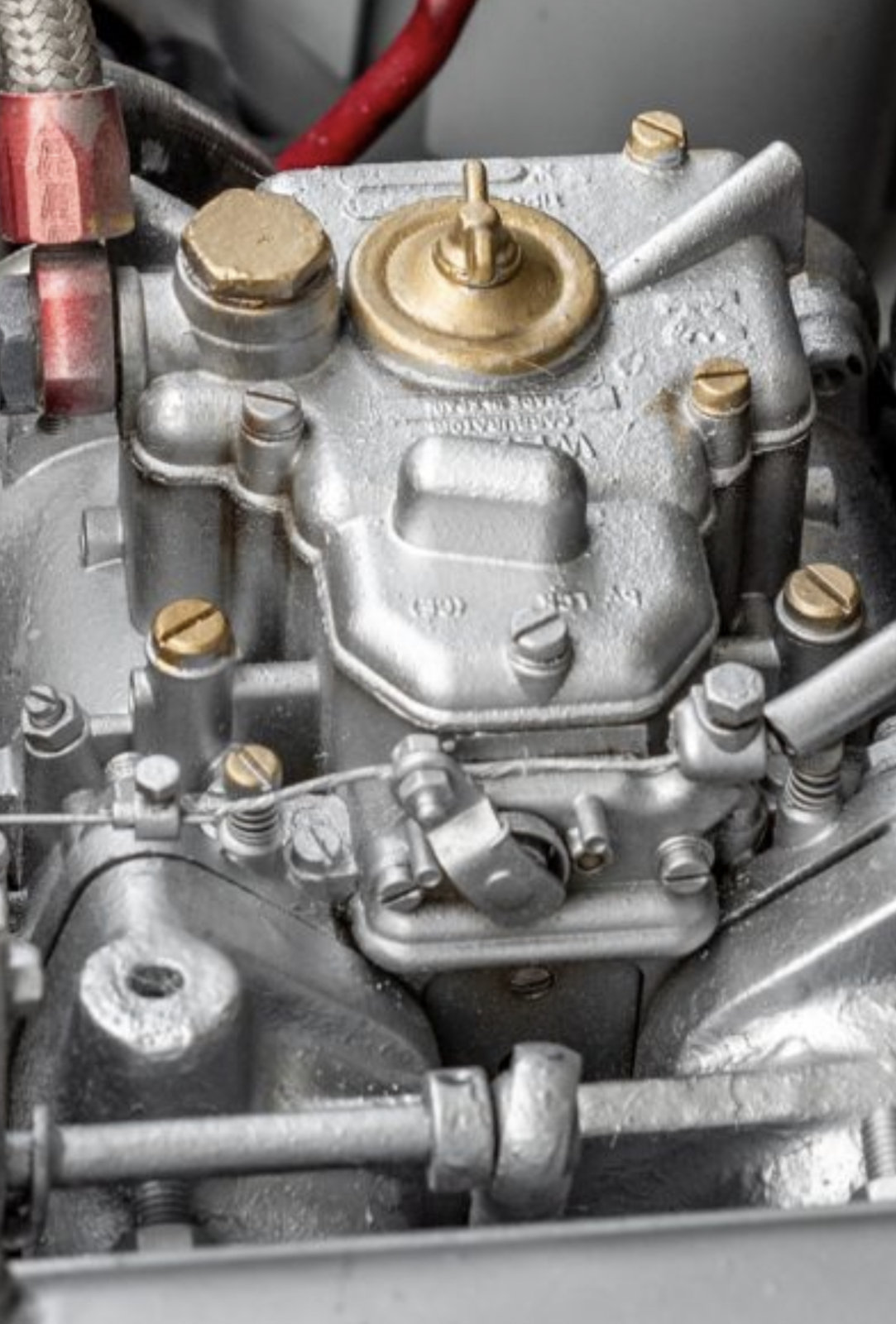

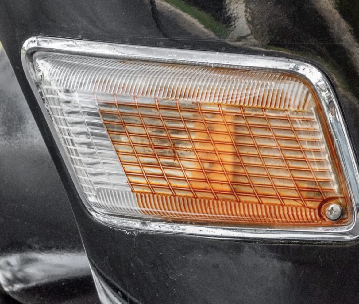

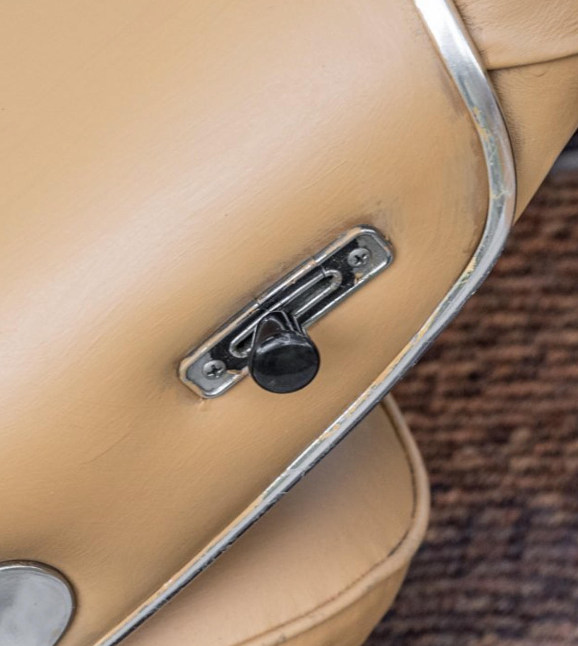

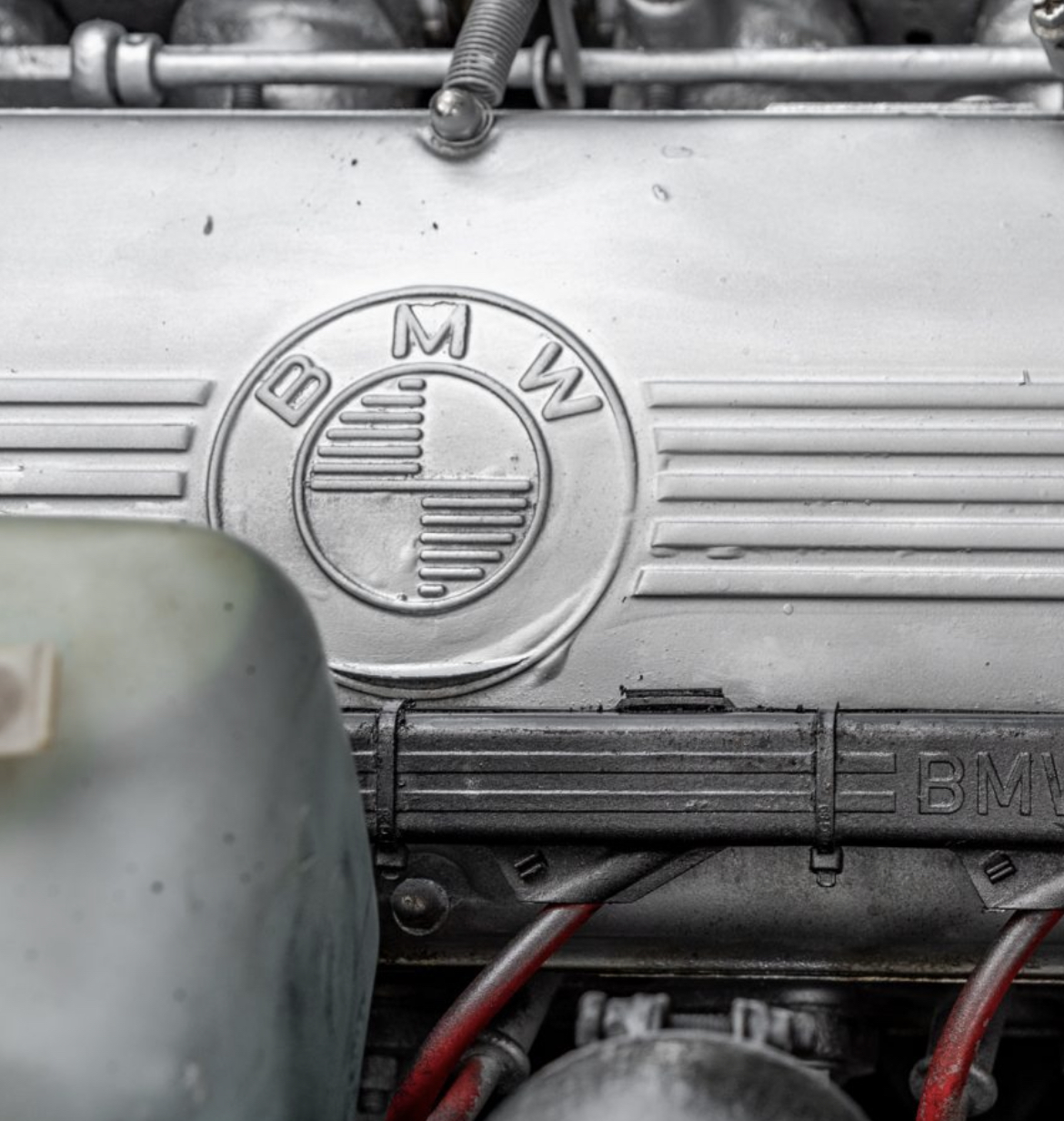

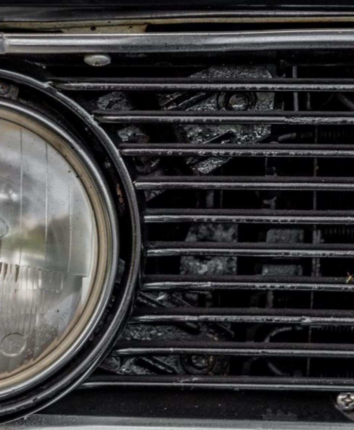

Everything on this car is coated in something. The seats and panels are painted tan. The dash is painted black. The wood has lacquer brushed on, the HL grilles are painted black in situ. The bay, shock spacers and anything nearby are splattered black (not excluding headers). The valve cover, manifolds, and carbs, suspension and exhaust are sprayed silver in situ. The clear signals are sprayed italian amber. The calipers are sprayed black.
I only know this due to observation of overspray, failing paint, and hand cutting the interior (versus masking or part removal). I have little room to judge. My car isn’t this nice as of now. I like this car and I think it will make someone very happy.
Personally speaking, I would rather just see the car in original form versus all of the enamel dressing. To each their own. If the car is dry, this seems like very easy stuff to “undo” if desired.

BTW, I have NEVER seen someone rattle can a DCOE before! I never would’ve believed it had I not seen it.
Owner exhibits a sensibility which I find totally alien.

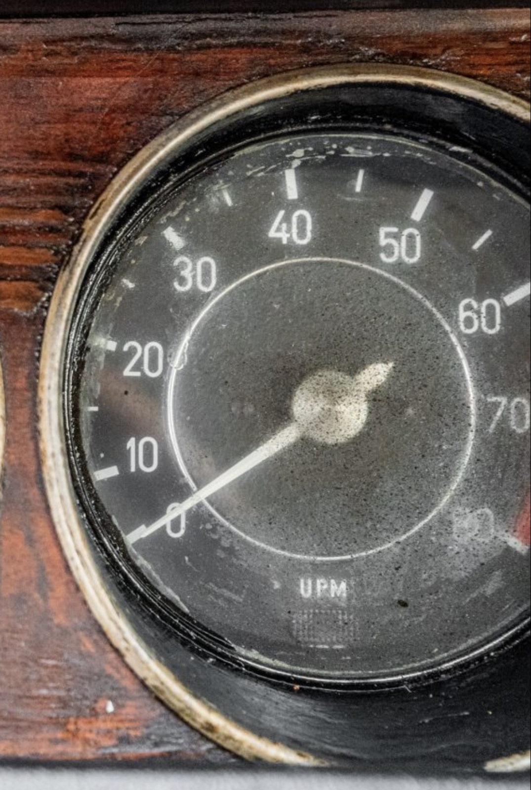

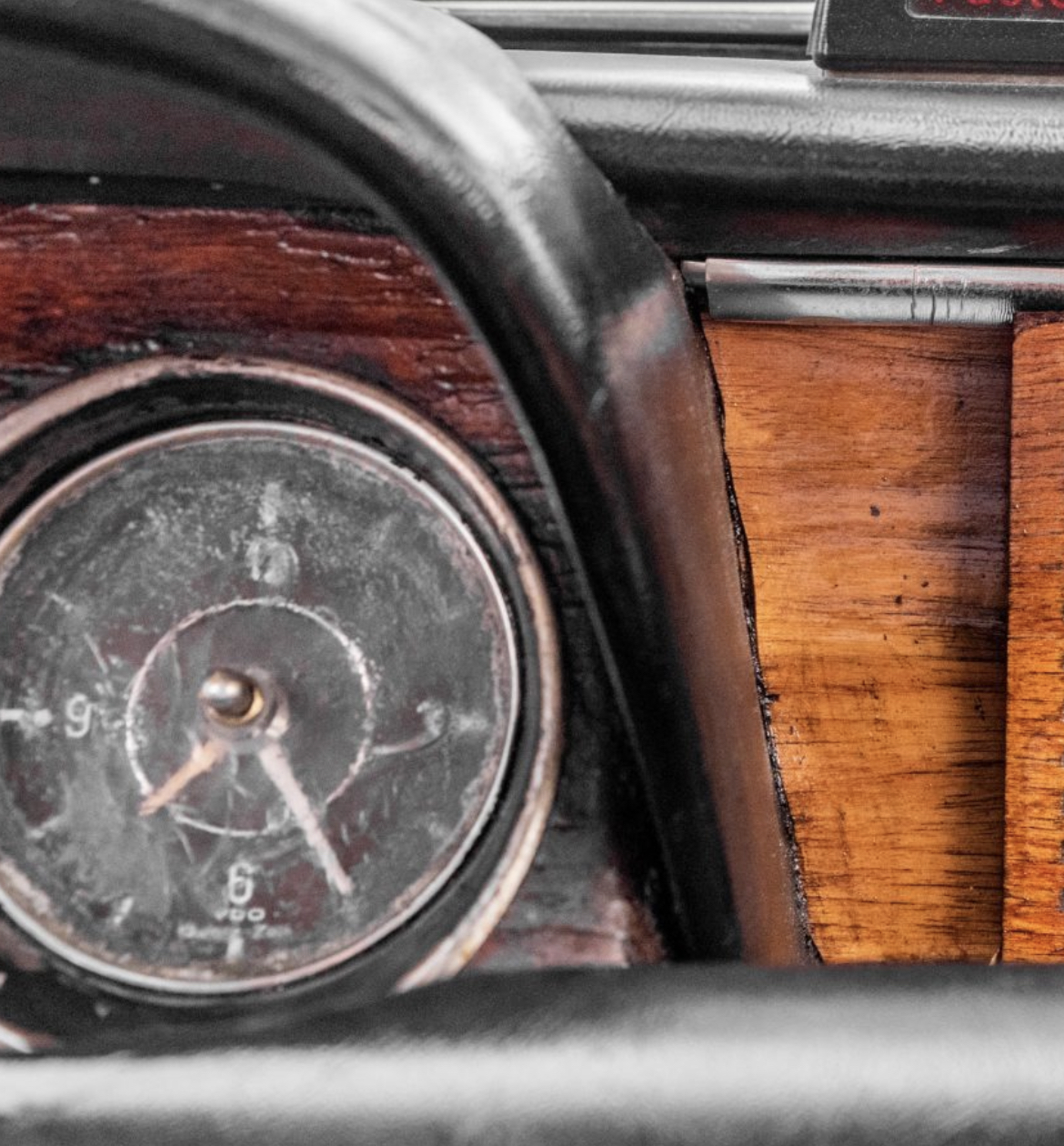

That dash wood (and gauge faces/surrounds) would need to be changed asap for the buyer IMHO. That would bother the heck out of me.
LOL I knew the clock glass looked like a Christmas ornament, but missed this one. You might not be surprised to learn that what we see is black paint overspray. :D Looking at the gauges, I think they are frosted from spray on lacquer for the wood.

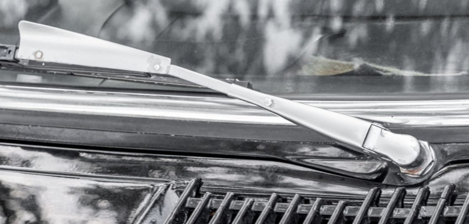

Wipers also got silver treatment:

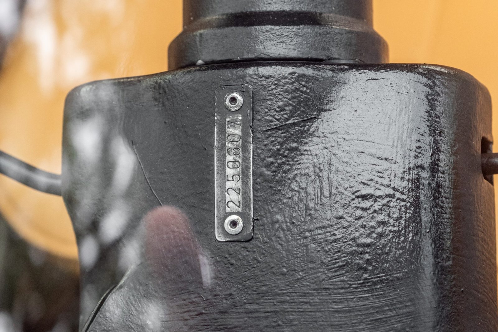

Steering column got brushed black:

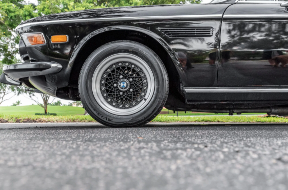

Those front fender channels are rotten from the inside out, and have been painted over/touched up, whatever. You can see the rusty metal pushing up the sound deadening panels.
You could still buy it, love it and enjoy it for a while, but just know once you get in there there will be much welding to put it back right.
