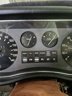

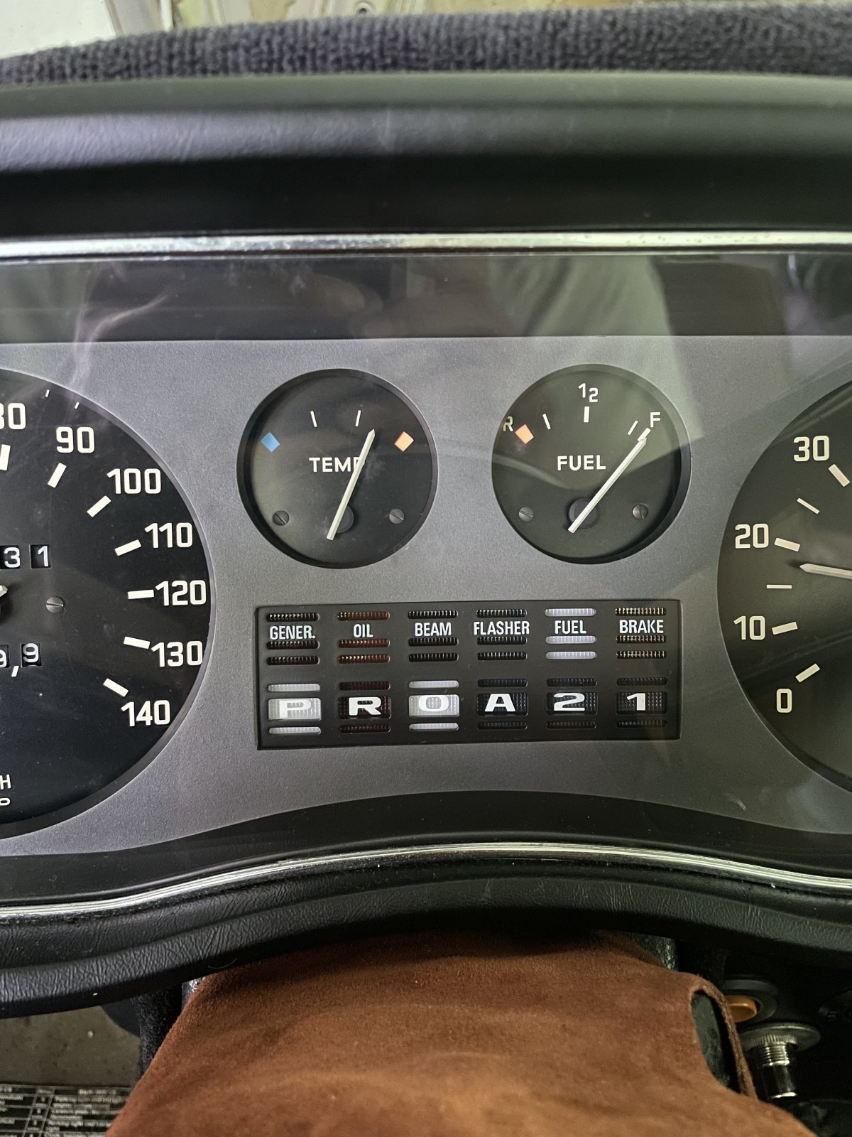

My 1970 2800 is running a little high at idle and around frequent stopping low speed streets. It doesn’t run high when I drive on a highway. I opened the vent screw at the thermostat housing and bled the air as much as I could. I ordered a new lower temp rated (original at 80C, this one is 70C) to replace. I see that my asymmetric red 5 fin fam seems to be running alright. I didn’t check whether it’s clutch works or not. Where should I begin troubleshooting on this? Also how does your cars run at low speed?

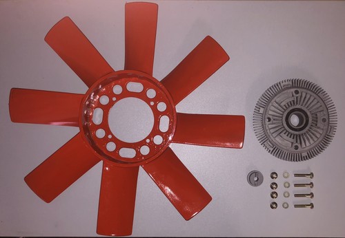

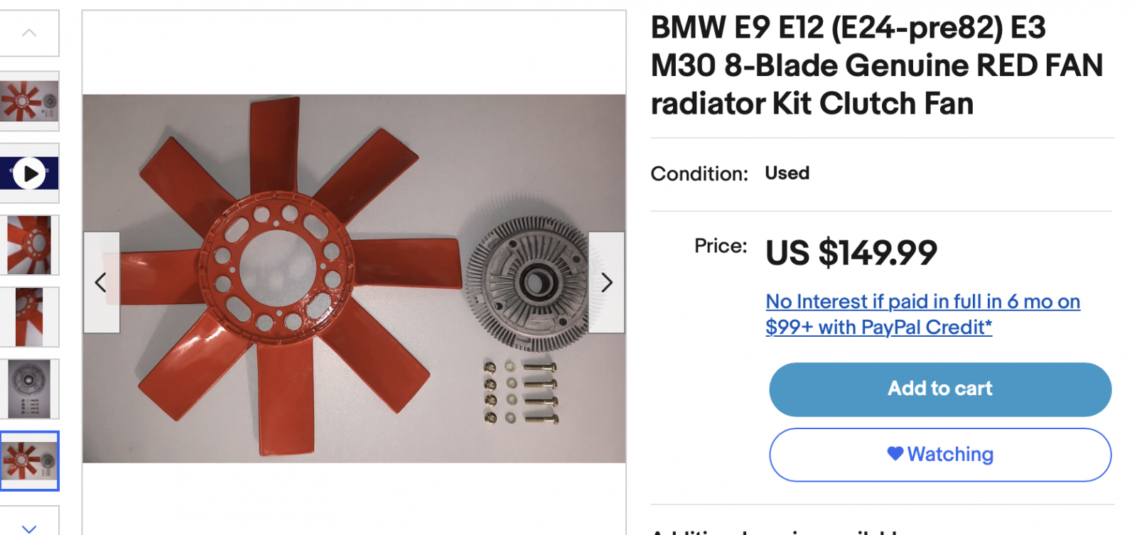

I decided to pursue finding a 2nd-gen 9-blade fan and its clutch. I found this on eBay. Would this fit without having me replace the water pump? Besides what's in the picture, what other part do I need to be able to retrofit this into my current setup with an asymmetric 5-blade fan?
HB Chris
19,418
8,759
Huntington Beach, CA
It will work with the 1st gen water pump as long as there is no large nut on the other side of the fan clutch but you will need the mount for the pump and the large screw both of which are still available I believe.

Did you test your fan clutch before you bought the kit on eBay?
what was the result?
you realize you are missing 3 items to attach the new kit to your car- have you sourced them?
