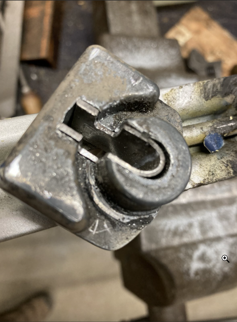

The hood in my Bavaria does not stay up. In fact, there is no tension at all on the torsion springs. Can these be serviced somehow or is it a sign that the springs are broken?
Mot27cars
1,216
649
Elkhart, IN
Check the end pieces. They are replaceable. The pieces that bolt onto the arms.

I should have taken mine apart before I posted. Is it these end pieces that break?
They can....or get worn. Make sure the system is installed correctly as well.
The torsion springs can break as well.
I believe these parts are still available at BMW.
Dick Steinkamp
2,460
2,891
Bellingham, WA
You nailed it. Both ends are pretty well chewed up allowing the springs to rotate some before they start doing any good...
The springs seem to be intact.
I'm not sure what would cause this other than 47 years of opening and closing the hood?

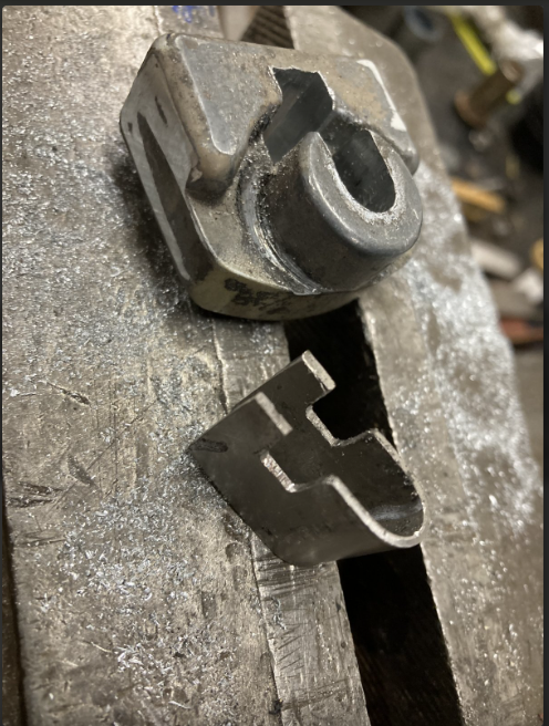

just linking topics; here is a good solution when you catch a bit earlier then when @Dick Steinkamp found out: insert a steel sleeve
and some tips here:

Is there a DIY for the E3 torsion bar like the E9? The "L" brackets on the E9 do not exist on the E3 so you cannot torque them to position, keep them in position like a mousetrap and then install. I ended up using a small C-clamp to slowly rotate the ends into place. Sadly, the ends are a bit distorted after 6 years so the hood stays up but a slight wind in the right direction and it comes down.
Fritzie's fix is a good one and looks easier for the E3 also. Gonna give it a try when it thaws out around here. Fritzie what gauge steel is that?
