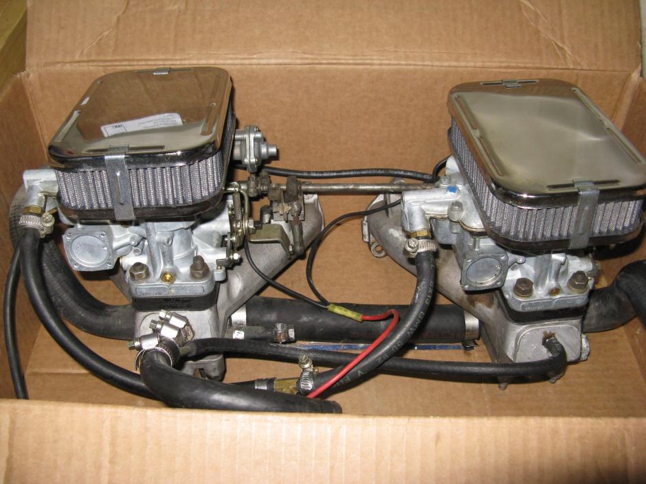

interested in this linkage for the brake vaccum
have you noticed that apart from the primary vacuum from the front carb (manifold, yeah) there is a secondary vacuum taken from the rear carb that is added to the vacuum tube ?
any thoughts ? improve braking ?

In the US, the connection on the right carb and a corresponding connection on the left carb would have been for a SS EGR ( exhaust gas recirculation) system. ( Pollution control)
Yours- if that line connects after the brake check valve ( hard to see in the picture ) it would hurt both braking and the rear carb operation. It also makes it impossible to balance the carbs independently.
Mine- the right carb tap is plugged. There is no secondary vacumn line or tap other than the front carb/ manifold connection.

ok, thanks !
