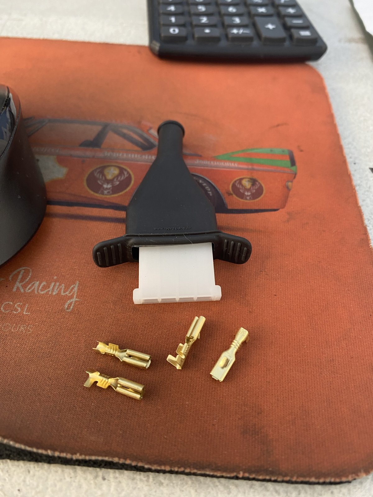

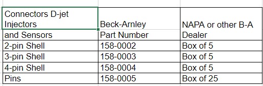

Are the connectors used in Bosch D-jet fuel injection available from anyone? I’m looking for the 4-wire connector to the MAP (or MPS) sensor. Thanks.

Volvo uses the same connectors, and since they don't have BMW stamped on them (either literally or figuratively) they are about 50% the cost of what you would pay via a BMW supplier.

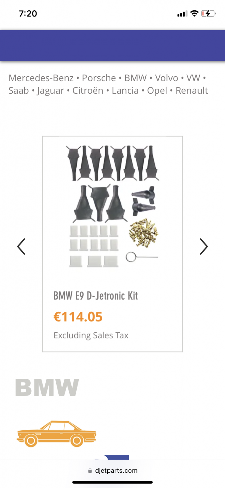

E9 specific kits are available for a reasonable price from suppliers in Europe.
Be aware- real Bosch boots are 36.00 EACH.
