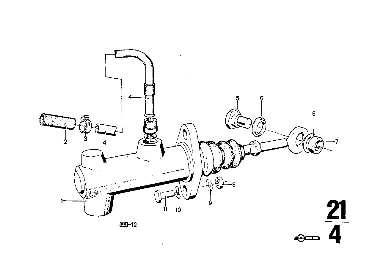

My master cylinder started leaking, I preemptively purchased a rebuild kit so I intend to do that in the near future. Question is the kit does not come with the rubber piece that fits into the top of the cylinder and seals around the input pipe. Nor does RealOEM show a part # for it (where pipe #4 fits into the cylinder in the picture below.) I can just leave it alone as it's not leaking there but figured I'd ask if that part is available before I work on it.

I have bought those in the past but after a quick look, can't find any You could buy the rebuild kit for a 75 530i RM European has them $7.78 ea and that kit has them
But if yours was not leaking, you could try and use it over but once moved, it will probably leak Put the grommet and pipe into the M/C before installing it into the car, much easier

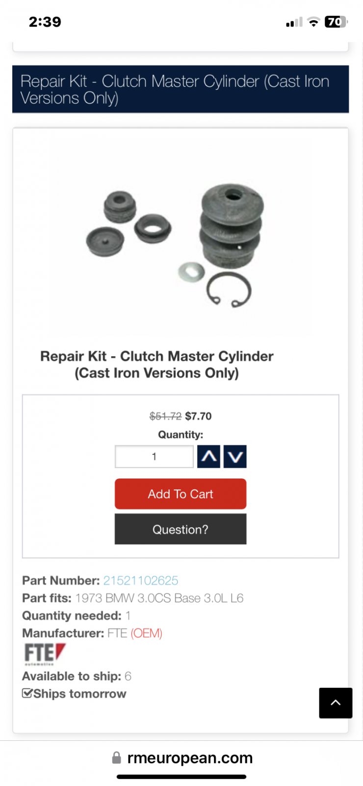

FTErebuild kit purchased from RM Euro included it. The have them in stock.

thanks- those are the kits I ordered (from another site) but none had it when it showed up - not sure if they fall out of the crappy boxes they put them in or what (first kit I ordered was missing a few pieces.) For $8 maybe i'll try one of these and see if I hit the lottery - if you guys have used it has the rebuild held up OK? I think there was some debate on a thread I came across last night.
