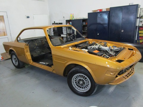

Meanwhile, I got an answer from the painter about the 2 variants of Ceylon:
There is the original color Ceylon metallic as it has been used from 04/1971 until 10/1973 (before it was replaced by Sienabrown metallic after the facelift).
There is also a brighter Ceylon than the original color. This variant is used when only single parts of a car have to be painted like fenders, trunk lid etc. Ceylon becomes brighter over the years and consequently, the brighter Ceylon is used to get it closer to the rest of the car.
I attached pictures of my CSi with the new painting in original Ceylon.
