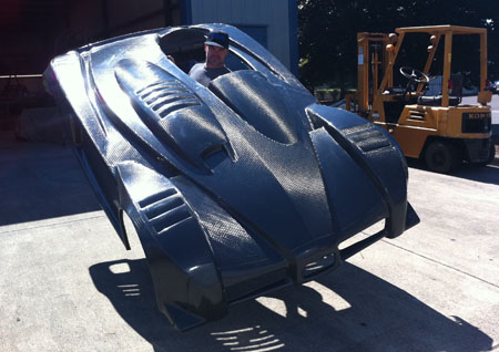

There is a company in oregon that does amazing modeling, mold making, and glass work. I believe that most of their cars are fiberglass, but the mold process is the same and they do carbon bodies also (see pic). They make the most incredible "spank all of the competition" AWD racecars. I have been following their progress since "DP1" was just a 3D model. After a few years of competitive racing, they are already on the podium at pikes peak. Sadly I can't imagine that they have any capacity for a handful of e9 hoods. They may have a good contact though...
If you want to geek out for 8 hours, read through their website:
www.dpcars.net
30lbs... Looks like Stohr / Dauntless racing did the fiber body for them using the DP mold.
