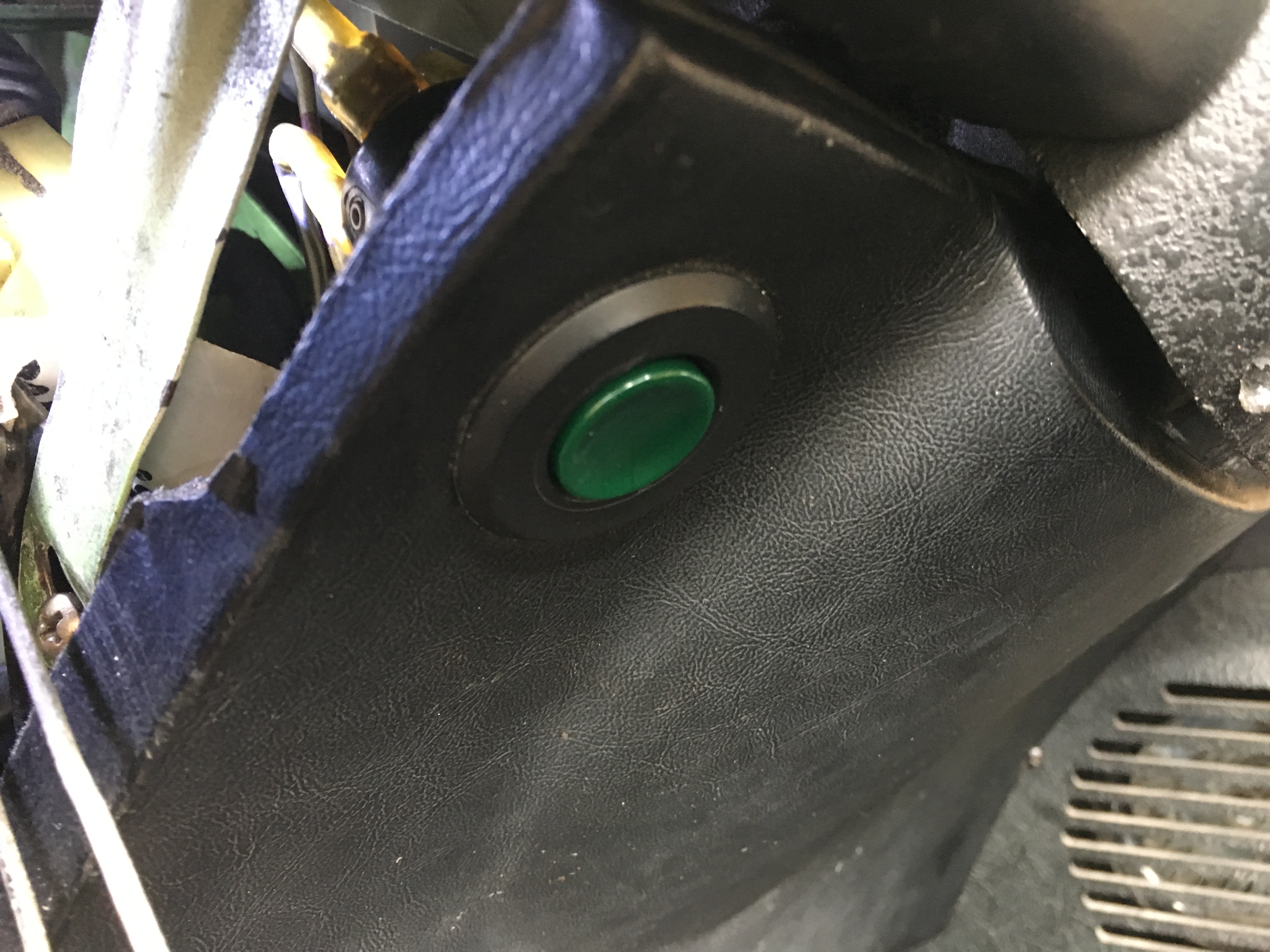

I've got my dash open so and have factory rear fog and a green button. Will look tomorrow.

there was only a factory switch for the rear fog lite - its green (like the amber rear window defroster switch).
