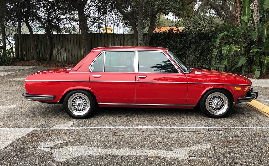

I had a set of RS wheels made for the e3 in the same dimensions as my set of Alpinas. They're 16x7 - ET 11 up front and 16x8 ET 24 in the rear. Tire sizes are 205/55 and 225/50. The rear is lowered +/- 1" and the front +/- 1.5" with adjustable struts. Other than being careful at steep driveway approaches with near full lock, I have no clearance issues.
Addendum...The wheels were made up by Paul Ehrlich. I was very pleased with the entire process and the final product. He's a perfectionist.
