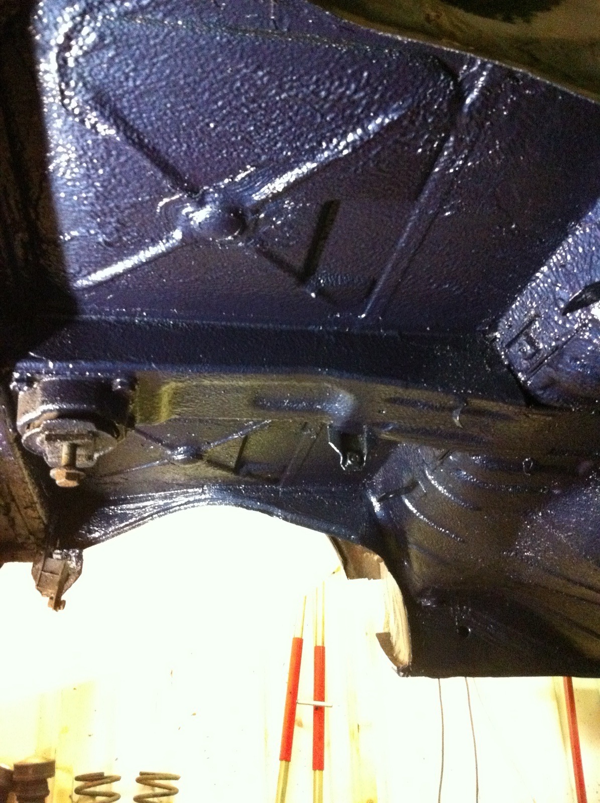

I wonder if they're painting straight onto the undercoating or is the undercoat new and "tinted" baikal.
I know you can color-match truck bedliner, but bedliner usually don't look THIS THICK.
ACtC-3eH5wj-1-FXswifzTVHaO2hKPspaENB1tpbxypPwq6_4o4iRXoGOYw5lQ8Aj_QpqRyyPHAesvVWOg-N8IhksF4SE1UfZ-nQMemfU9x3NdmbvIYya1lJc-lCS3YzA4kw3WsQUuThuGUNg5_0dipBs-X8TQ=w1251-h831-no
My guy used a substance similar to CT1 (maybe UK product only) but mixed it with paint. To save on paint he used some Alpina paint we'd bought which was slightly the wrong shade, and it was applied by spray. It's very tough but slightly flexible and stay on the car. The image shows the similarity.

The old stuff is usually so trashed that cleaning it to receive paint, would cause most to be removed. need a thick coat to hide all the irregularity from this. I vote removed original and redone.
