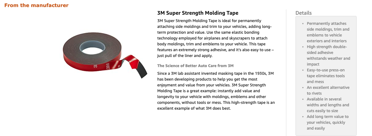

It seems like the strips on the spare I have that I pictured had adhesive on both sides like you are describing.
3M moulding/emblem tape would probably work, but you would never get the back panel off again if you needed to...
