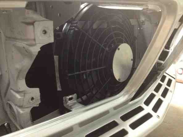

I have just gone electric, with a full re cored / re built twin core rad as per the standard, I'm not sure the brand of fan I'm using, will get some pics for you soon, bought the fan on line from summit racing.
No real need for a triple core down here, doesn't really get hotter than 30 deg C on a real hot day in the hight of summer

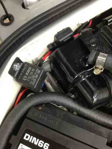

I wired it using a relay and fuse straight to the battery, the relay being switched by a new temp switch up in the thermostat housing, 90 -95 deg switching.

Hi Nicad, sorry I can't tell you yet as the car is still not on the road, I'm still about 2 months away from a drive.
In my mind it can't but not work, it's a bigger more efficient fan than standard, so it has to work.
I'm not 100% happy with my install of this to be honest, with a bit more fore thought I could have mounted the fan closer to the radiator and eliminated the mounting straps running behind the fan, however I'm in a hurry to get the car finished before summer and am still confident that it will all work ok anyway, suffice to say there's room for improvement if needed.
