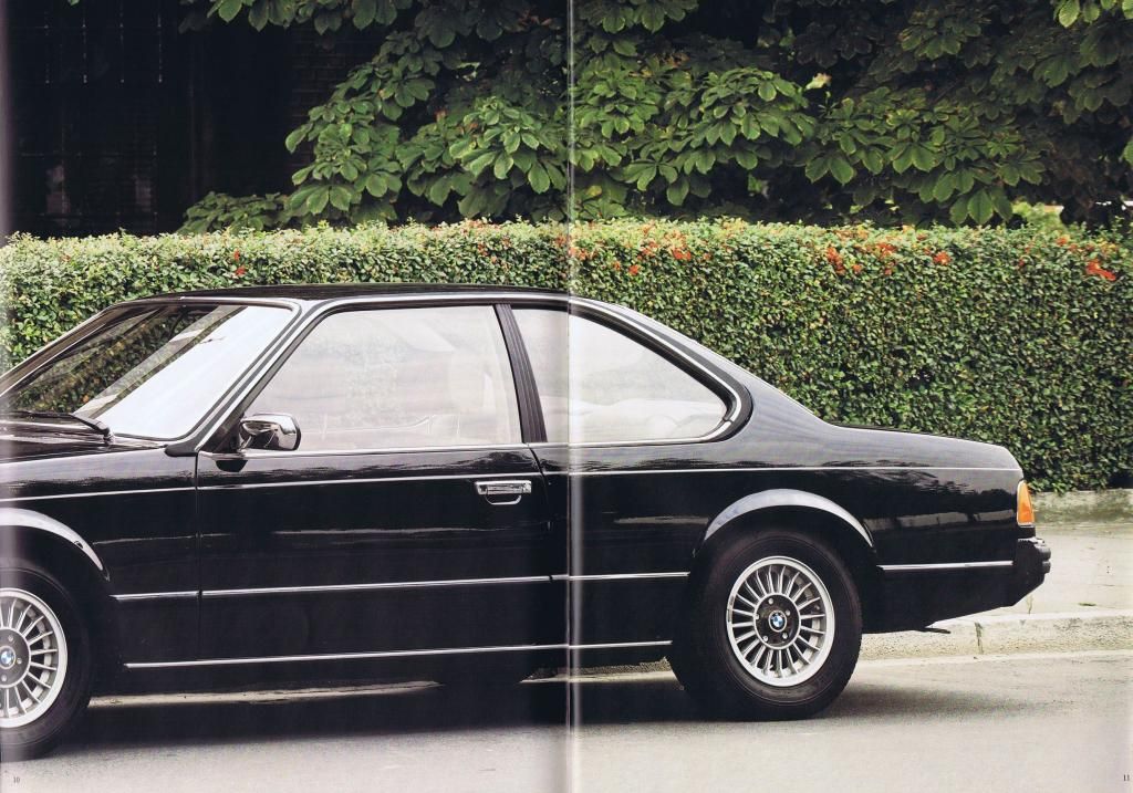

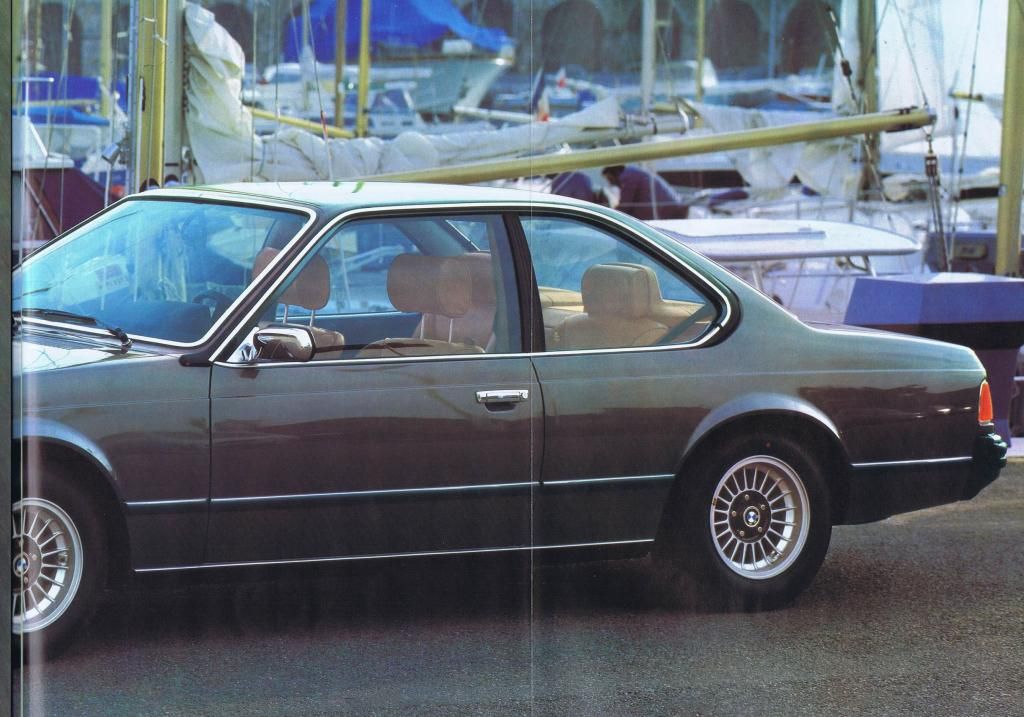

Original BMW brochure shows 2 of the rims in question.
Late 1976 brochure pic shows the carryover 6x14" turbine rims from the E9/E3.
The "ribbed" turbine rims were introduced around 1978/79 for the E12/E23/E24 cars. This photo is from a 1978 6 series brochure.
