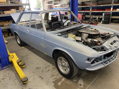

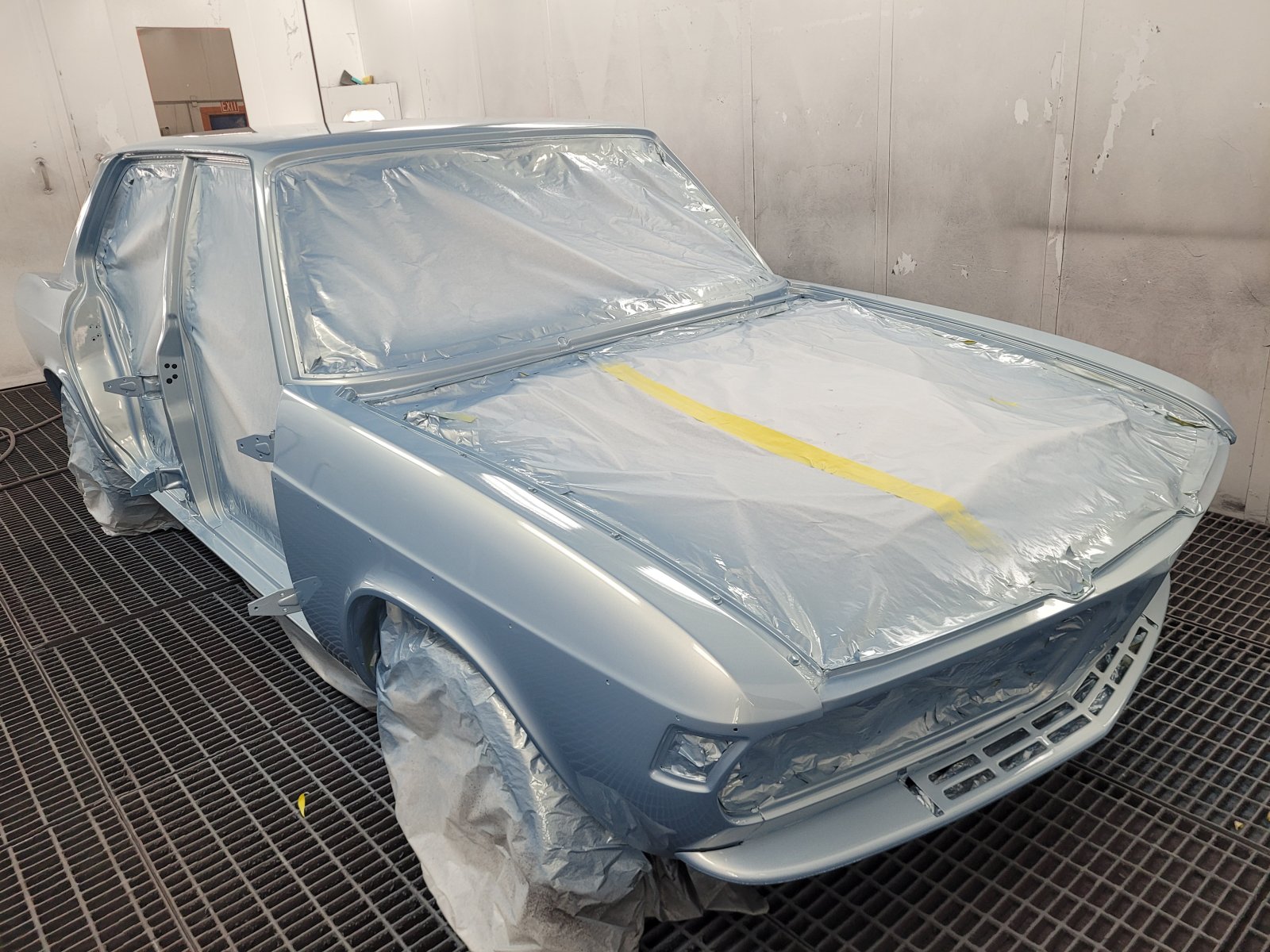

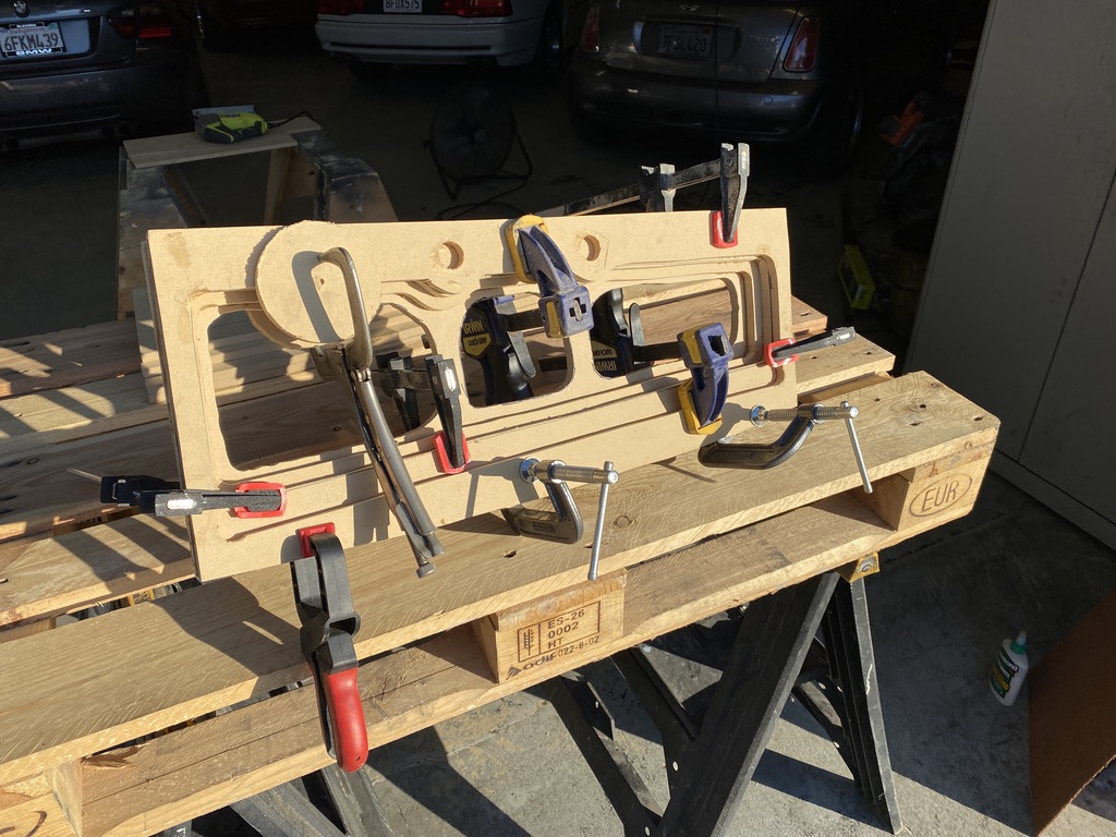

1973 3.0s nearing the finish line. My daughter’s car and she has been doing a good amount of work on it.

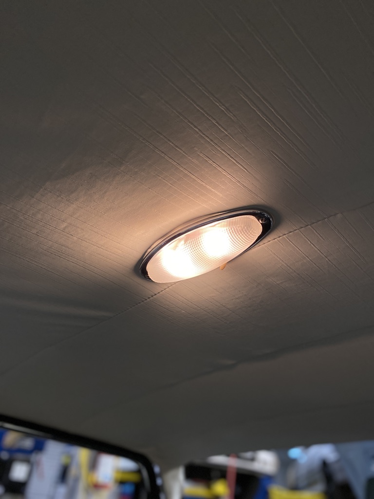

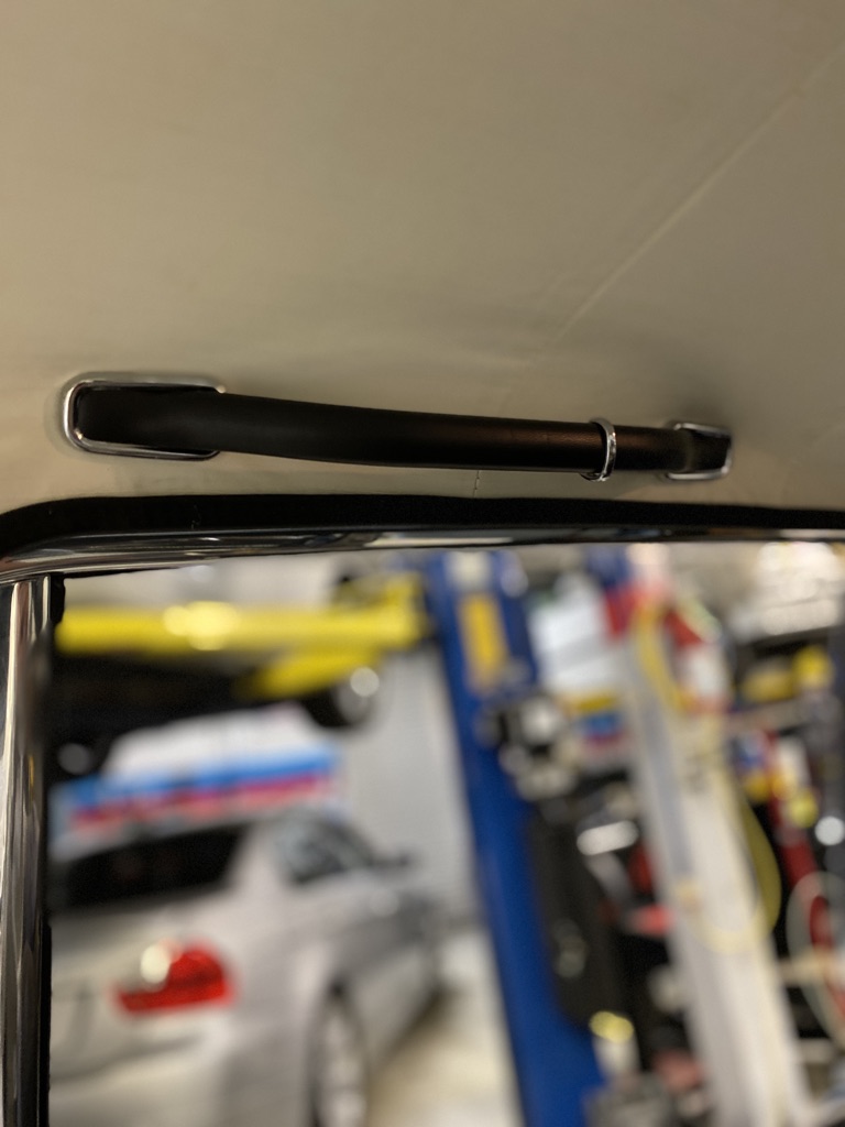

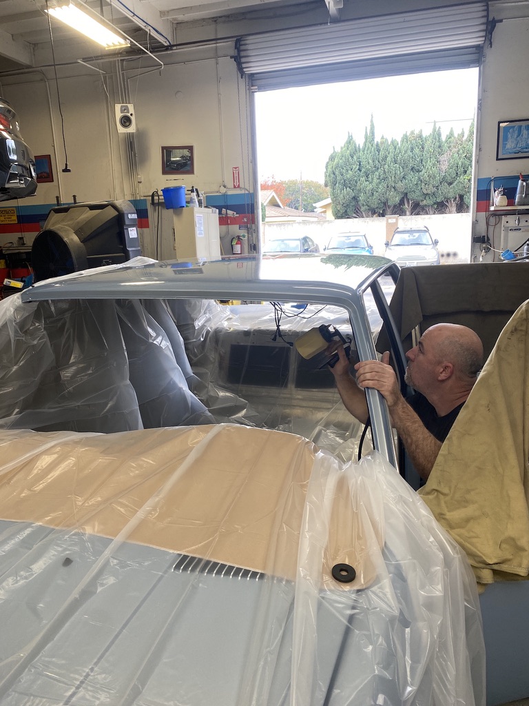

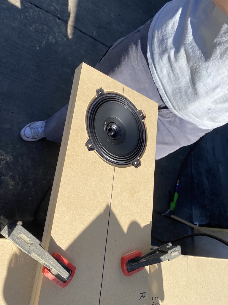

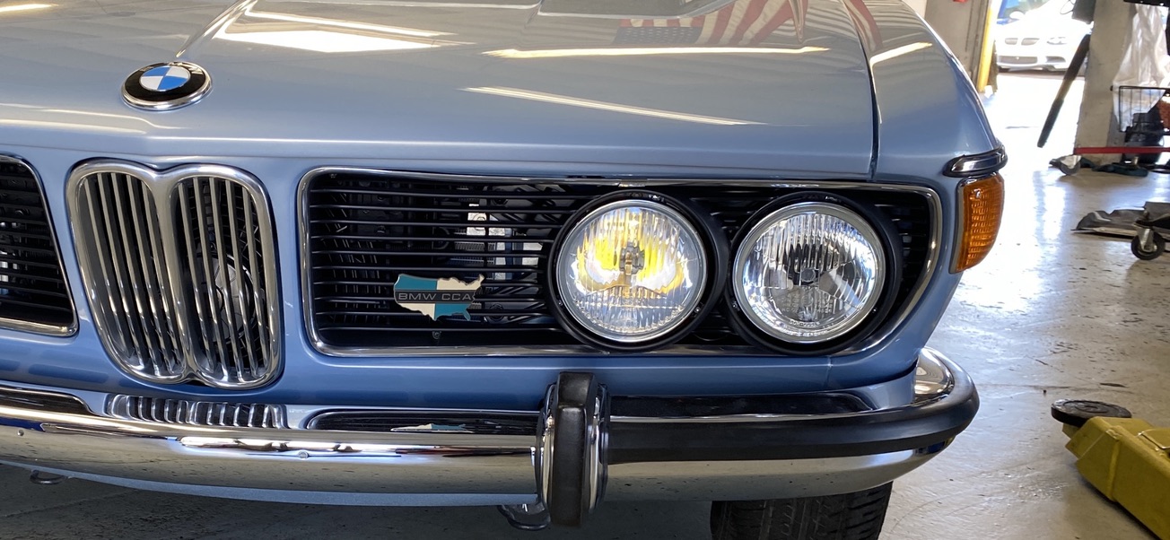

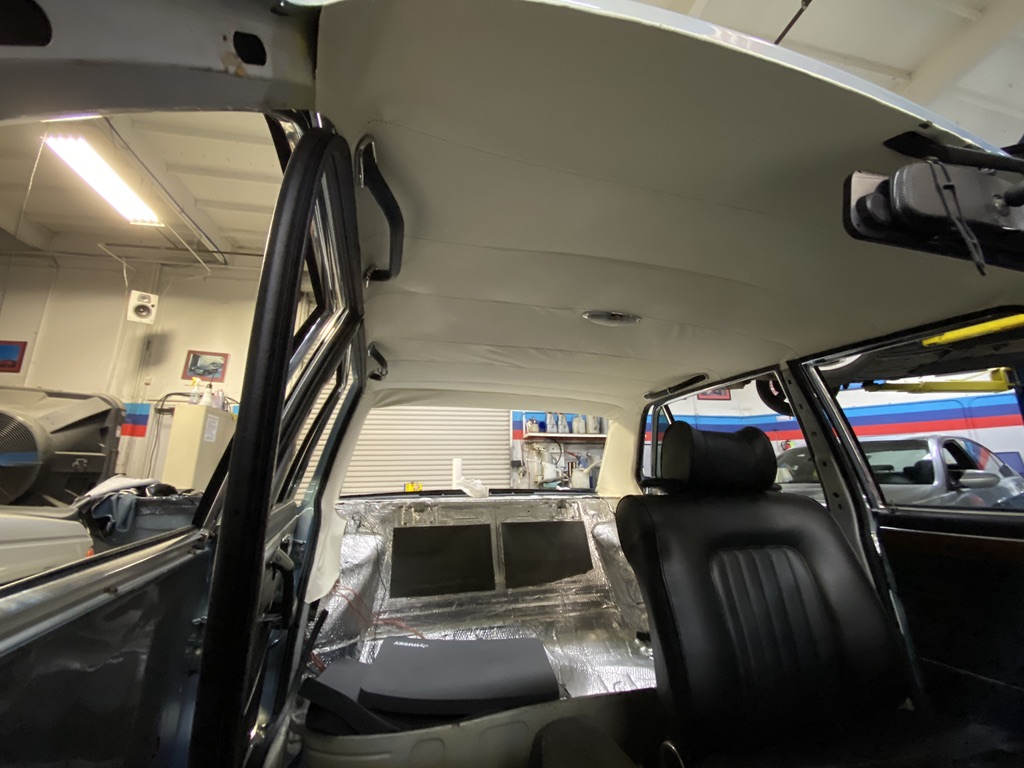

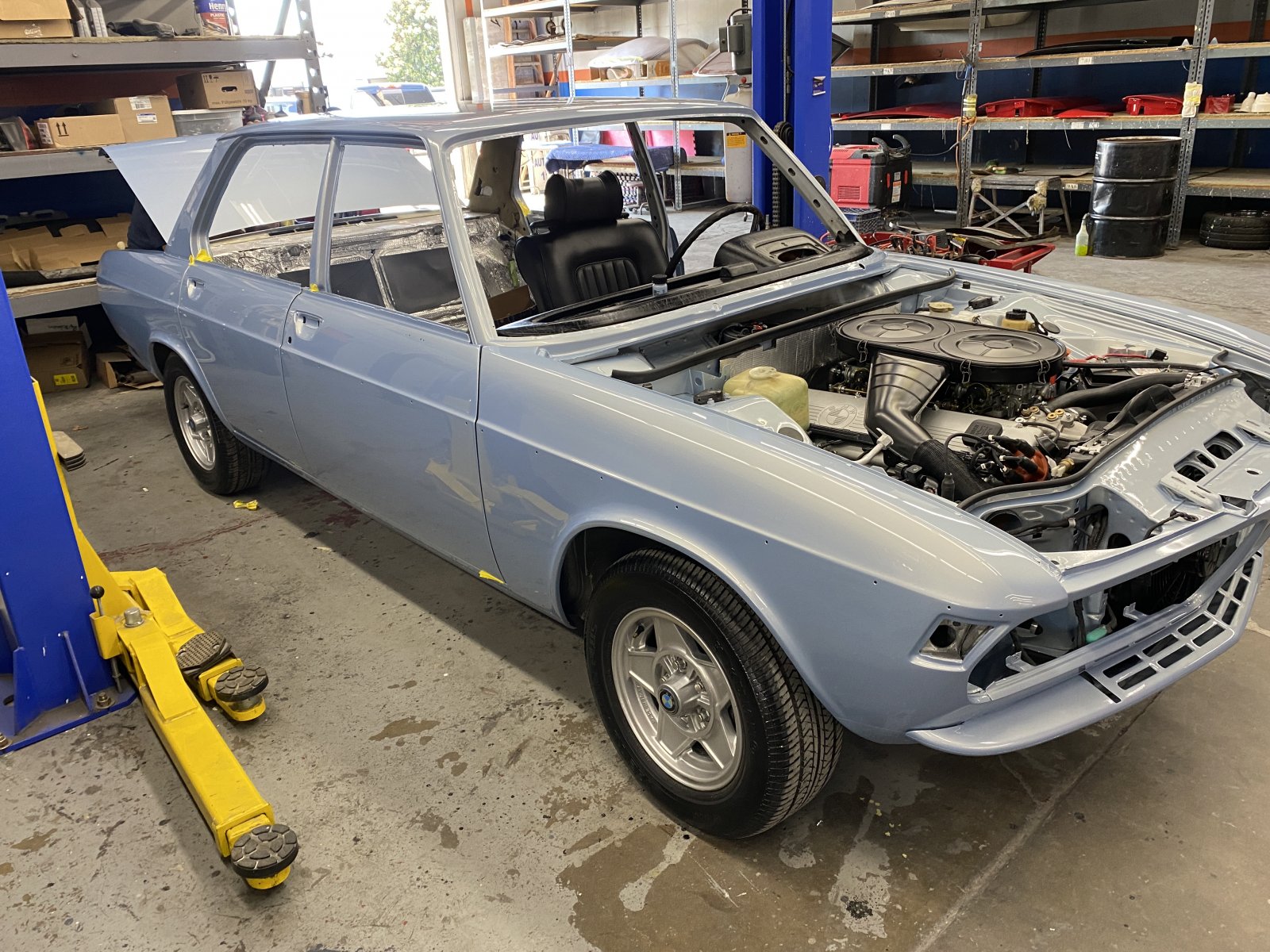

Last weekends work; we Installed headlining, Carpet, windshield.
Overall list of upgrades (tasteful) besides fuel restoration and color change;
Engine- B35, twin Webbers.
Trans- 265 5 speed.
Vented front brakes.
All new suspension; early E12 spindles new struts front and rear, new springs(m535), E12 sway bars.
New Sanki compressor, Spal condenser fan(2 speed).
LED headlights/taillights
Sound deadening throughout
Antenna mast, US side parking lights delete.
Euro bumper brakets and rear over riders delete.

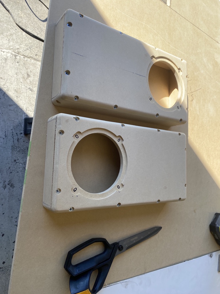

Retrosound radio with Audison 5-1/4 coax rear(custom enclosure), 5 1/4 component front(custom enclosures replace door pockets), will have Sub under rear seats.
Backup/forward cameras(mirror kit)
Nardi Classic Sport wheel
Rewired for left side turn signal/high beam switch.
Rewired for new late style master window switch.
e12 window felts
e30 door inner door seals.
rblongboarder

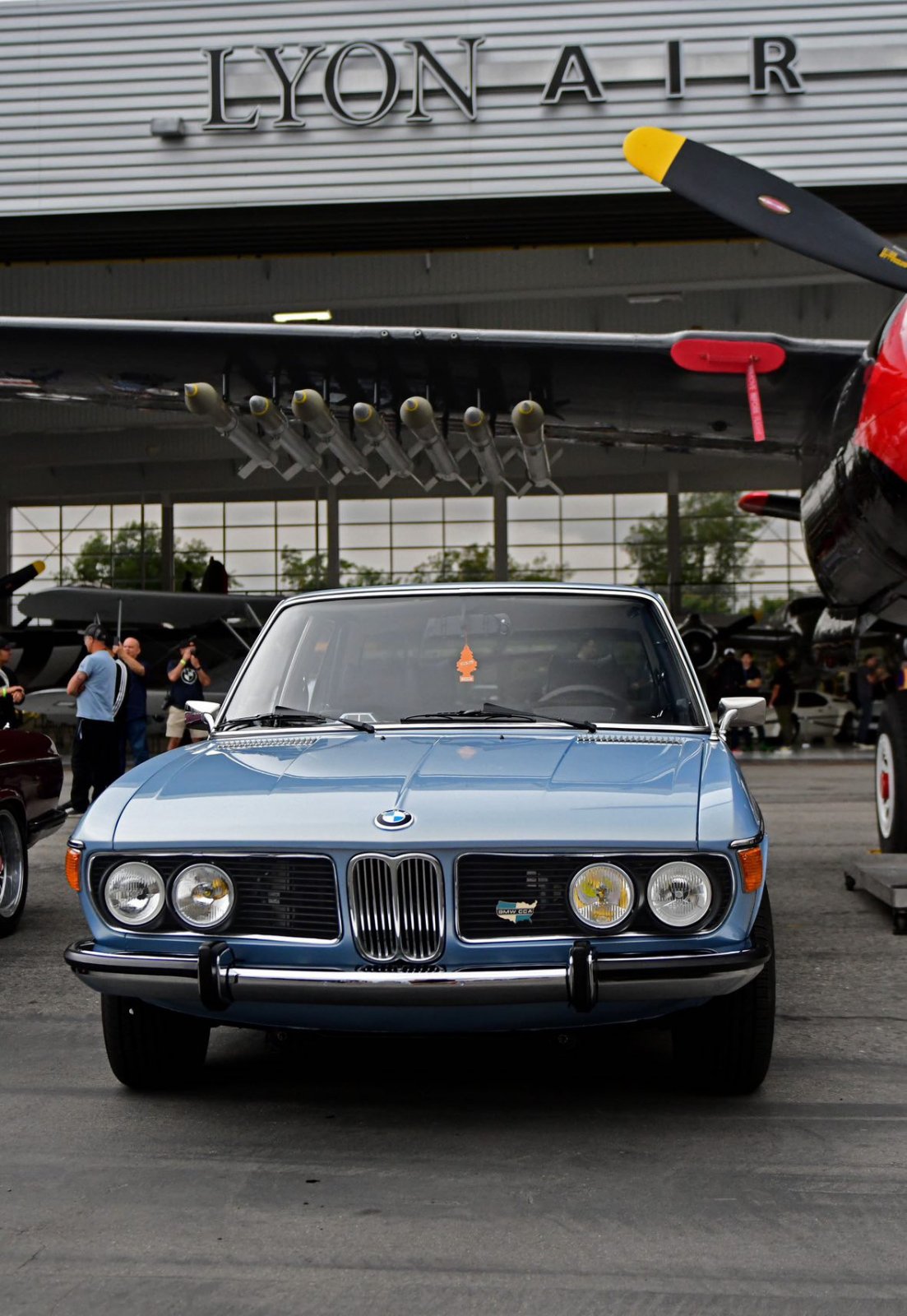

Aha!
I remember talking with you at the Vintage show held at Woodley Park in Van Nuys. The paint was a beautiful white / silver / blue combination. I was so intrigued by your fender modifications, I took a photo:

Thanks! We had fun at Woodly as well as HB & SA airport.
