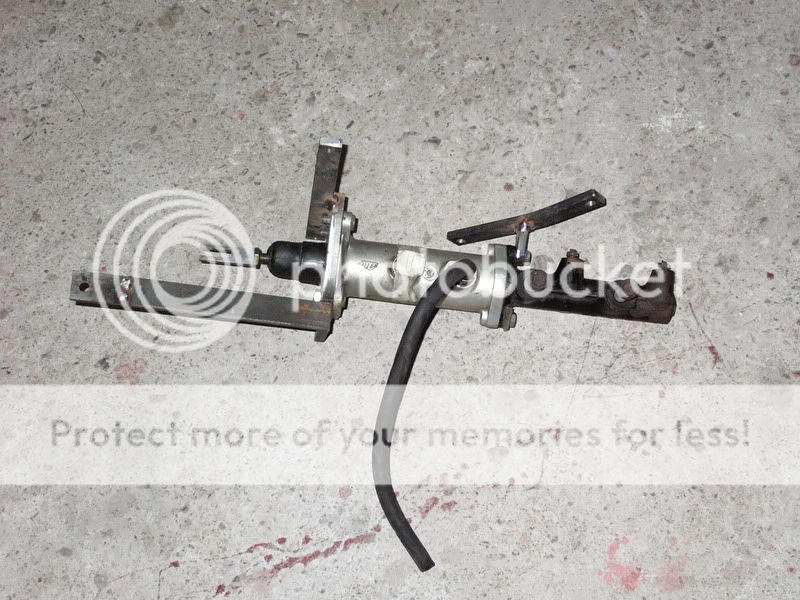

In response to the power steering and power brake issues. The 745 uses a steering box but I don't know if it will fit the E9 subframe like wise with the E28 one, if you can't get and E9 power steering box an E12 one will bolt straight up. You will however have an issue with the lenght of the steering column shaft, it will be too long and will need to be cut down, I'm not sure by how much but others on the board will know as they have gone the opposite way and fitted non assisted steering boxes to assisted cars (for purity of feel) and had to lengthen their steering columns.
Fitting the power brakes system will be considerably easier on a left hand drive car than it was for me (right hand drive) but it won't be a walk in the park. The reason for this is that there isn't enough room on the bulkhead (firewall) for the hydraulic booster to bolt right up if you have a manual car, if you stay auto you may be ok but it might still be a problem due to the shape of the firewall where the brake master cylinder bolts up as it isn't flat and the "footprint" of the hydraulic booster is considerably bigger than the original master cylinder. You may be able to over come this by making a new firewall section where everything bolts up as that part it self bolts to the main firewall any way. Another way to do it would be to make a steel plate that the hydraulic booster will bolt up to out of 10 mm ( 3/8 ) thick steel, this will need a hole in the middle which is slightly larger than the diameter of the existing master cylinder. Next take the original master cylinder off the car and after a lot of measuring and careful working out you need to take out the pistons and cut through it with a hacksaw. If when you've done all your working out and cutting you find that you're left with one of the pipe union lugs just grind it back till it's flush with the rest of the cylinder. Next take the cylinder and insert it through the hole in the plate you made earlier and weld the two together. Et voila! You now have something that you can bolt the hydraulic booster too that in turn bolts up to the firewall. All you need to do now is make up a link rod from the pedal to pass through the old master cylinder to the booster. One other thing I would do and did do when I converted mine is once its all in place is make a strong bracket to tie it all to the inner wing (fender) I bolted through where the master cylinder bolts to the booster and you'll have to get a longer bolt.
Take a look at the picture below you'll see what I mean bolted to where the master cylinder and the booster join is a bracket which was bolted to the inner wing just to give it all a bit more rigidity.
