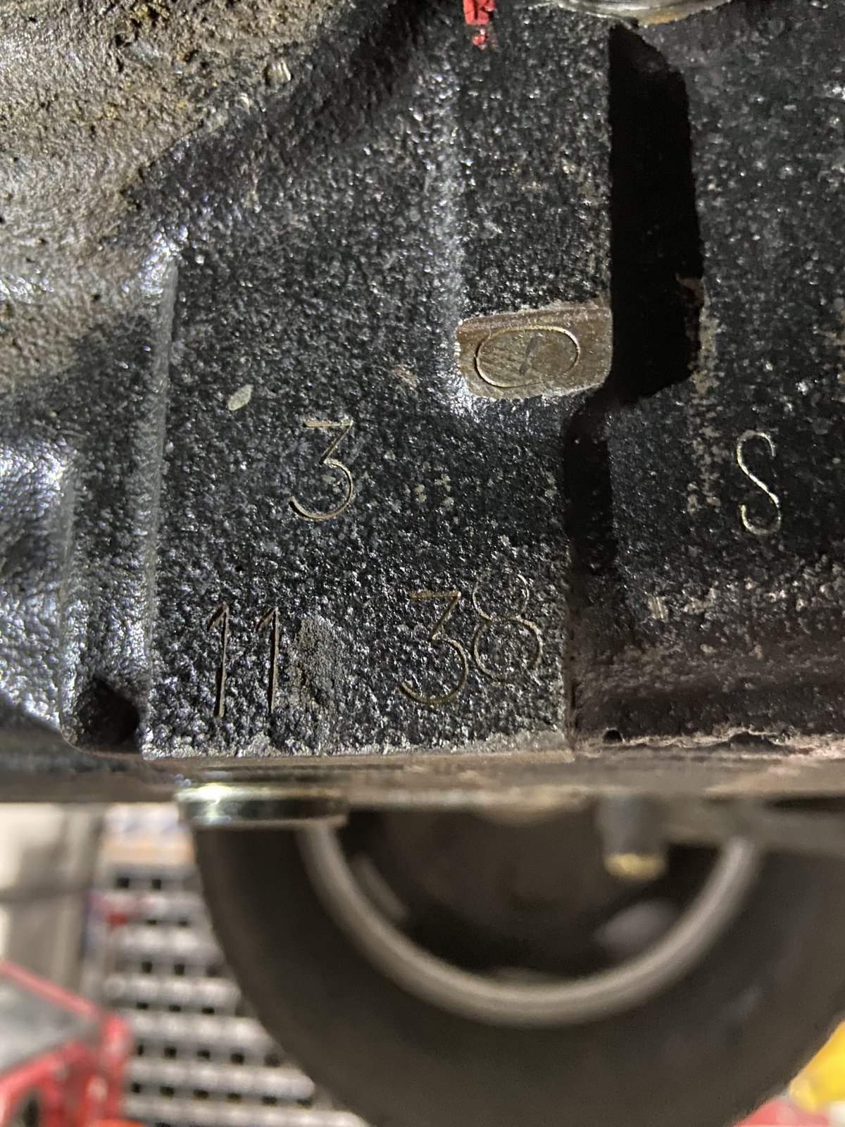

The owners manual for my 1970 2800cs says my car has a ZF Lok-O-Magic disc type limited slip differential. With the car on a lift, if you spin one rear wheel by hand, the opposite rear wheel does not move. Do I have a non functioning slip differential or an open non slip differential? Did all 2800cs’ come from the factory with limited slip differentials? The attached picture shows the numbers on the differential casing. Do they identify what type of differential I have? Thanks for your help. Dale

It might be an LSD with worn parts inside (dog ears/friction discs/tension springs plates).
11:38 = 3.45 ratio = 2800cs
If it was just a working non-LSD diff your opposite wheel should spin other direction while hand spinning of the first one.

My LSD on my 71' did not pass the spin test when I was first inspecting it. It has the S on the housing.

Thanks to everyone for your help. So I have a nonfunctional LSD. The S= LSD. The 11 38 = 1:3.45 ratio = 2800cs. Does anyone know what the 3 stands for or if every 2800cs left the factory with a LSD? The car is on the lift getting other mechanical work done, so I can’t aggravate my neighbor with a burn out. Thanks again, Dale.

If you divide 38 by 11 you get 3:45. This is the ratio of the number of teeth on the pinion gear (11) to the number of teeth on the ring gear (38).
BMW did ship differentials with 0% lockup. If you look inside the top hole, you can see the carrier, but when disassembled, they have spacers instead of clutch plates and they do not lock up. The one I have does not have an S on it.
Again, without a road test, I would not conclude that the one you have is not a limited slip dif.

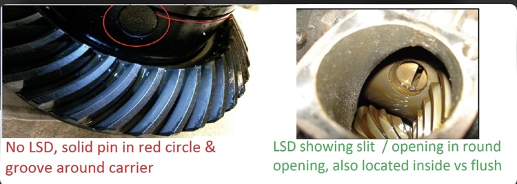

Check this by opening the top mounted aluminium breather plate. I don’t know if you can do that with the differential under your car. Maybe with a mirror?

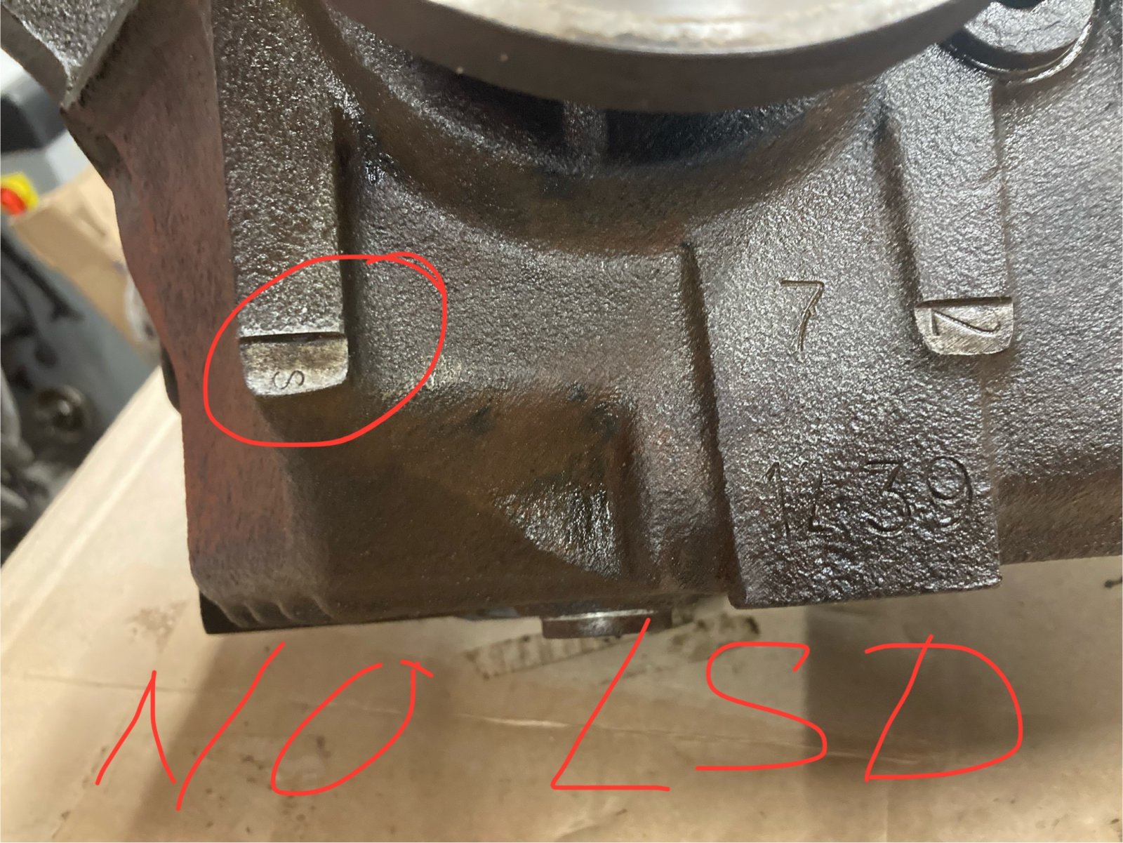

Mine differential has a small “s”, not the big S or painted.

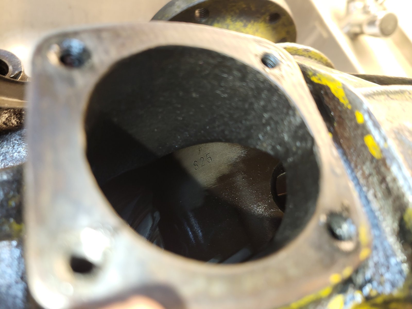

And, in addition to the image above with the green text; if you open the vent cap, you can spin the internals and a sequence of numbers & letters will appear. They indicate how the LSD left the factory (it could have been rebuild, changing the lock % ratio for instance). here's a pic of my LSD unit:
I’d be interested on clarification on this, my diff housing also has the small s stamped in the same place!
Diff is on car so not able to look inside.
