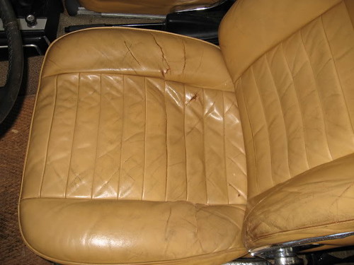

The front seats in my late 1974 have beading on the seat bottom cushions but no beading on the vertical seam near the chrome trim on the seat backs ...
Only 1974 and later have seam near the vertical chrome trim. The 1973 and earlier E9 seats are totally different and have no seam on the seat backs... My seats have the Horizontal pleats...
I have examined numerous photos of 1974 interiors and it is very difficult to tell...
Do any of you E9 experts know or can someone send a photo of the correct 1974-75 seat...

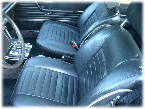

Looking at the carpet and the double seam on the bolsters, it looks original to me for a later coupe- piping on the front edge which makes sense on horizontal pleat. Perhaps others can help...

Interesting driver seat belt in the photo also -- guess that explains what the holes in the wood in my car are for. I thought those might be seat belt related but I talked myself out of the notion once I studied what they were attached to. It's not a real sturdy looking piece.

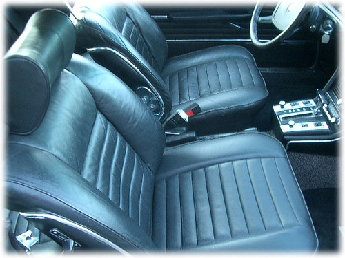

If I'm reading your post correctly, then you are inquiring about the front seatbacks and not the back seats. By looking at the 3 pics I've found, pipings or beadings were not used for the seat backs unlike the seating surfaces which had them. If you were to look closely, pipings are absent from the seatbacks on the two 74 coupes.

Bert you are reading it correctly!
I am trying to see if the front seat backs have beading in the vertical seam near the chrome trim... My upholstery guy noticed that the seat backs were different the the seat bottoms and that only the bottoms had beading... He said this was a mistake... It does make sense that they should be the same!
But I think that he is wrong.
I still cannot see for sure in the photos (even on my 24 inch monitor)if there is beading on the seat backs or not... I can definitely see the beading on the bottoms but the on backs in some photos it looks like a bead and others it looks like just a seam it is hard to tell...
CadillacGreen
244
22
The front seat backs do NOT have piping on them, only the bottom cushions. My original '74 seats show piping around the bottom cushions, but NOT on the seat backs, just like 61porsche's photo shows. The stitching seam does make it look like there might be piping there, but there is NOT piping on the seat back of the front seats

None of original seats on CS's from 1969 through production end had piping on seat backs--piping was only found on the seating surfaces in front and rear but none on the seat backs.

THANKS!!! Now I do not have to take my seats apart!
Thank you guys you saved me a lot hassle and I dont have to take my seats apart!:-D
As I said before it did look strange that the bottoms had piping and the backs did not... All of the period Porsches and MBs I own have piping on both the back and bottom cushions so when my upholstery guy pointed out that the E9 bottom and backs were different and done wrong I figured he was correct!

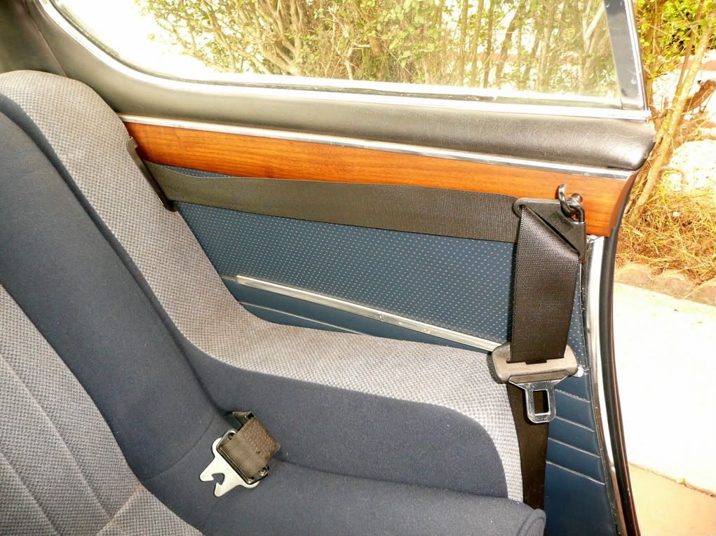

Hi everybody.
I'm also restoring the interior of my 1975 2.5 CS. Thanks to this thread I also know how to re do my seats. The idea is to restore it as close as original as possible.
I have an extra question about the interior of 1974 and later e9s. The door panels are covered with the same material of the seats. Below the armrest the door panels have horizontal seams and above the armrest there are no seams. Is the seamless part of the door panel made of the same material as the seats? I know it is a different material in 1973 and older coupes (looks like some kind of fabric), but maybe for 1974 and 1975 coupes both parts of the door panels are covered with the same material.
If the owners of 1974 and 1975 coupes can post pictures of original door panels (front and rear) it would be much appreciated.

This should be the correct door panel design for the 74 and later coupes. The perforations do not go all the way through the vinyl material though.
