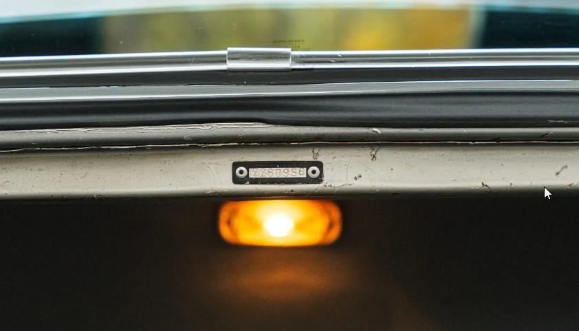

Now back to the car: I personally never seen this: why is there a chassis# plate riveted in the boot? Is it a US thing? I've seen them on steering columns before.
Is this same-same-but-different?

The car was originally imported to Sweden. Sweden, for some reason, requires a VIN plate in the trunk (or rear of car) in addition to whatever else is there. Not sure that comment survived... LOL
Edit to clarify... I found out about the Sweden thing (regarding the rear VIN tag) via one of the comments on the auction. I just carried that here to help with this question.

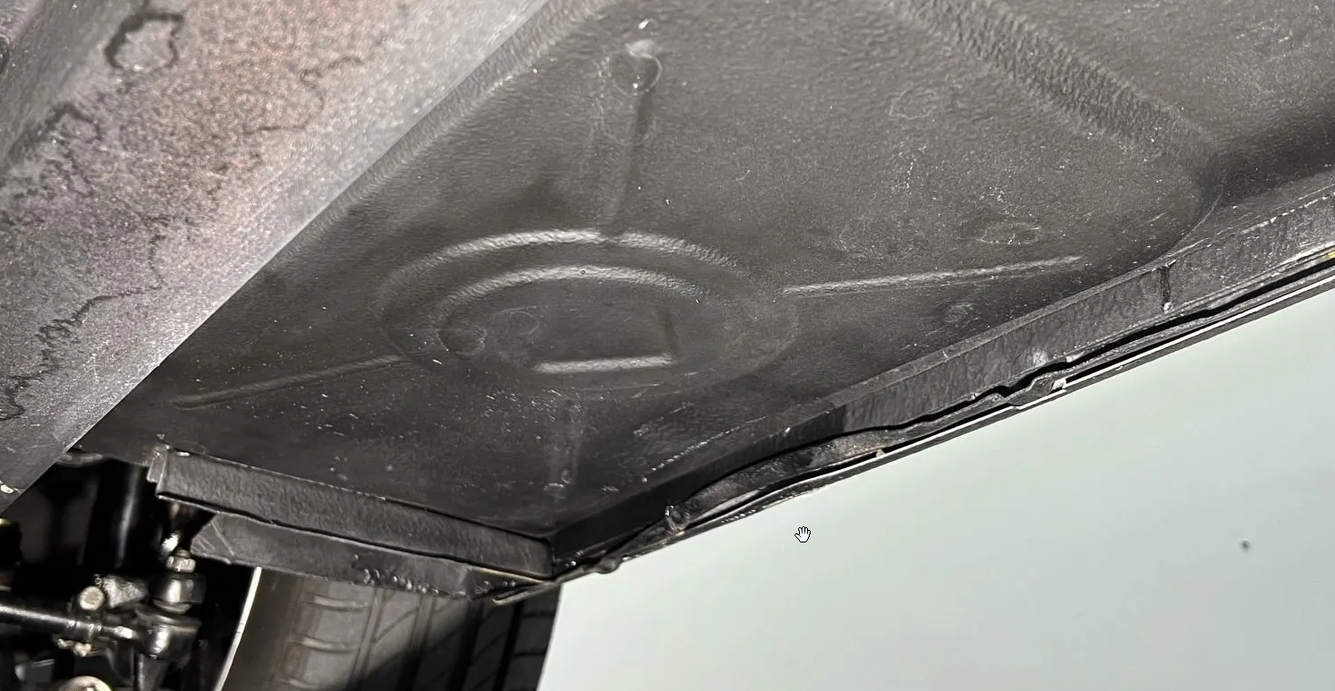

not to downplay the car - I'd be very happy to drive it - While i was flipping through the BaT pics, I found something interesting. A learning point for us all if you will.
While flipping through the photo's I always start with the front fenders, floor and rockers/sills. After all, rust is what makes these cars expensive to fix.
The underside of the car is quite well preserved, I see lovely floors pics coming by, and I see little that worries me there.
And I myself have abaoft spot for virgin sills; I've spend hours chopping into my rust bucket, learning about how it should have looked like / was constructed, and re-create & weld it all back.
So my eye falls on these dents in the sills; I see 'em and go "blimy, how clumsy to lift a car by the 0.8mm thin edge of the rocker. They do NOT know what they are doing".

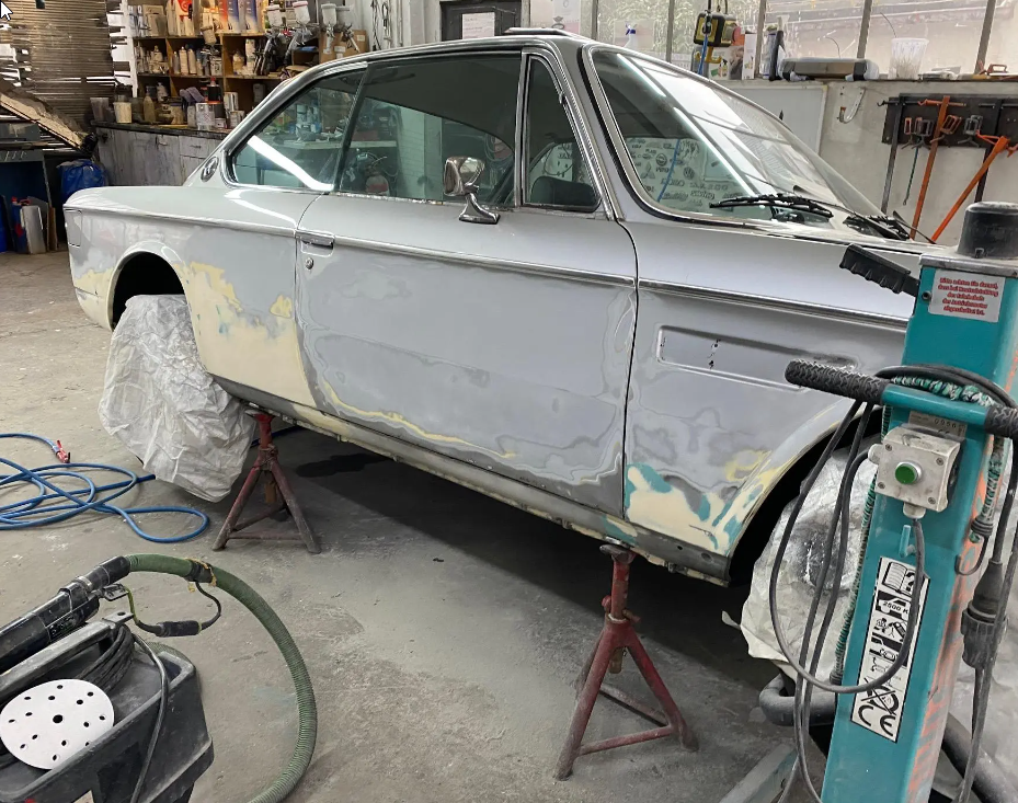

Then the next picture is this: It's the shop where it all took place!
Yes, the jack stands are roughly at the factory lift points. But the points where they contact the body are not where a load can be transmitted without damage!
point to be made here: sad to see a shop create damage.

Thanks @eriknetherlands for asking. Seeing the level of discussion I keep myself quiet. :D
Thanks also to @lip277 for explanation. It is another "Something" which differentiates usual users from Experts in E9 Domain. ;-)

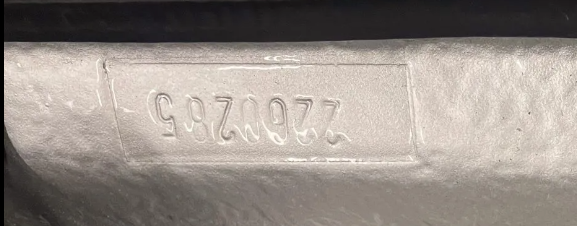

As the emotions are low I would like to touch one topic. It is about Vehicle Number:
What kind of marks should be stamped outside the number? Nothing, cross, asterix... ?
Probably it has been already discussed somewhere but having so big Audience, I'm expecting short answer right away. :D

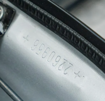

On the firewall and the block pad, the VIN has + on either side
I often find myself nosing through the csl site of Yannick, looking for old pictures of a certain area. I then copy-paste images from 10 or 20 unrestored cars and voila, you have a reference.
No guarantees, but it's a quick way to establish a good starting point.

Thanks Guys!
But does it mean that the numbers on the first picture with missing crosses were renovated too much?
