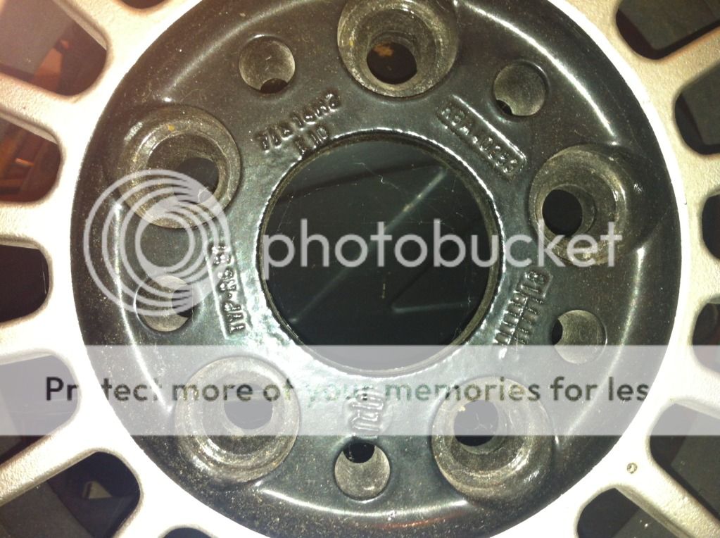

With regard the Alpina 14x7 Rims. I have come across some information that the wheels on the early cars were not stamped Alpina, but had BMW markings instead. Any truth to this? I have a set of 14x7's and they have no distinguishable markings. These particular wheels did not come with my car, I bought them afterwards.

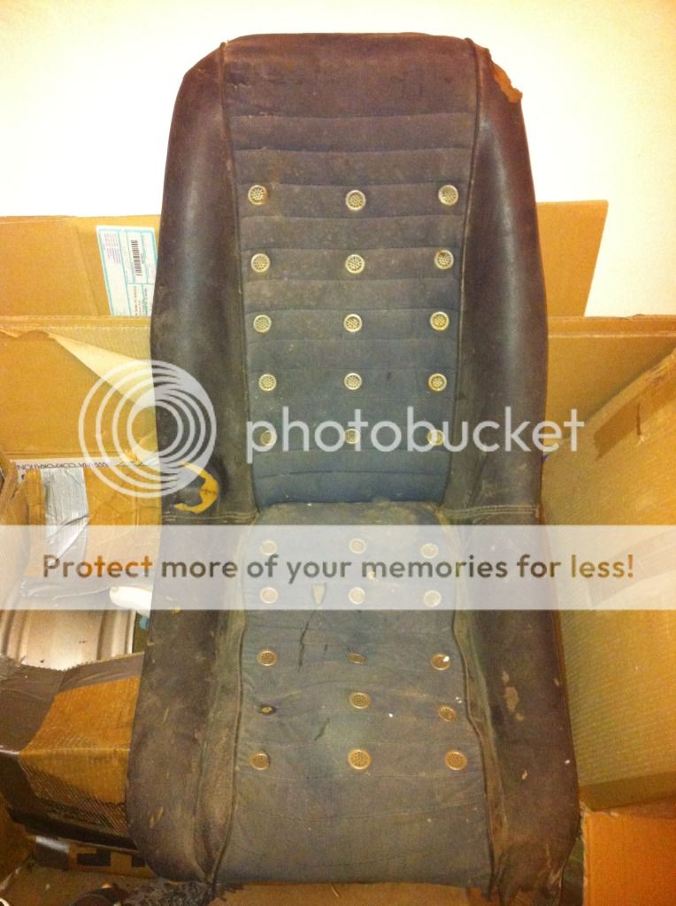

My car came with a Scheel seat in it that differs from most I have seen. As these were never freely available in South Africa, if the car was not fitted with this originally, I can only guess that it was refitted in Europe before the car was exported.

- The rims on the pic are newer ones. Originally on CSL, only with 5 holes (no additional aligment holes). At least on the injection CSLs, they were stamped "Alpina".
- Not the correct Scheels. Shld be Model 100, like this:
