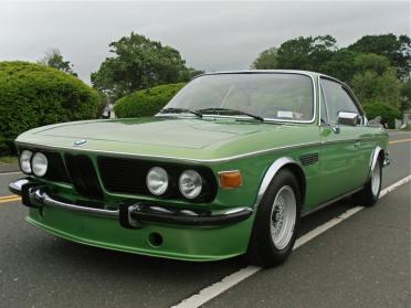

OK, this one hurts to write because there is no way I can see for me to get this one into my garage...
not mine, no affiliation. It is just the car I was looking for, found a few years too late.
1975 Euro 3.0CS Taiga with tan velour interior asking $39k.
Note: I have not personally seen this car. From the photos, the sheetmetal looks good and original, but haven't received any photos from the underside or with the trim removed. Like I said earlier, this car has the color, stance and just enough sporty -Lness to be what I had in mind years ago when I started searching. If someone from this board buys this, you owe me a beer to help me forget this car came up for sale (and even though its a few hours away in CT, I may still have to go take a look).
Here is the link to the seller, Steven, and I see that he has now uploaded the complete set of photos. http://classiccargallery.com/details.php?id=516&g=1 The seller was helpful but not the most knowledgeable of coupes. And, for the record, the VIN is 4300610

Nice car...almost.
Tiaga is growing on me...the color is reminiscent of the 'hot wheels' miniatures. Love the velour.
Suggestions:
  • Take off the poorly sculpted plastic cow catcher / rock-chip and abrasion collector.
  • Trash the 'look at me...I'm stuck in the 80s' rear spoiler (spoiler is the right name, as it truly spoils the line of the car).
  • Remove the 'Renolds Wrap' shiny foil around the wheel arches. Re-purpose in kitchen.
The E9 has an economy of line, carefully conceived and artfully executed. Impossible to improve upon. No need for anyone else to come along and try to play car designer and 'improve' on one of the world's best designed objects. Be subtractive and simplify. Do less.
If I didn't already have one, I would make this one mine. Love the color, and always liked the cars that have the manual front windows.
I would probably also delete the spoiler, and would also fix the speaker placement unless the sound they produce is surprisingly good.
keep it the way it is...
Taiga cars can handle the "bling" and it's a Euro car- great velour seats and roll up windows! I wouldn't change a thing.

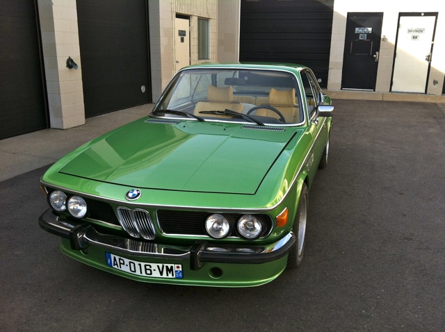

If you drive up to that at the local morning car meet you're sure to make them spill their coffee and donuts. Love those exotic 70's colors.

All original and expensive CSL aerodynamic parts made and issued by BMW. Personally, don't mind that look at all, with the exception of the blacked out kidney and headlight grills.
Granted the rear spoiler is not everyone's taste. In fact I prefer the clean lines without it.
But this car is very very nice looking and if it runs as well as it looks, it would be worth the asking price. I agree with Bert, go back to the aluminum trim on the front grills and the outer part of the kidney grill and I would stop there. If only I could convince my wife that The Great White needs a friend!
Say, are those black acorn nuts on the valve cover?!?
Picking Nits?
Euro car - no sunroof, right?
Why is there an driver front window electric switch when the passenger front window is manual (see the pic showing the center console)?
Trunk gasket looks odd where it is getting pinched by the trunk lid hinges
Overall repaint looks pretty good
Screwed in kick panel trim not very pretty
where's the Karman tag in the door jamb?
Door speaker location is terrible for making good audio.
