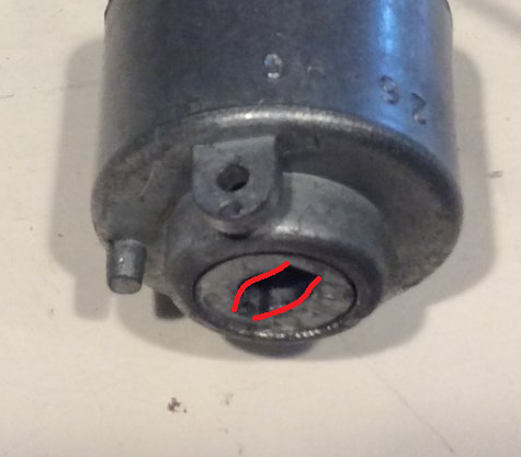

When I have situations like this I plug the switch into the harness with out the tumbler, like in your photo, then use the key or a screwdriver to turn it. You have a much better feel for whether it's contacts that way. After that, I jump the wires on the back to see if that works. If it does it's the contacts in the switch.
JMinNJ
406
105
New Jersey
Well I pulled the ignition switch from the key/tumbler of the steering column. I actuated the switch with a screw driver and it works fine. Actuated the starter as it should. So it seems to be the key/tumbler is not turning the switch far enough to engage the starter. Key rotates fine and i can feel the little spring at the end that should actuate the starter but no go. The tumbler needs to rotate another fraction of an inch. I made sure that the switch is in the tumbler securely and not moving when the key is turned.
I suspect I need a new tumbler and key?
Seems like it could be a bear to replace.
duct-tape
341
72
Atlanta, GA
The slot that the tumbler fits into to turn the switch, your may just have a little slop in it from wear. you may want to try a shim, like this?
