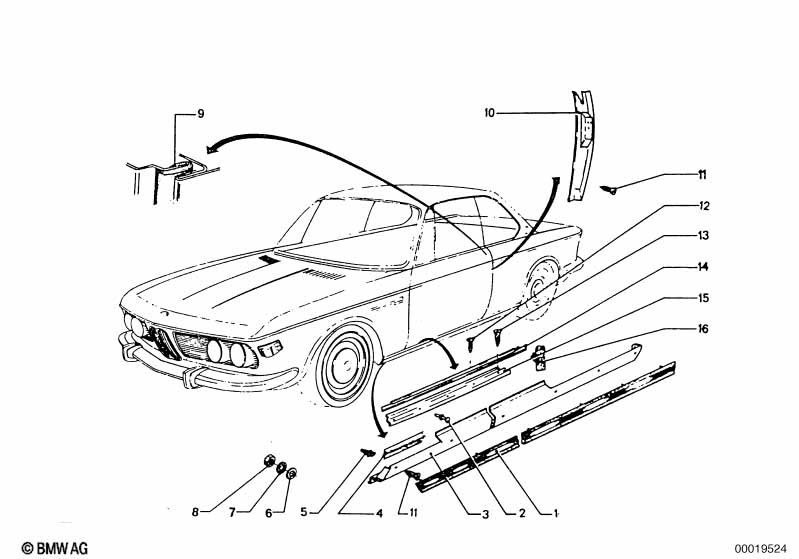

i'm looking for the rubber seal that goes between the B pillar coverplate and the rear quarter panel. its hard to identify from realoem - 51/14 - #10 ... i presume that seal #9 is what i need, i just would like to know for sure. my body guy wants to replace these pieces of rubber as they will probably turn to powder when he removes them.

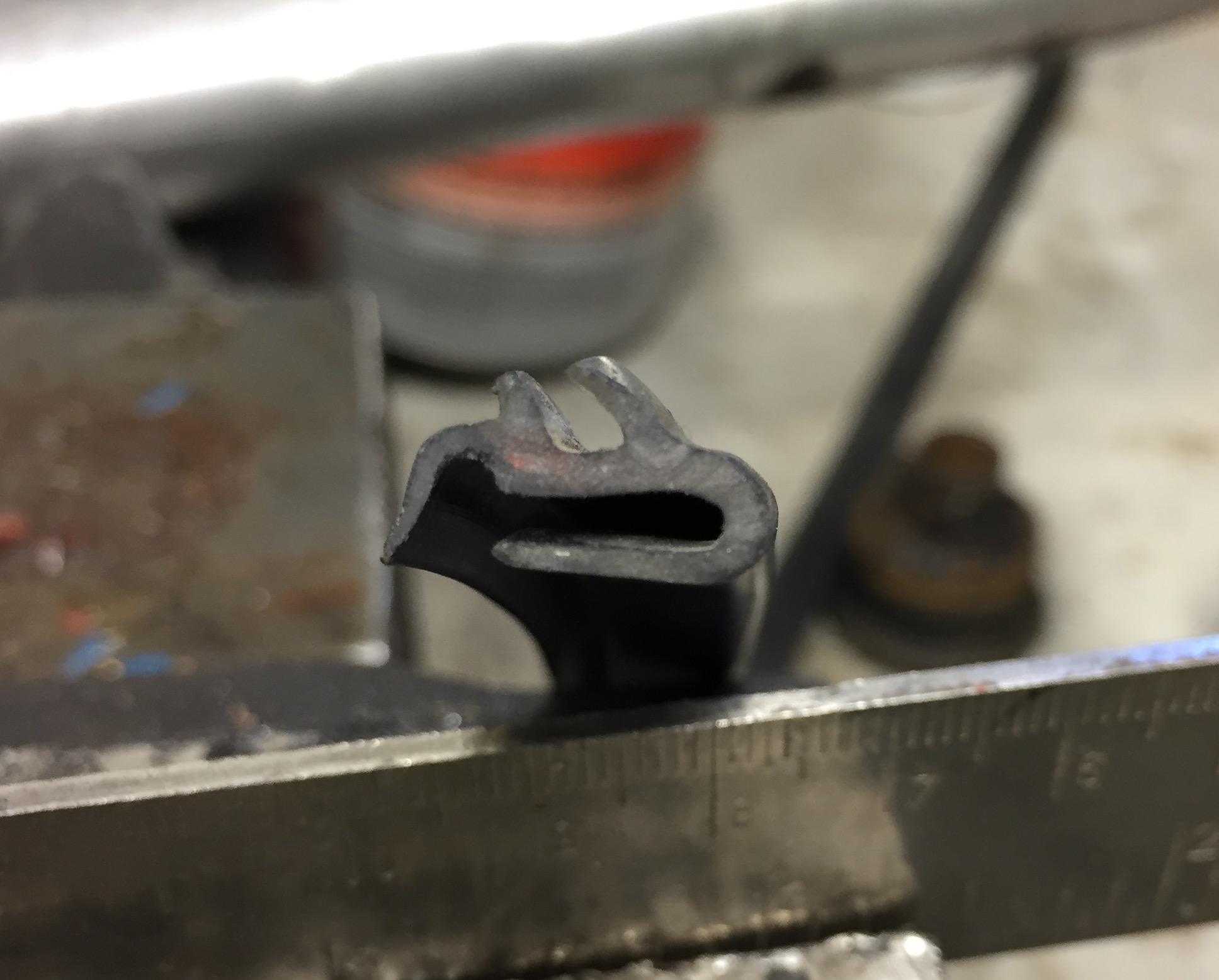

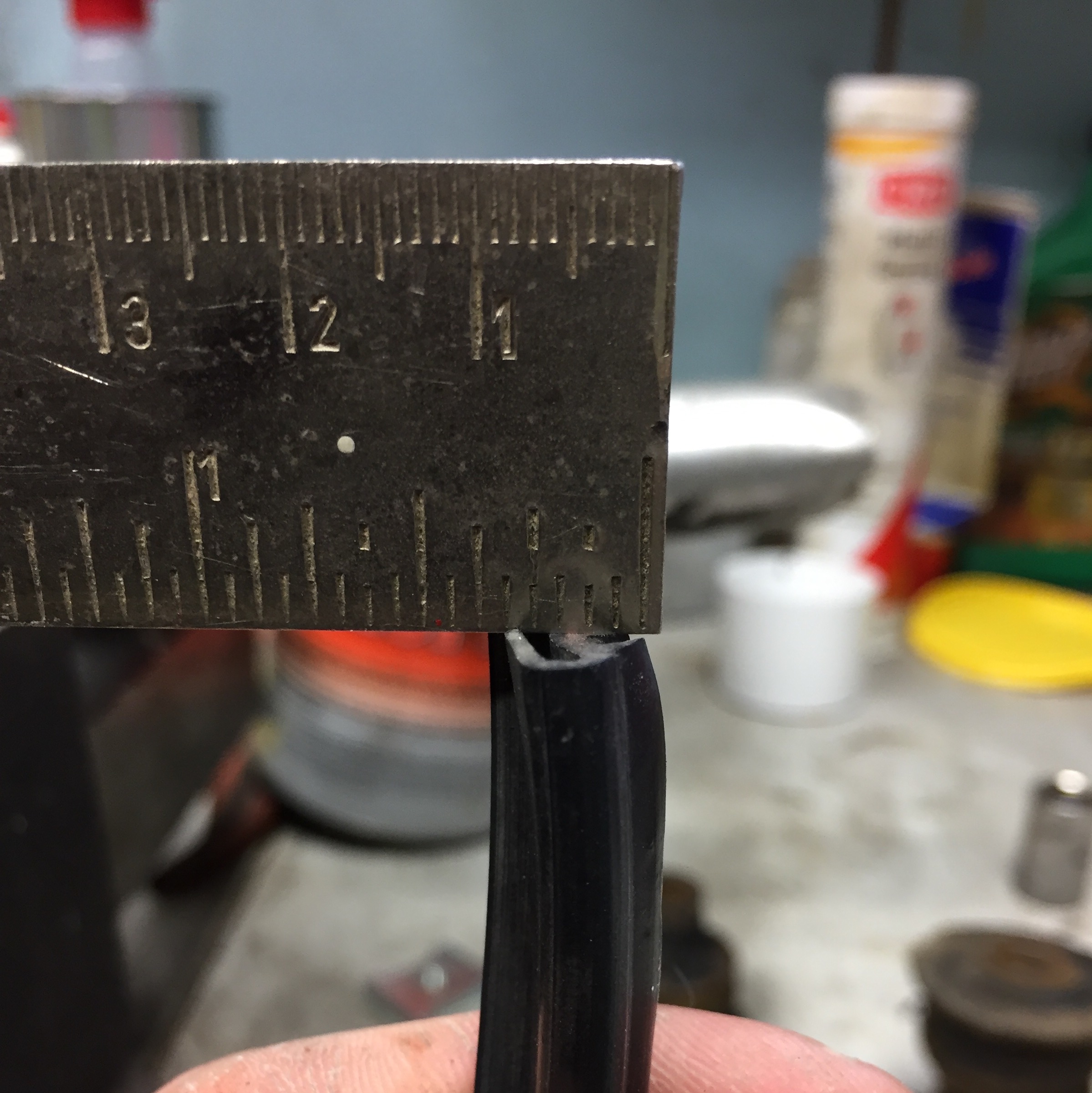

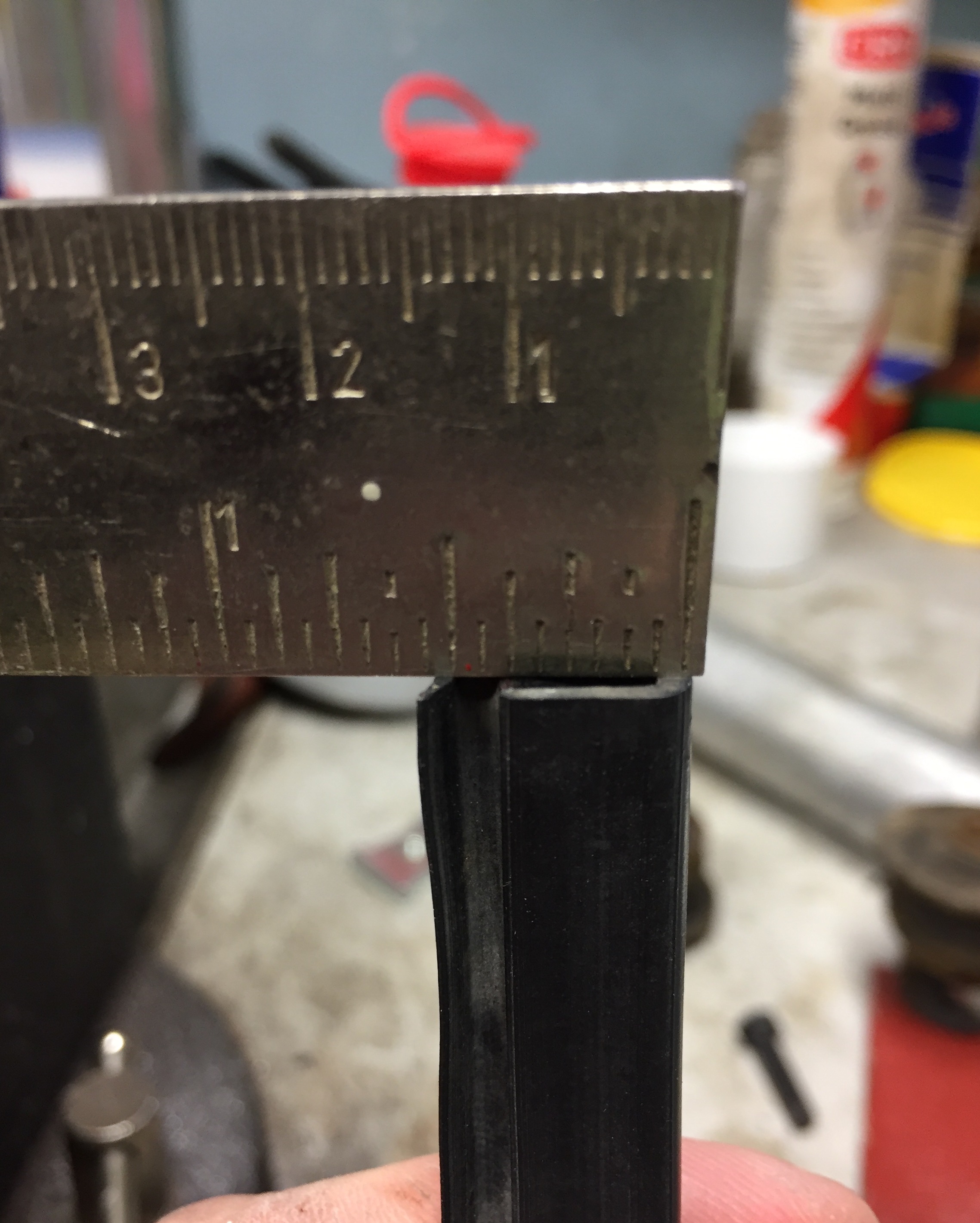

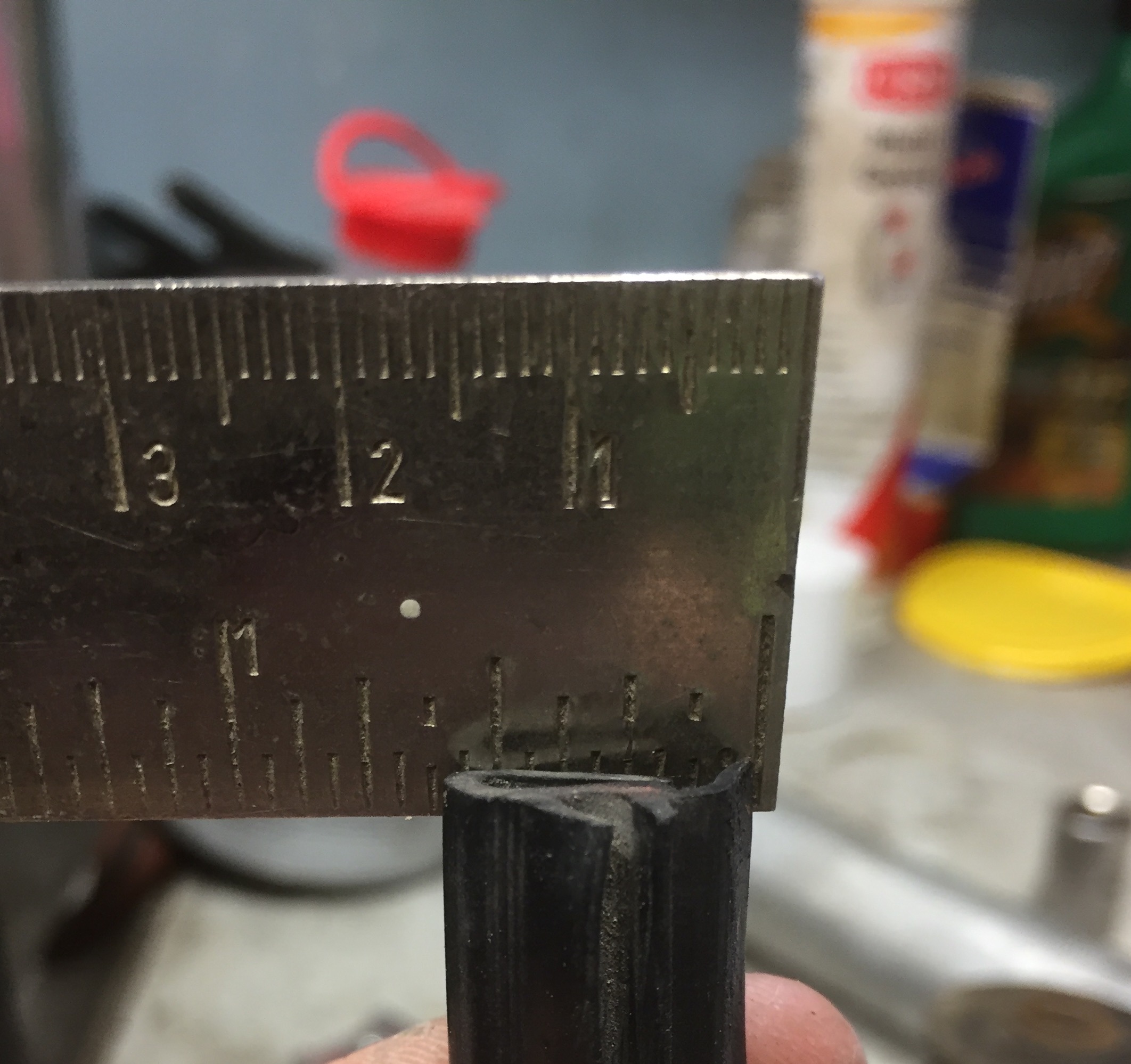

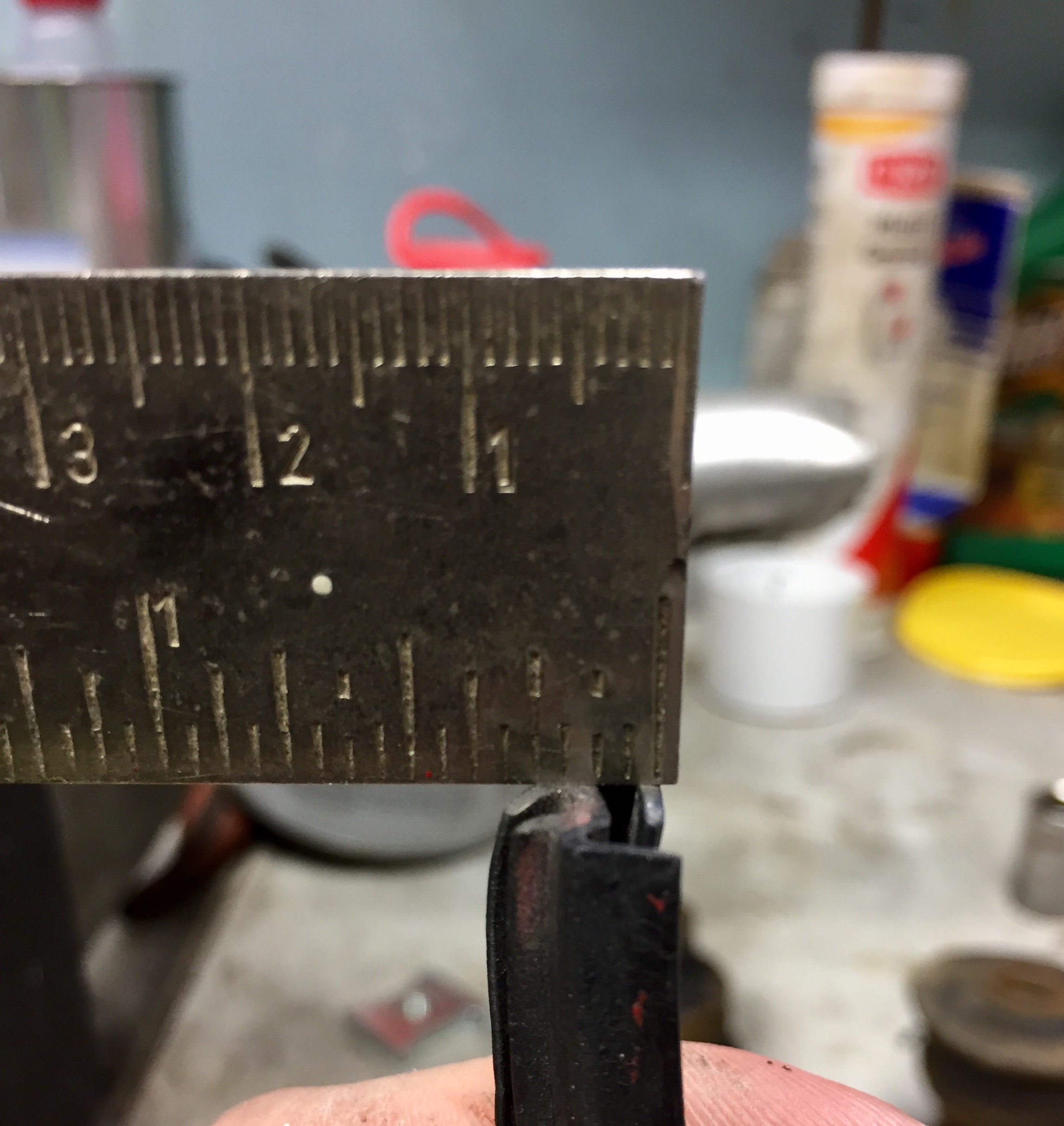

hopefully somebody can take a picture of the end piece of the gasket - with a ruler next to it - please. i will find something that will work and post it here for others in need. the ones on my coupe turned to powder when being removed.

deQ, they are wonderful descriptive pictures (as always) about the process ... it shows me a few good things about the seal ... but not enough to pick a stock profile out of a catalog that could work. i really need a pic of the end profile with a dimension on the longest side.

I went by the garage on my way home, not perfect pictures but I hope they are of some help.

That rubber appears to be extruded rather than molded. If it is extruded there are a fair amount of "rubber" companies that can make them at a more than reasonable price. The major expense is having the die made. IIRC the die is sort of a formed wire the rubber is pulled through. Years ago I did this to replace some NLA seals for E24s. The cost was, again IIRC, about $400 for the die. The rubber itself was a few $$ a foot. I had this done by some old guy in El Segundo, I can't remember the name of the company, that I found in the services section of Hemmings. Another place to look is Steele Rubber products in Minneapolis. They have a great catalogue of molded and extruded seals and by the foot rubber shapes.. They may even agree to make them.
