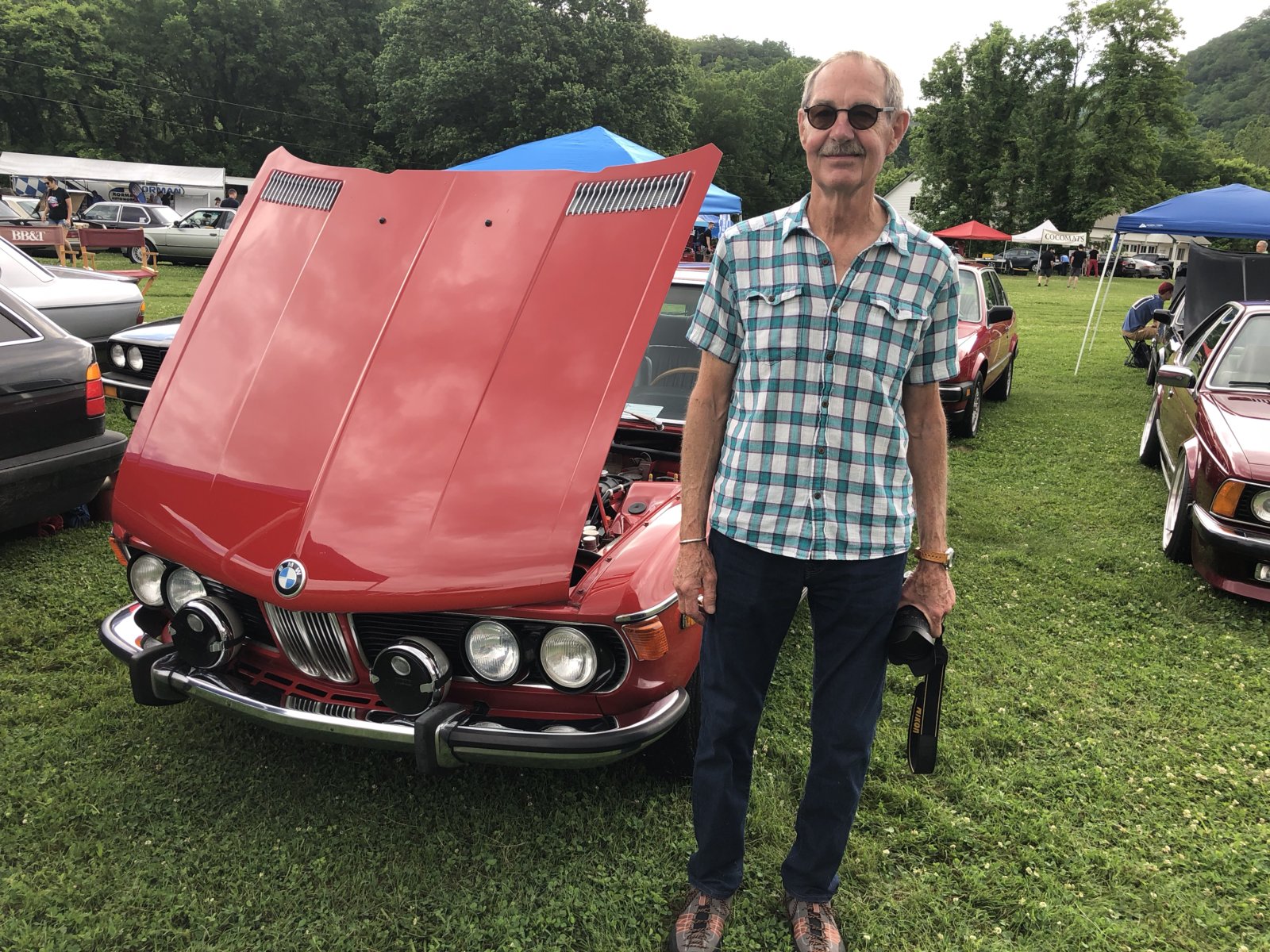

    Jim Van Orsdol's Verona 1973 Bavaria was absolutely stunning.
    Will Gran, original owner, made it this year with zero problems.

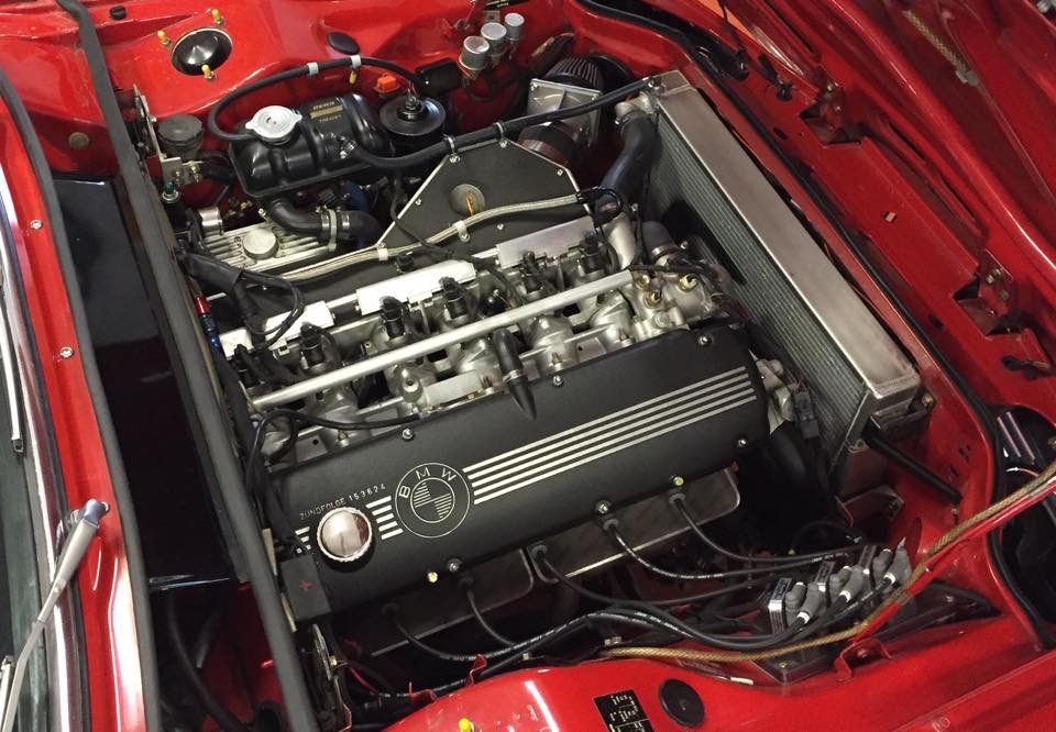

    Here's one. Thanks, Andrew, for the nice comment.

    Wow there is a lot going on in that engine bay that I want to learn more about.

    Hi Marcos,
    "What the heck is that" is a common query...;)
    I'd be happy to answer any questions or provide a brief description of components.
    Thanks,
    Jim

    1. Engine management system?
    2. Are you running wasted spark or sequential ignition?
    3. What ITB’s are those and what manifold?
    4. Did you make the airbox?
    5. What is that aluminum box where your booster typically is?
    Edit: A couple of other things:
    6. What ignition coil(s) are you using?
    7. Anything special about your rear battery setup?
  12. e3mt
    e3mt New Member
    Messages:
    4
    Likes Received:
    0
    Trophy Points:
    1
  13. JimV
    JimV Member Site Donor
    Messages:
    77
    Likes Received:
    17
    Trophy Points:
    8
    Location:
    Southeastern Wisconsin, Northeastern Indiana - sma
    Electromotive. It initially ran on a MAP sensor, but there were issues related to its ability to adjust to altitude so it's now running on a mass air sensor. Uwe Schuettler, formerly of E'motive, helped with program modifications.
    Wasted spark
    TWM ITBs (now Borla). The manifold is from Korman for DCOEs. I was planning on Webers and had this on the shelf.
    Made by a highly skilled fabricator at my friend, Scott's, tuning shop from cardboard templates. It's a work of art.
    The brake fluid reservoir for an electric accumulator which replaced the booster. Made by www.abspowerbrake.com, it's a hot rod item. I'm extremely pleased with its performance.
    Electromotive
    It's an e36 loom including the firewall terminal. Otherwise pretty straightforward.
