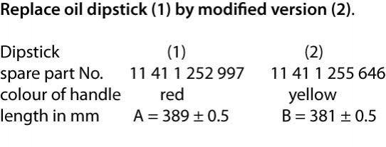

I think the problem started when the mechanic replaced the oil pump. The new pump is bigger causing the problem. The BMW book calls for a new dipstick (a yellow handle).
http://www.e9-driven.com/Public/Libr.../11410000.html

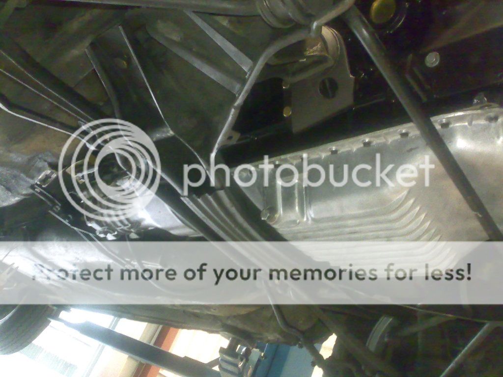

Oil Pan Pix
Let me know if you want a different view. When I insert the dipstick it hits something that sounds metallic.

Suggest
you modify the end of your dipstick to an approximate original point to enable the dipstick to be guided rather than forced.
After 40 years most anything is possible unless you know the engine's never been modified or changed. Since your previous post indicated a rebuild, perhaps you may know.
Your pan appears to be an interim version and not original, perhaps someone else can identify which?
I do suggest also you find your engine ID numbers which may reveal a clue.
i can not identify the oil pan, it seems odd to me
do you have access to the blue manuals ? there you can see the drawings of the internals in the oil pans, where you will see the plate modifications required
my thinking is that your oil pump was modified and probably the plate at the bottom of the oil pan wasn't
i can see a gap of nearly 20mm when you try to close the dipstick, andyou say a metallic interference, i do not think that you are interfering the hole in the oil pump plate (if that the case you probably had to have a gap of 40 to 50 mm
have you tried to insert the dipstick using different angle ? position ? (i.e. rotate the dipstick while inserting it ?
i assume that probably your interference is with the plate in the bottom, if that is the case you will probably need to open and remove the oil pan to check...

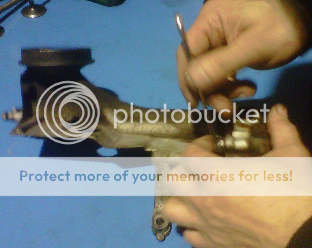

this is a nice pic, it is the new type of oil pump`
it is presented upside down but you can identify in the left side a big naked hole, through this hole it is supposed to pass the dipstick
in this particular case the cone-shaped centering plastic part is not installed in the hole, so i assume the you can have interference with the plate if your dipstick is bent

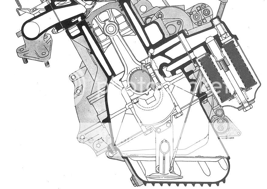

here check the section drawing of the engine to see how the dipstick goes, unfortunately the oil pump presented is the old type, without the plate:

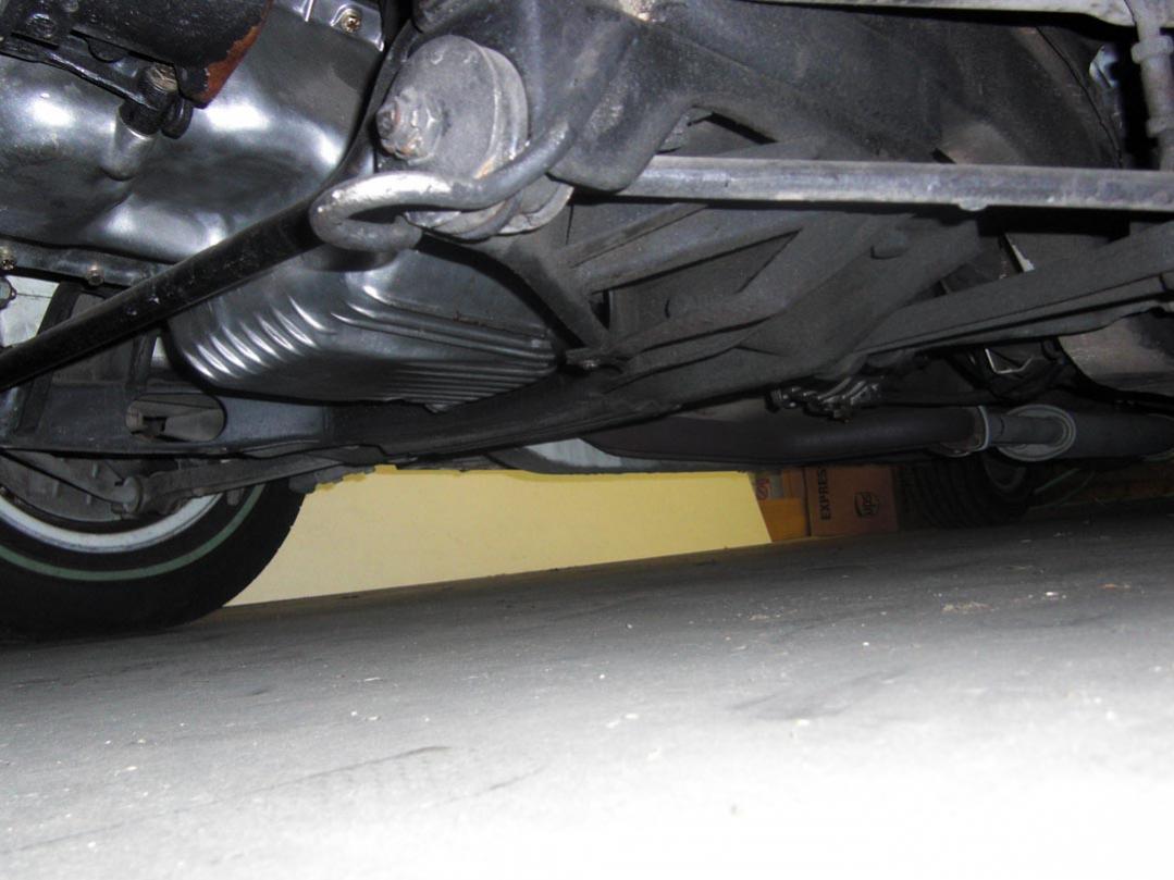

this is my oil pan with a yellow dipstick, can you tell a difference with yours ?
