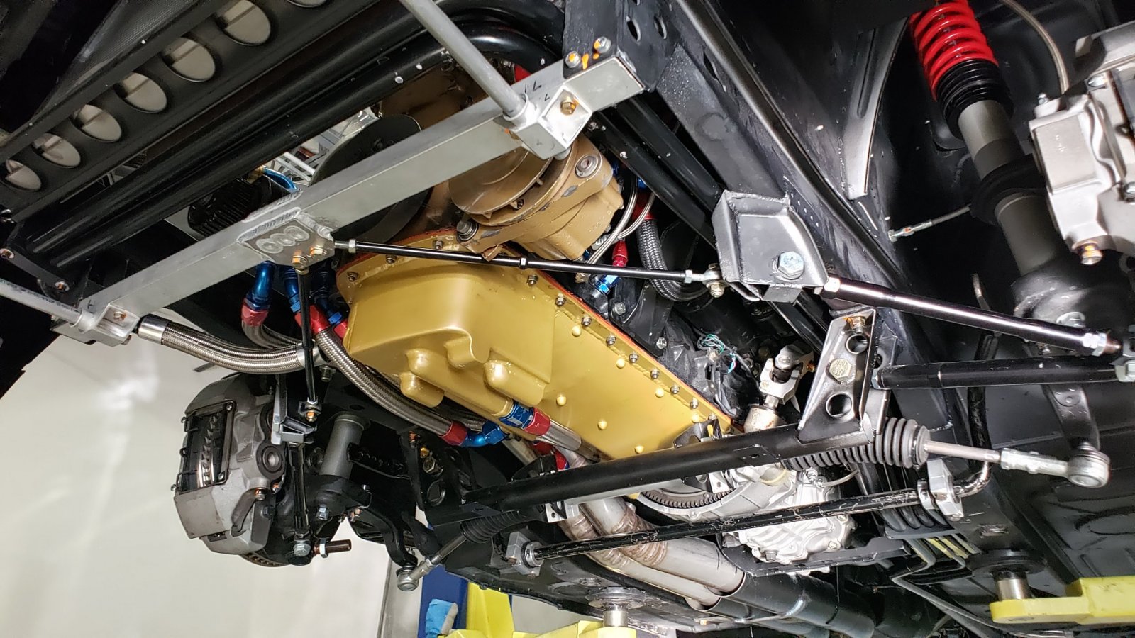

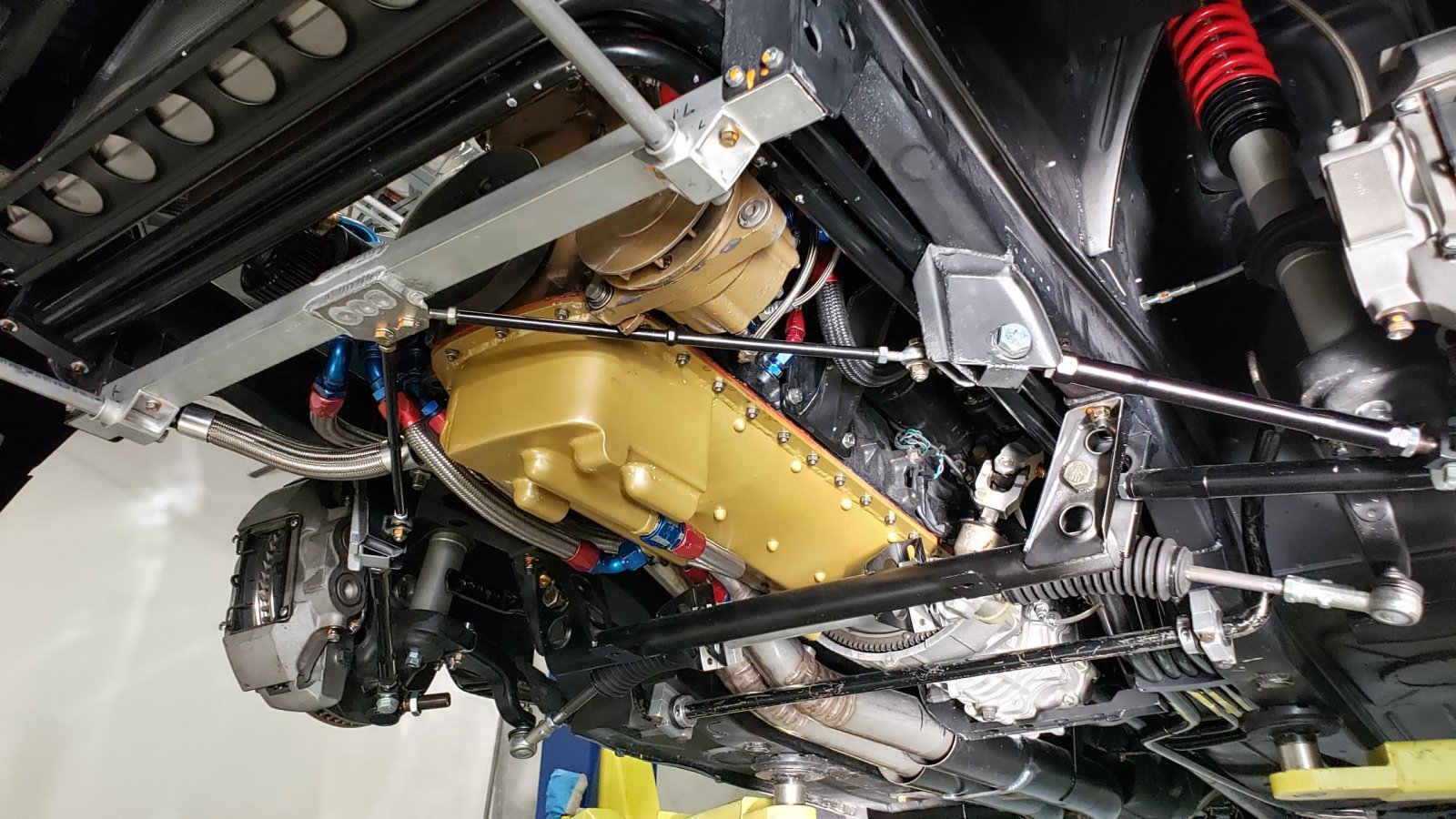

Here is #25 from a couple of shots at Turbo Hoses where they were working on it, the "new" #24 car he was building up there and the 320 turbo.
Snapped a few of the drive train for #24 that may show that trans anomaly?

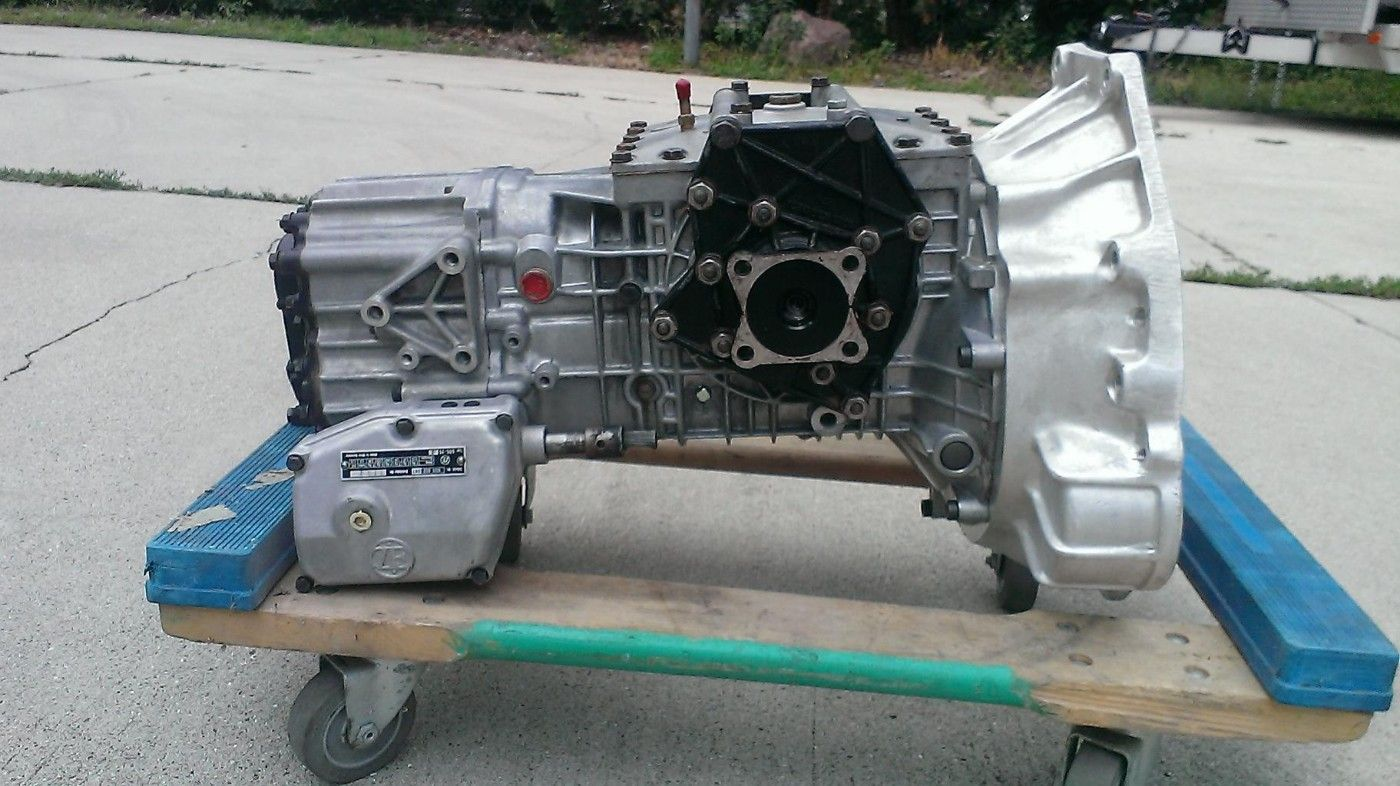

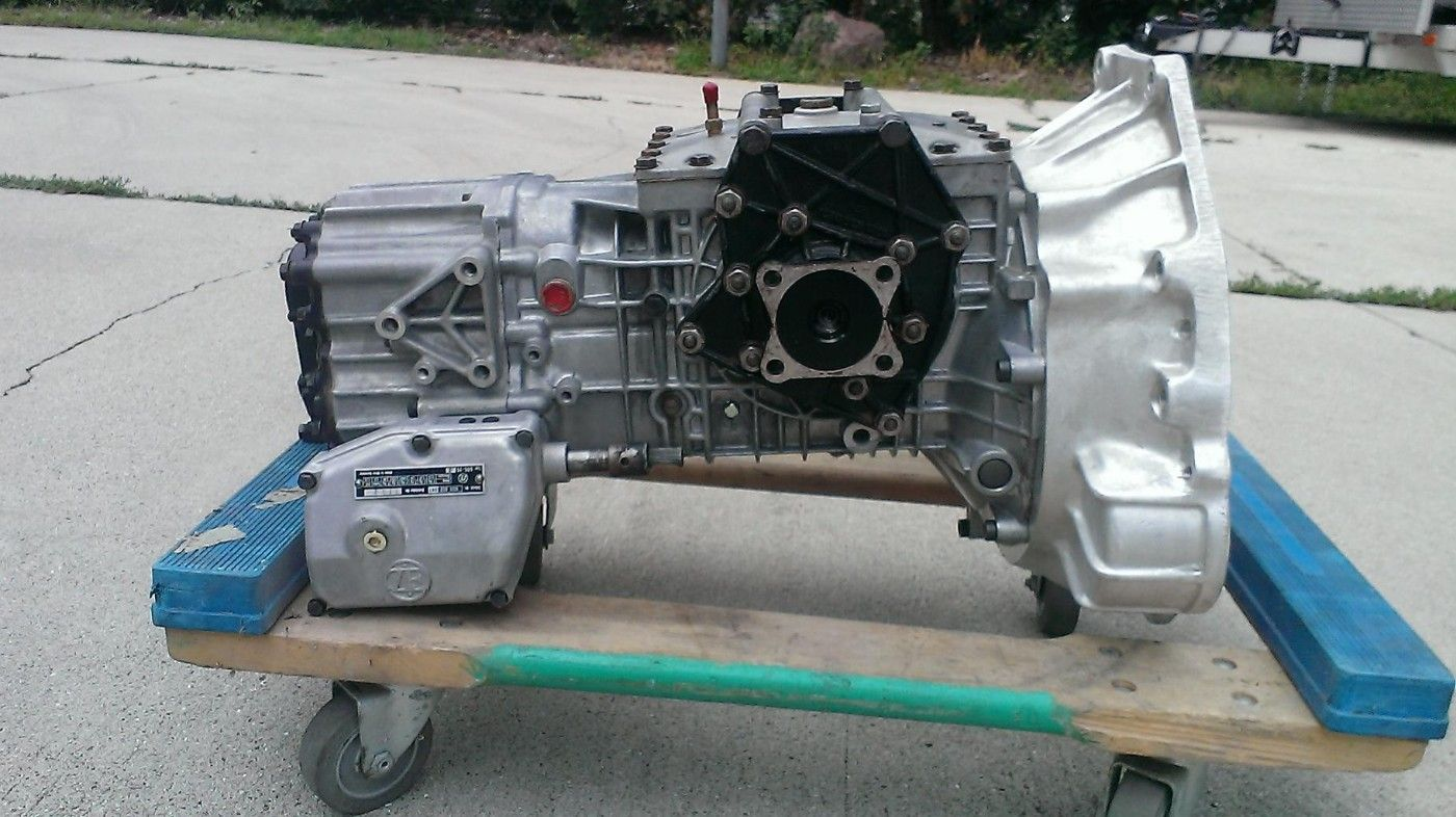

I really don't know much about this but I did find this. Shows how the engine would be mounted with the valve cover flat. Is that 90 degrees?
Transmission/ trans-axle in the M1 was via five-speed ZF DS25 gearbox, Fichtel & Sachs hydraulic twin-plate clutch and limited-slip differential.
Here's a photo of the trans-axle used in the M1 and I assume the DS25 trans.
Good pics. Lots of custom stuff under there. I don’t recognize the transmission case.

That's indeed the ZF transaxle as i had in my Pantera GT5S , but mounted upside down in those. Of course not relevant for a E9 with a engine in front and in my case mounted to a Cleveland V8. I remember it was the most expensive part in a Pantera..... :)
( also used in the Ford GT40 and some single seater race cars )
