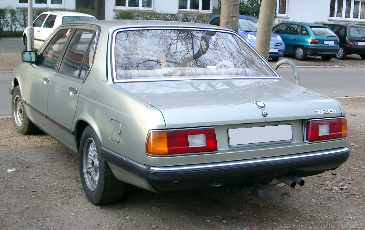

Why not? There is such a car as the 725i & 728i ......just look at the picture (728)

Makes sense to post a picture....3.0 seems to be the minimum for that model.
