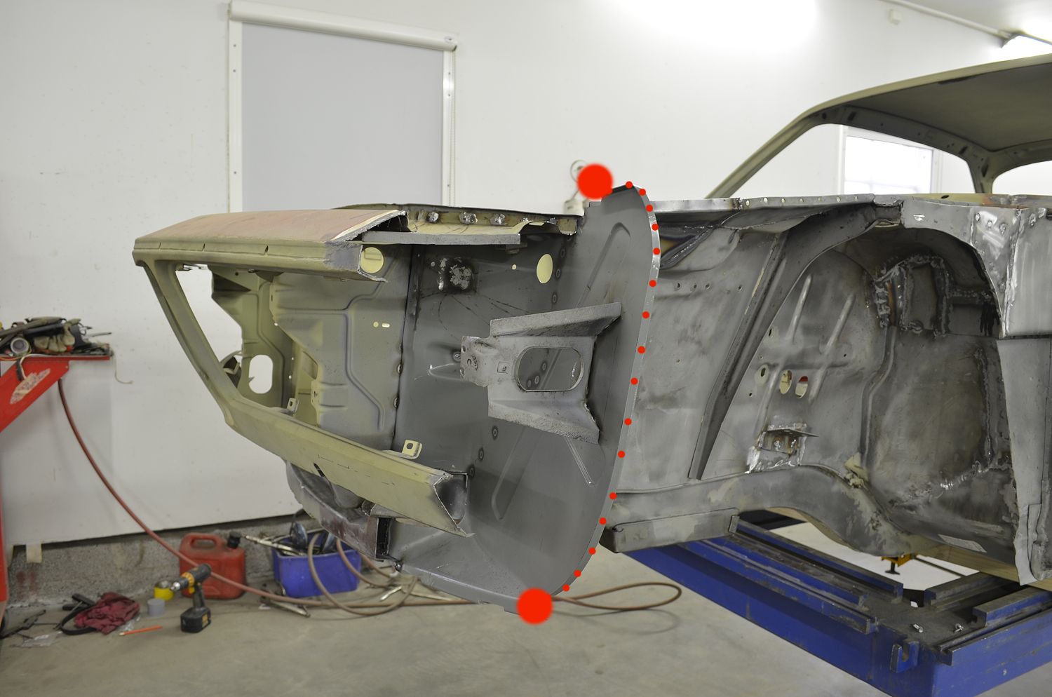

Hi everyone,
Is there supposed to be a rubber seal between the vertical edge of the front bulkhead (flat inner part of the nose) and the outer fender? Thanks.
Leonard
'70 2800CS Bristol

Leonard,
Are you referring to the vertical seal on the lower part of the outer fender, visible from inside the fender well (leading edge of tire)? If so, I would say yes. There was a discussion about it a month or two ago as well. It looks like the same seal that is on the upper area of the outer fender, up near the "fender box" (trailing edge of tire). It's kind of similar to your typical rubber door edging, but not as thick.

Hi Leonard, do you mean here? If so, I would say yes there is supposed to be a seal there. At least I put one there, bought from W&N but not sure if they offer it anymore, didn't find it right now when I looked, but maybe with more searching.

right, i was looking at that also
i just used a regular "V" profile seal to protect the edge.
its shown in 41-4
but nla

Thanks everyone for the quick reply. It is the gasket that goes in the place marked on Robert's photo. I don't see it listed on W+N as available. I guess the search begins for a generic replacement.

so what have you all done with the area where the red dots are in the post above ?
