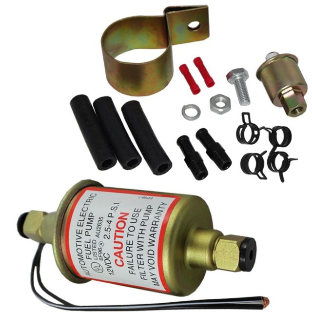

I have weber downdrafts right now on my '74. The engine, however is a later model with no mech fuel pump provision. I'm currently using an electric pump like this:
