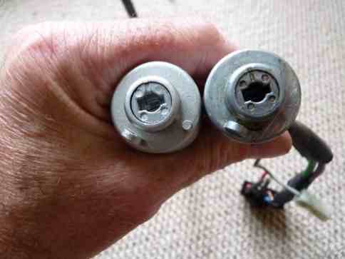

From what I can tell the e21 switch has a small locating pin sticking out of the back of it that locates into the key part of the steering lock, the e9 switch doesn't appear to have this. the old switch on my car has had what looks like this pin filed off, so I'm guessing my old broken switch may be an e21 switch anyway

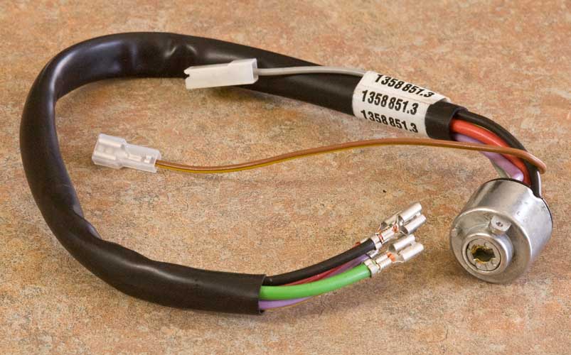

Ok, here's the low down on ign switches.
Ordered a new e21 ign switch from Penske, a it is a perfect match for the e9 switch except for the wiring and a small metal pin protruding from the face, clipped off the pin and filed it flat, re did the wiring to suit the car (in my case I have a Toyota plug on this as the original was stuffed) re inserted and did the little grub screw up, a perfect fit and it all works fine. With a little work it's a saving of about $110.00
New switch on the left with pin that needs removing (you can see the old switch has had this pin removed as well)

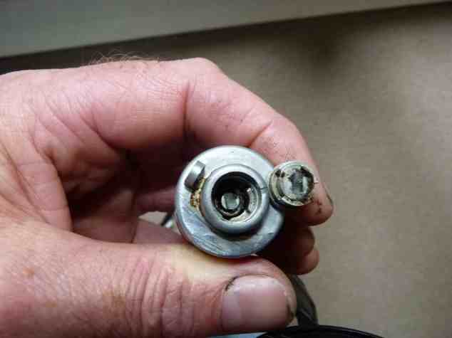

Old switch, the centre piece of this has snapped off down inside the switch, cheap muck metal.
