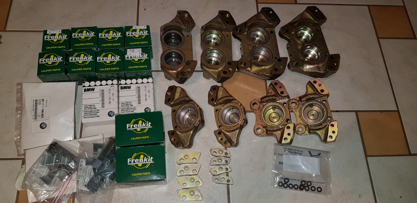

ATE still supply seals & membranes, if you make purchase via BMW you will receive ATE.
Last week i made my calipers rebuild & i had both sets of seals & membranes from ATE. Just aftermarket Frenkit pistons.
OEM:
front 34 11 1 158 692
rear 34 21 1 103 482
