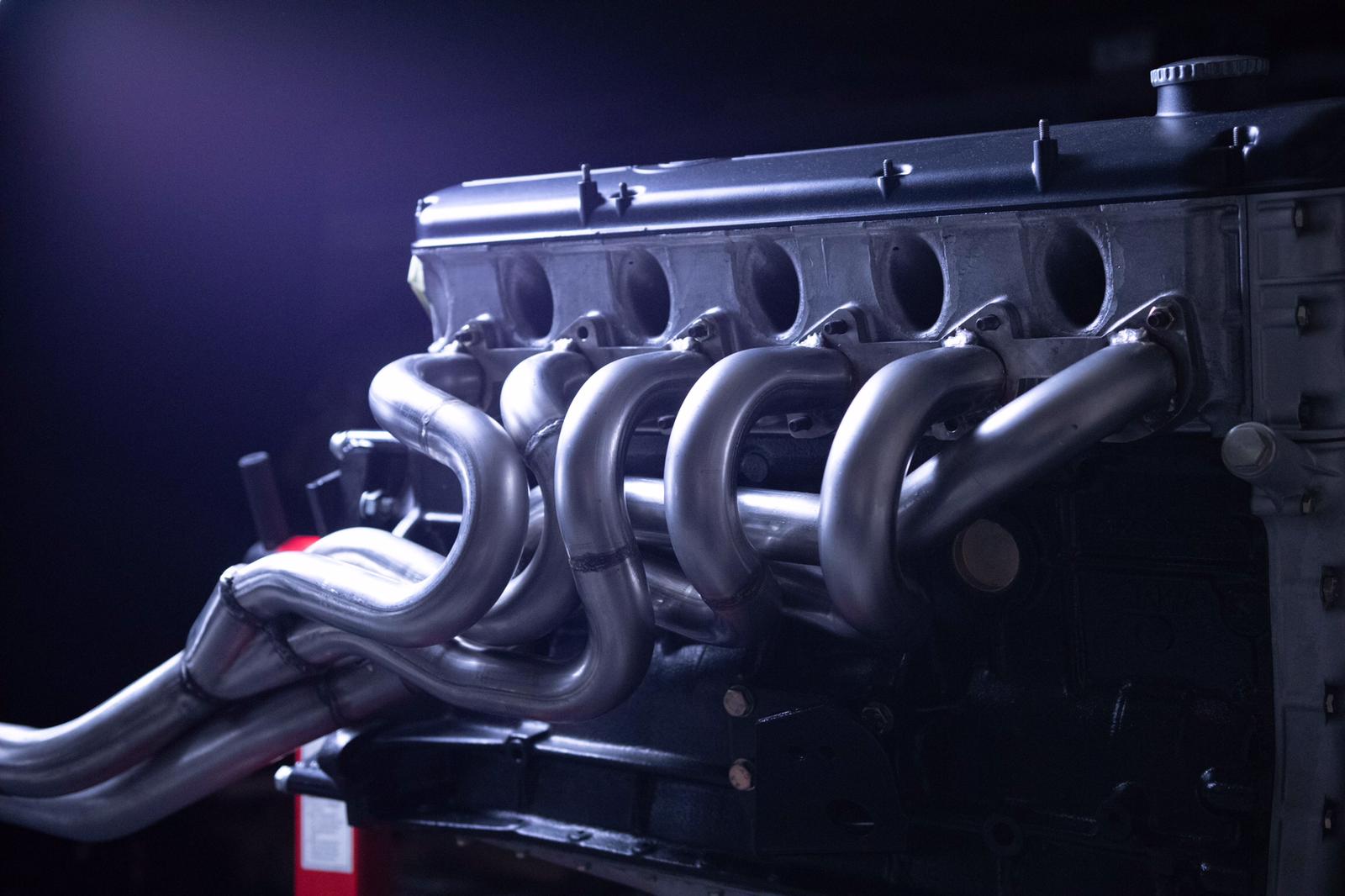

I really like the headers that @JamesE30 out on his Alpina motor. I think they are made by Classic Exhaust but he can confirm. It is a german company that advertises on Kleinanzeigen.
Given that they are motorsport style I would imagine that they get pretty close to the frame rail.
