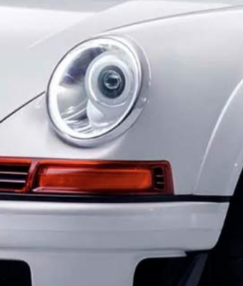

I guess nobody has changed headlights similar to those clear led headlights like in Singer Porsches? Haven't seen any, but would be interested..

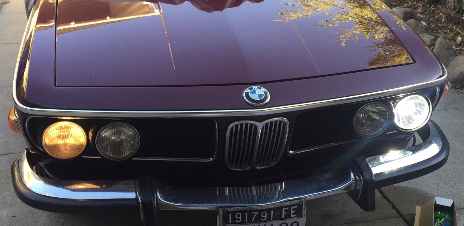

I have Hella reflectors and high end LED bulbs the have the leds placed exactly where the incandescent filament is so the cutoff pattern is great.
