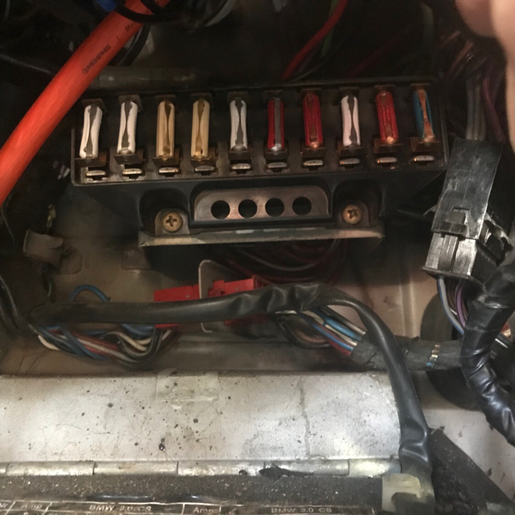

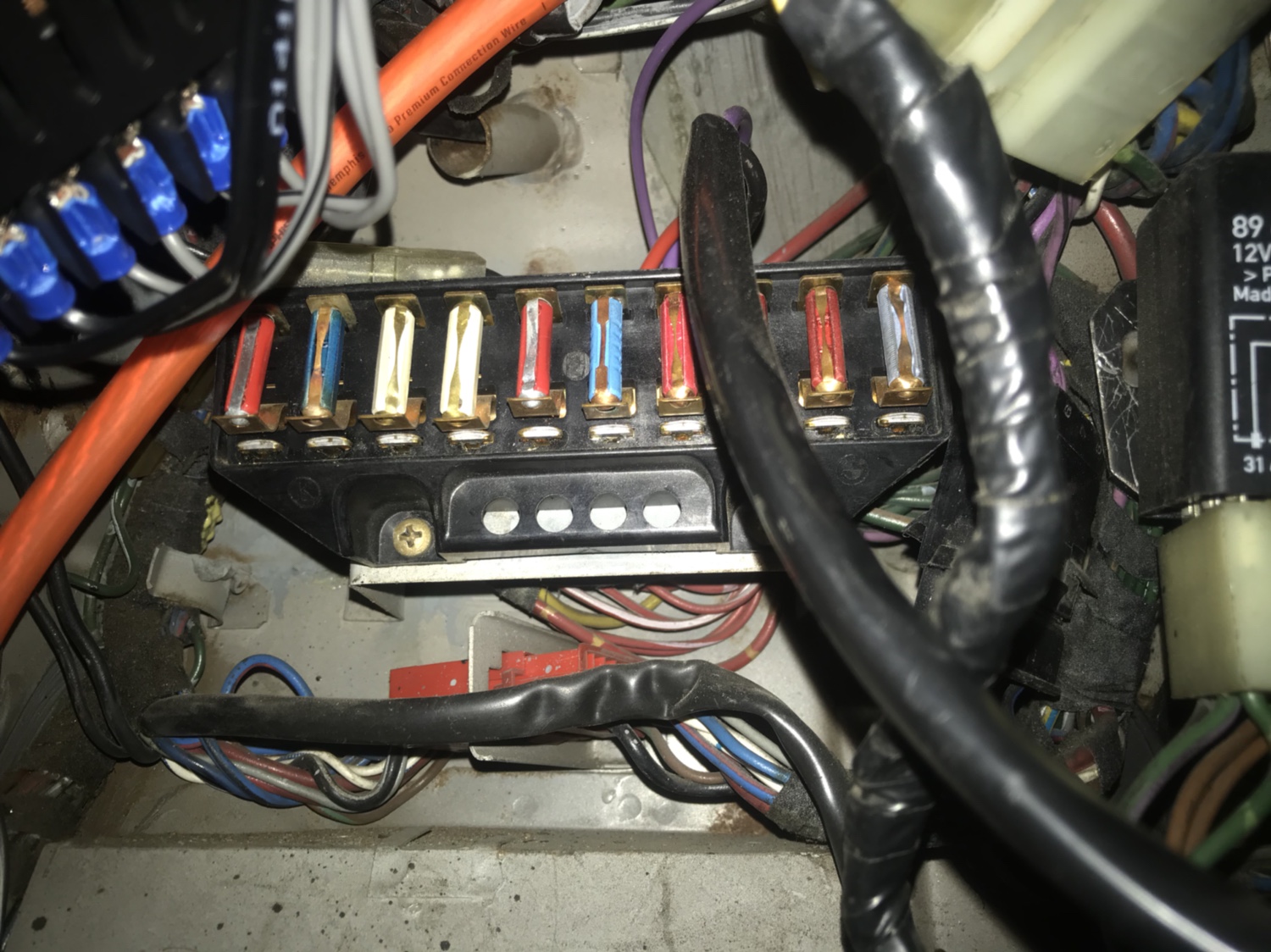

OK, so I looked at the fuses and from what I can tell none of them seem to be burnt out and according to the chart I can’t seem to locate the one that would apply to the windows specifically the passenger front window. Any thoughts would be appreciated. I am not terribly mechanically inclined. I am bringing the vehicle to San Francisco next month to have a lot of work done.

You have incorrect fuses in your fuse block. Compare to your fuse diagram in the second pic. Some of them allow too much amperage for the circuit. The first 5 should be white, then 2 red, then white, then red, then blue.

Unzip the shifter boot, push up the two passenger side switches. They have plugs underneath so you won't have to worry about switching wires. Also, check your fuses vs. the required amps on your sticker, yours are almost all wrong. You don't want 16A fuses where 8A are needed, same with 25A.

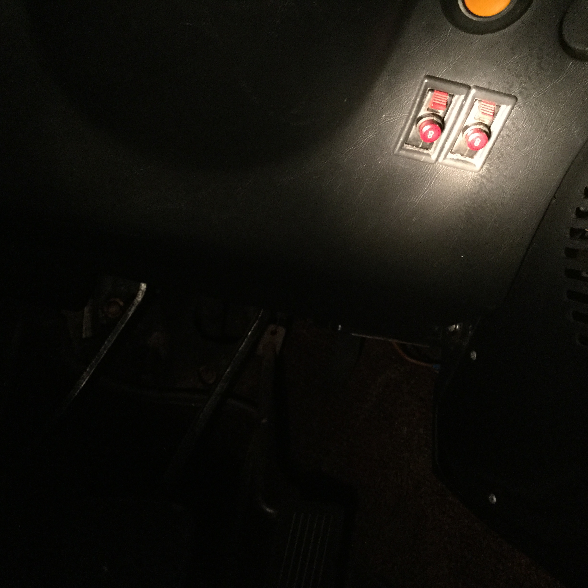

Scott, be SURE both those small circuit breakers below the switch area pushed in and 'clicked' in place. Also, I FULLY agree with several previous posts - get the correct fuses in that fuse box. A fire or serious wiring failure can result from higher fuse current rating than the wiring is capable of carrying.

fixed! I feel like an idiot. The two red buttons to the right of the steering column don’t seem to stay depressed you can only depressed them and they pop out and pressing them did not help at all with the window. Going to try to see if it is the switch although the food does not seem to come out that readily. I will continue working on it. Thank you so much. I have only changed a couple of these fuses over the years and was sure to make the right color fit which leads me to believe the wrong fuses were in it from the day I bought it seven years ago or so

Gary, these do not click at all. It just push in and out at no matter how hard I push them. Should they click into place? Are there any fuses associated with these that I should be concerned with? Thanks for your help

If the circuit breakers do not push in and stay then all windows will not work, one is for left and the other the right side I believe. There are no other window motor fuses, I think they get power from fuse ten, the blue 25a one, same as heater blower. Does heater blower work?

Well, since all other windows work, I assume they are "pushed in" but no matter how many times I try to push, they just keep spring back. The heater blew the other day, so I assume that's fine.

That is normal, push the little lever to 'trip' them then push in to reset. They pop way out when tripped. Swap the switches, it's super easy.
