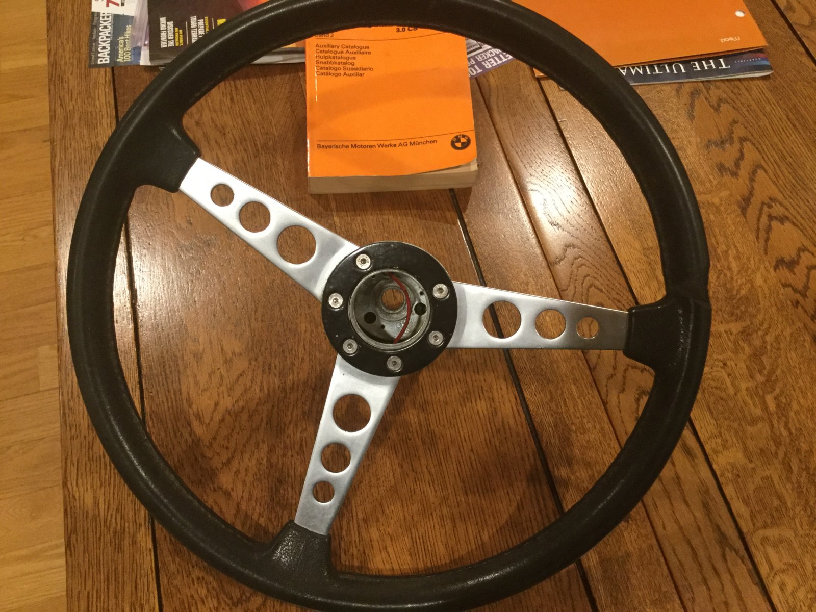

Look what showed up at my place today from a good friend up North. I will be needing a hub cover and horn button. Petri is a 40 which I will recover.

Hi Chris,
Glad you have joined the Petri party. Replied to your PM. Your best bet is to get the coupeguy hub cover and look to German eBay for the genuine Petri horn button. Have you checked with fellow members Keshav and John P? They maybe able to help you. You can also fit a standard MOMO button with slight modifications.

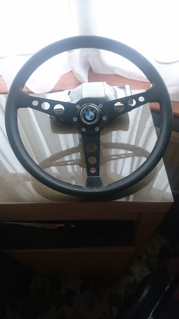

Markos you are the man! We are so close to the enigma of petri:confused:
I also have the same hub & cover as yours Teahead, but to be true i don't care about it, because it genuine bmw, era correct & fit perfect; my car will be not 100% original anyway (getrag 265, w&n stainless exhaust, w&n radiator etc, etc.).
Notice the holes all around on my hub.

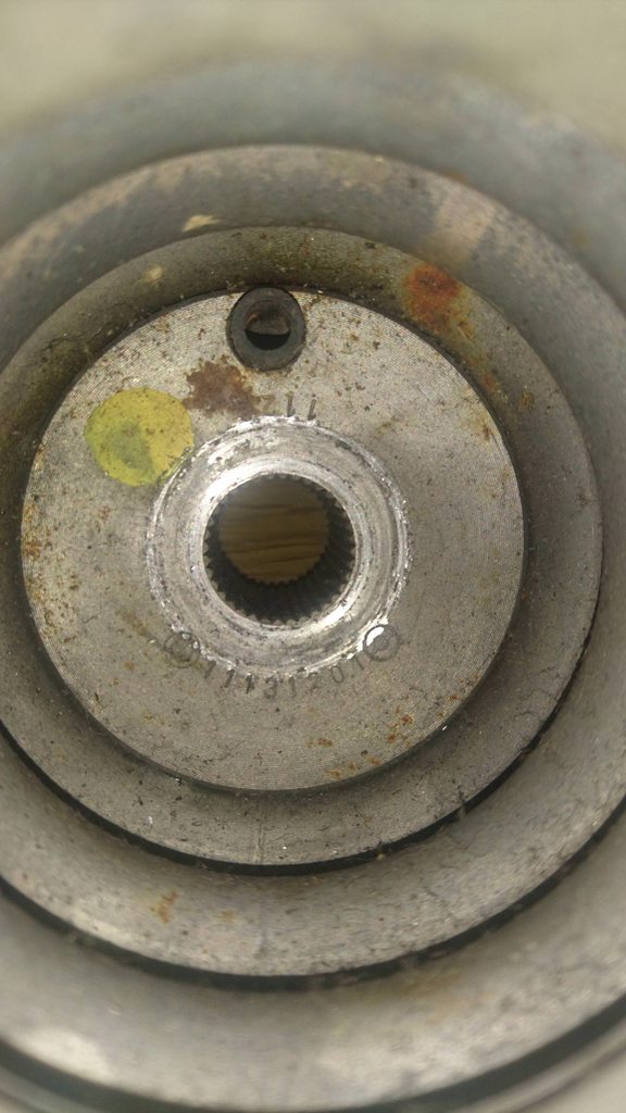

My petri hub ends in 201, must I now live in exile? I too could also do with a hub cover if Chris sorts one out first

Painted, the nickel finish was a bit too far g0ne for me. Also have the original bolts tucked up somewhere.

Damn if that makes six! This is fun though. The thing about realoem is that you can always get to the part from the part number, but you can’t always get to the part number from the diagrams. Sometimes they blatantly exclude the part from the legend even though the diagram an arrow and a legend number, and sometimes they just don’t show it at all in the diagram or the legend.
This hub supersedes the hub ending in 738. That makes six distinct hubs. I’ll update my post.
