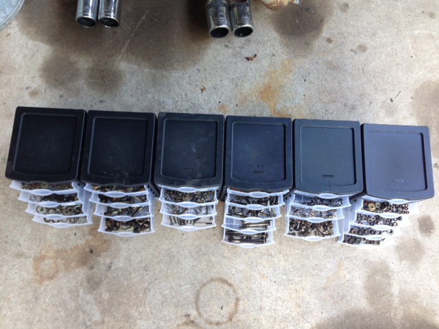

Rob, I just read your article in the new Roundel Weekly and boy am I glad I did. I was familiar with this thread so I had a feeling I knew what was coming. I didn't. Great read and as an added bonus, between spending a few hours last weekend sorting boxes upon boxes of BMW hardware, and the tips and watchouts outlined in your article I think we have effectively cut the install time in half!
