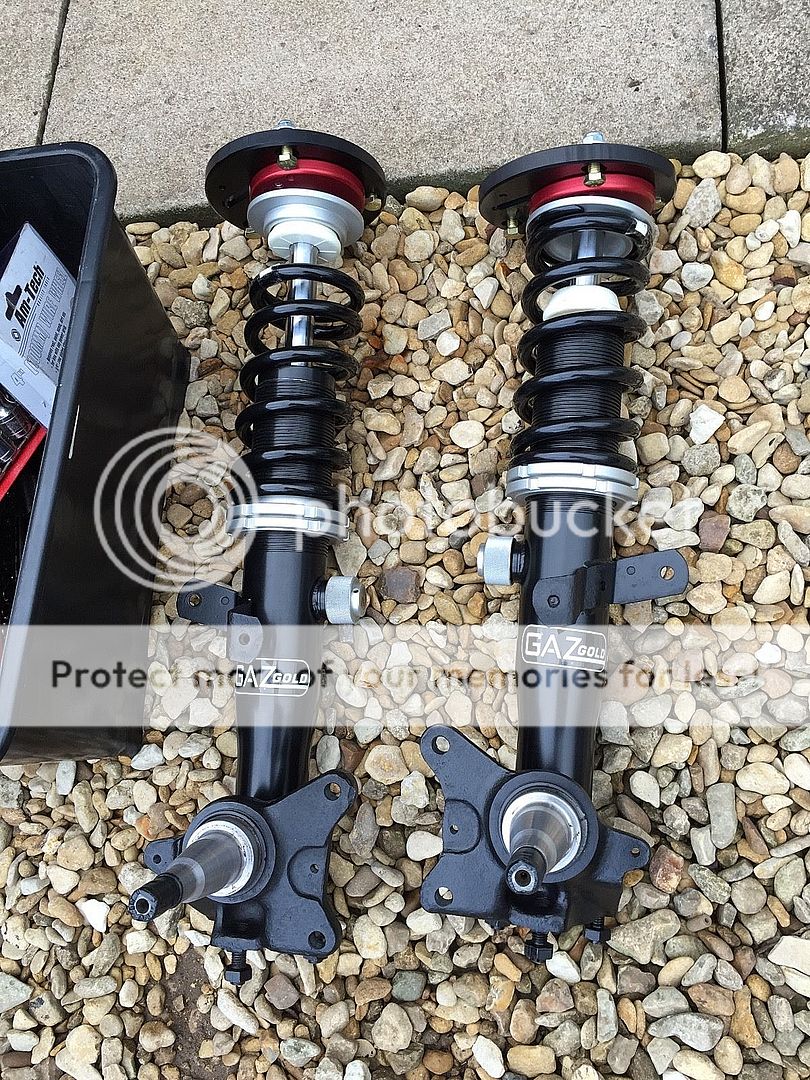

This might not be directly relevant to this thread, but I just wanted to share the information.
I've been in contact with Gaz Shocks in the UK about a coilover setup for our coupes, and they can manufacture a set if you ship them a pair of front struts.
I would be surprised if they couldn't offer progressive springs for the setup if the customer would want that.
I understand that this might not be for everyone but for those interested, here is what they answered:
Good Morning Robert,
Yes we can manufacture a Gaz Gold kit for the BMW E9 we will need some donor front struts sent in for the new kit as we re-use the cast stub axles for the new front dampers.
The kit comes complete with springs and height adjusters for the rear and costs £850 + carriage & VAT, we can supply top mounts as well if requested these are an additional £100 per pair + VAT.
Should you wish to place an order I will need your full details for invoicing, once ordered and paid for your new kit will take 3-4 weeks to manufacture.
Kind Regards,
Gaz Shocks
A picture of the front coilovers:

The image is of two coilovers with 1-way adjustable rebound from Koni shocks. The term that you are referring to is associated with the shock, not the rest of the coilover. Three way adjustable shocks typically have low and high speed compression as well as rebound control. I wouldn't even want to think about setting that stuff up myself. Quite overkill for a street car IMO. I think coilovers are for the most part also since you will set the ride height once and be done with it. They do have the advantage of smaller springs, which gives you a bit more room in the wheel well.
In general, coilovers themselves have adjustability that isn't included in the "three way adjustable" lingo. The spring height adjustment which is par for the course for any threaded coilover. The toe/camber stuff is just from the adjustable campber plates, which you can put on factory struts also. Other adjustments on coilovers can come from a setup that actually lets you adjust the shock/spring height, which can adjust ride height without changing the compression rate of the spring (these don't have that). There are no coilovers in the rear of this setup. I see rebound adjustable shocks with adjustable coil spacers, which do not go over the shock. The e9 already has weak rear upper shock mounts, so it's probably not a good idea to stick a coilover in the rear without reinforcement. You probably have to mount it upside down also since the spring may not fit in there.
Looks like a great setup to me!
