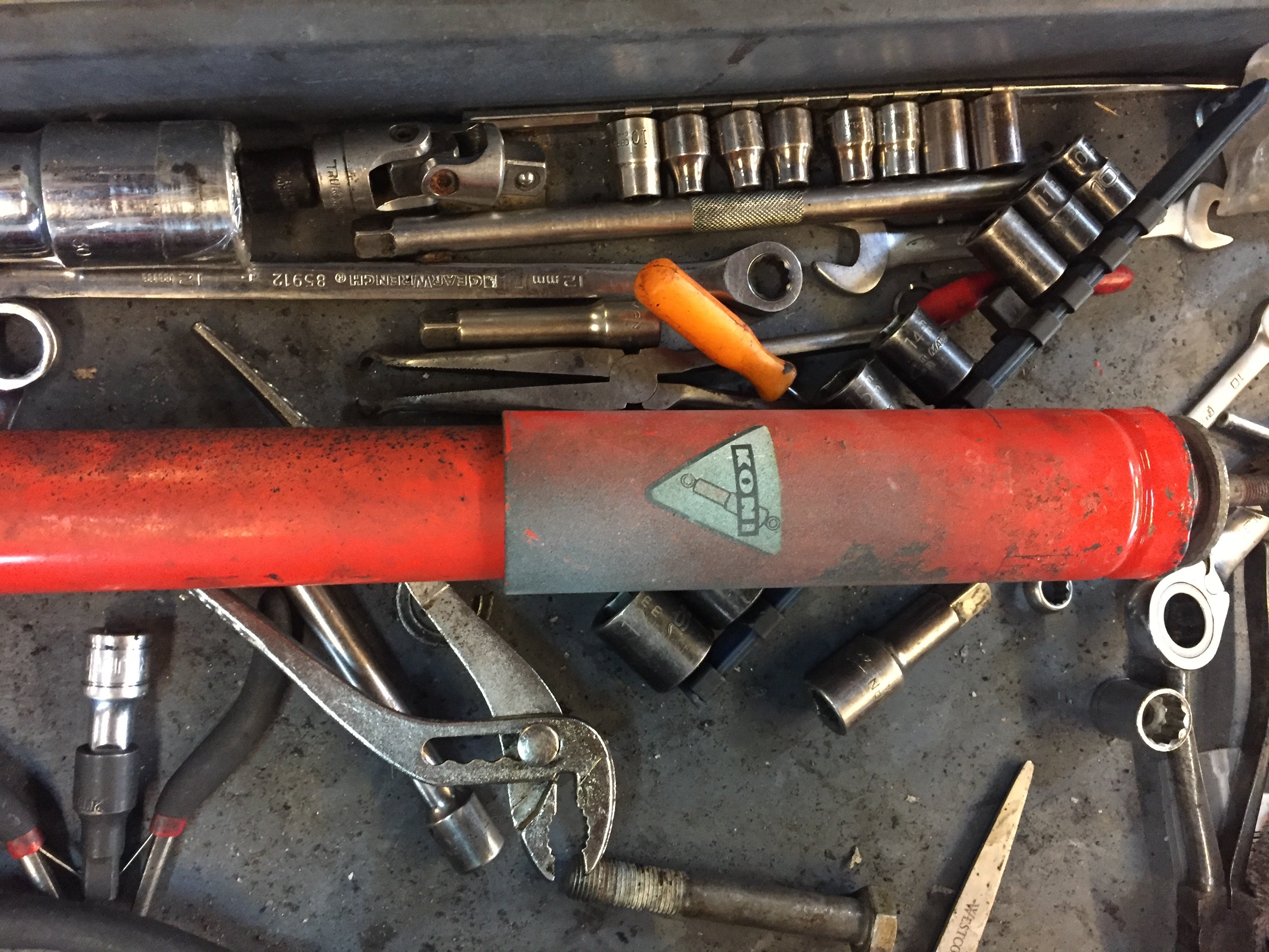

Some people remember the adjustable red shocks from Koni
