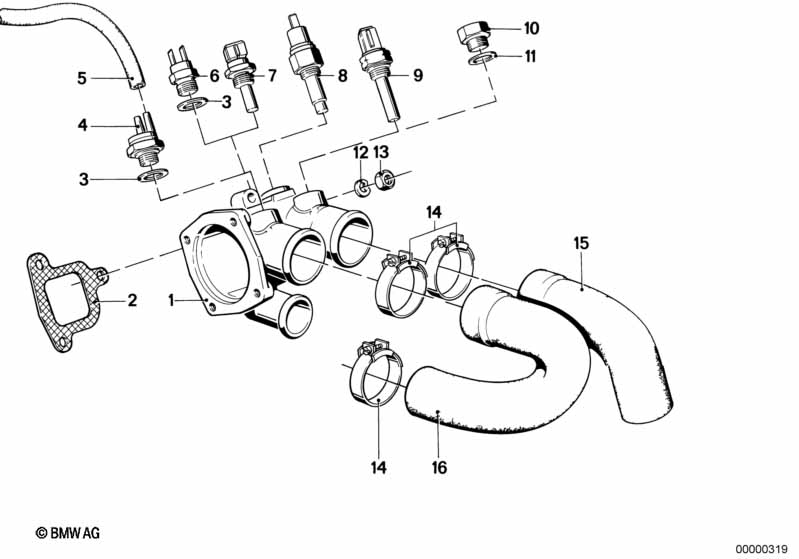

It's really simple. The BMW switch has 3 wires, one for each switch and a ground. The fan has 3 wires, one for each speed and a ground. The Volvo Relay has 3 plugs, one for the 12v power, one for the two switch inputs, and one for the two outputs. The switch in the ground leg of the temp switch turns the fan off. I use a Normally Open relay contact on the ignition circuit so the fan shuts off when I turn the key off.
Dear Mike.
To my inexpert eye it seems very odd to have an earth cable to the sensor and then two outputs, i am more prepared to see an +12v input and then the 2 outputs one for 91 and the other for 99
Could you please confirm ?
What am i missing ?

It is a switch, not a sensor. The switches are connected to a common wire on one side, so when each temperature limit is passed the associated switch closes and connects the input associated with it to the common wire. It would absolutely work with 12v on the common lead, but that's not what is needed in this case. In the Volvo link there is this schematic of the dual relay:
