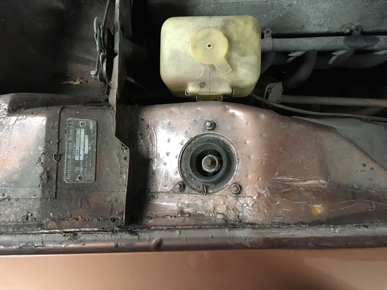

This is what's available for restoring now-a-days? What a mind-blower. Can those front fenders be removed and the inners replaced (from the firewall forward) and still save the paint? Hey, save the "patina" ;-)

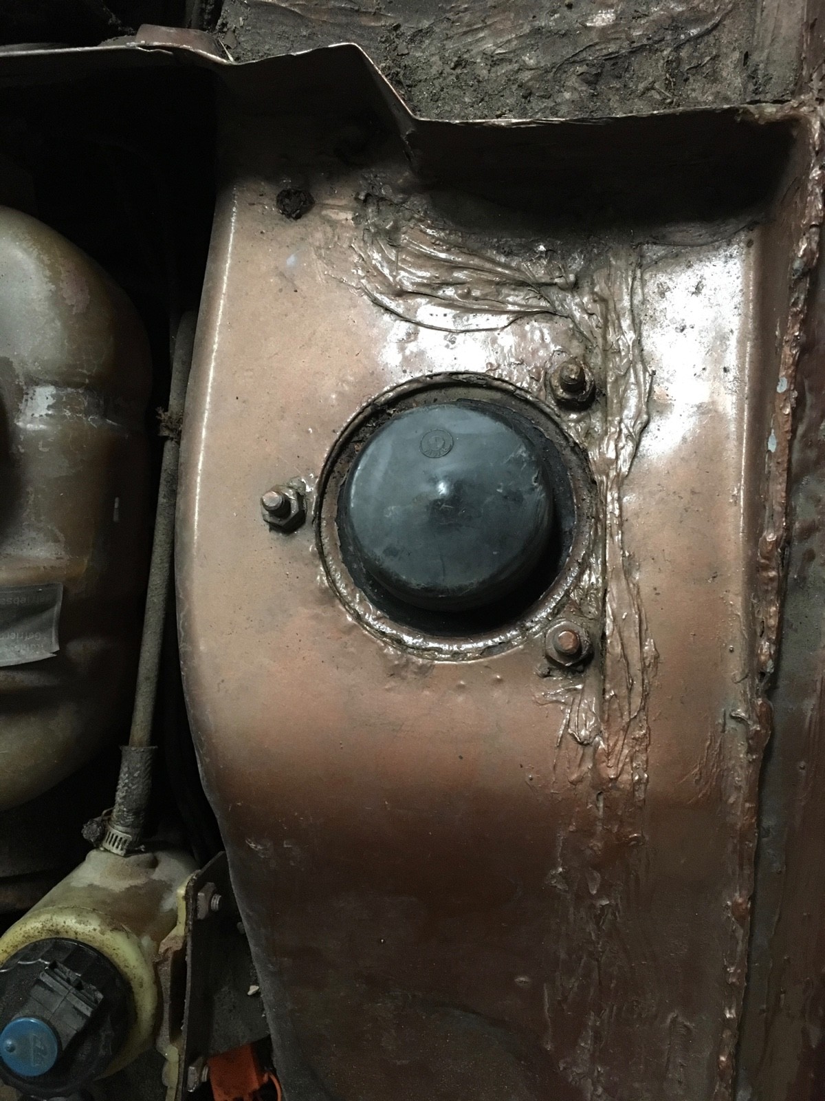

I don't see a lot of rot. Looks like just way too much seam sealer to me.

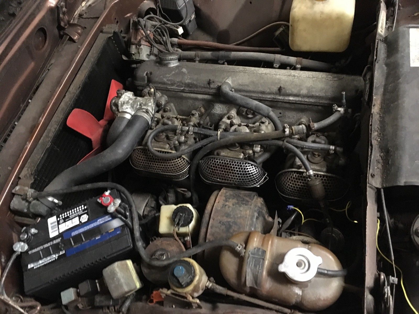

View attachment 56109 Does it have two brake fluid reservoirs?
Ha! certainly appears to be the case. Looks like the orgional reservoir is for the clutch and the “other” one has the fluid sensor wires attached leading me to believe that one is for the brakes. Pretty dumb if you ask me. One of the good point of the orgional setup is if one of your clutch cylinders is leaking you will get the low fluid brake warning light. In this setup no warning before you lose your clutch operation all together.
Nutty.

If it could be had for $25K or less just clean it up and drive it. My experience says once those outer fenders come off to tell the real truth (and the only real way to really know) its going to be a long, painful, expensive repair journey. Being a sunroof car adds to the liklihood - the bottom of the A pillars will likely be toast. I could be wrong but the quality of the fender repair makes me suspicious - I'm watching a lot of 80's/90's era shortcut repairs being removed and proper sheet metal welded in on my CSi. This is all conjecture of course, and I could be wrong, but I say the odds are there's a lot of rot issues forward of the firewall.
